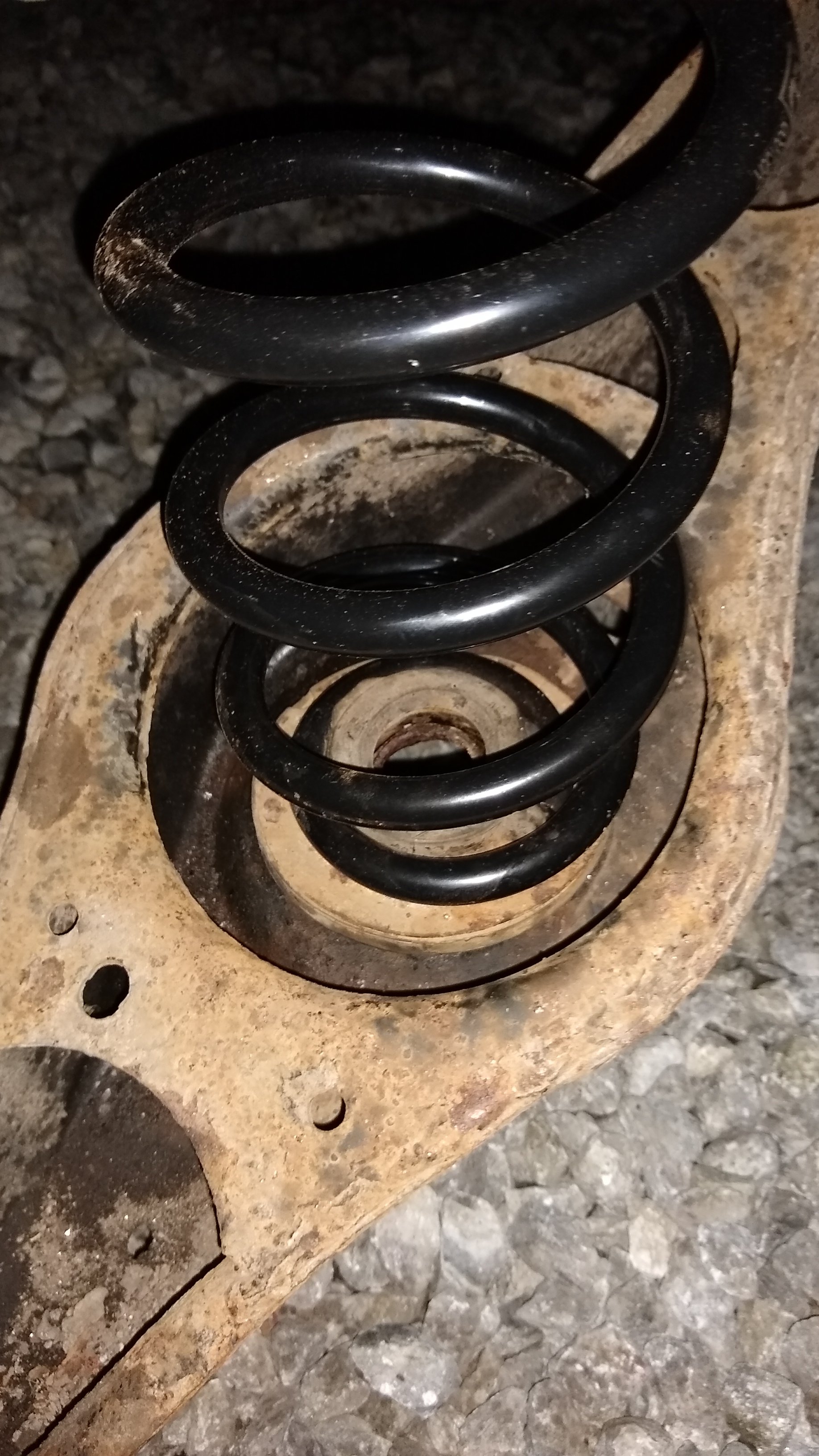

One of my coil springs broke and I decided to change it having read the historical briskoda threads and watching the videos. 15 minutes a side... What could go wrong!
In the video, the guy has about one inch to compress with the trolley jack to make the holes meet up on the control arm.
I have around 8/9 inches to compress. Should I be doing this with a trolley jack? That seems like a lot of compression. On the videos they are all pretty close to having the holes match up without any tension, so this seems a little odd to me.
I've included a pic as a reference point.

I have done mine and I don't remember having that much of a gap with the spring unloaded. Are you sure that you have the correct spring and that it is seated properly? Can you compare it with the one that you have taken off?
Edited by Liger1956
Spelling
I'm pretty sure it's the correct spring, as it looks identical when sitting side by side with the broken spring.
Also fairly certain it's seated correctly, although any advice is welcome.

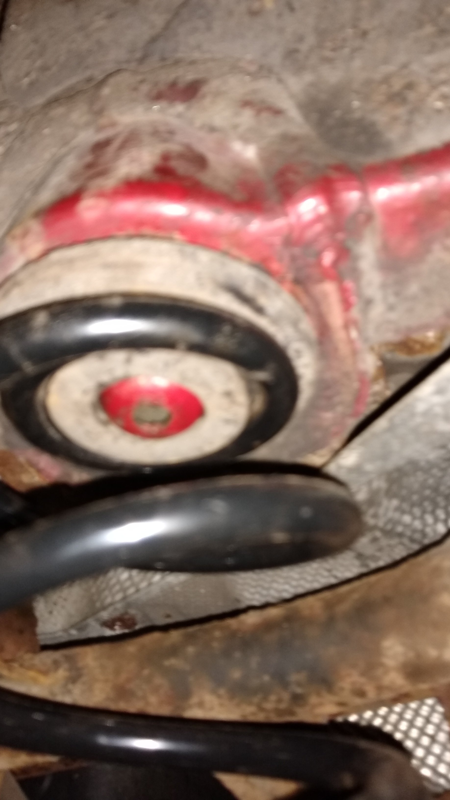

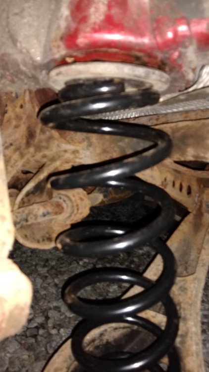

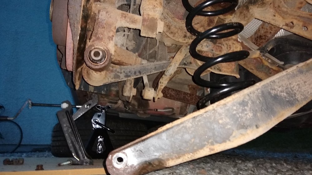

Another couple of pics to see if that will shed any light on matters...
You still have the shock absorber connected.
In fact when I have replaced mine I have not needed to disconnect the wishbone, just the shocker in order to lower the wishbone enough to remove the spring like in this video:
Your set up does look different, it should be the easiest job in the world.

I did not disconnect the shock absorber when I did mine just the wishbone bolt. The suspension design in the video is different to mine. I seem to remember having to slightly lever up the wishbone to get it onto the trolley Jack but the gap in the photo seems excessive if everything is correct. Have you tried jacking up the wishbone? If the holes line up before the car is raised off the side Jack by the spring pressure then I would think that it is OK. You can then try the other side and see how that goes.

The OP distance doesn't seem to different to this video:
When I did this I also used spring compressors to take most tension. My car was also higher as I needed access to remove the seized concentric bolts and suspension arms which made it easier to get a jack and block of wood under the spring mount during reassembly.
There is always a risk the spring can fly out but if it's properly seated, it should be OK... Just be mindful of where your fingers are compared to the spring!

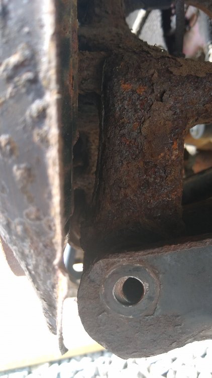

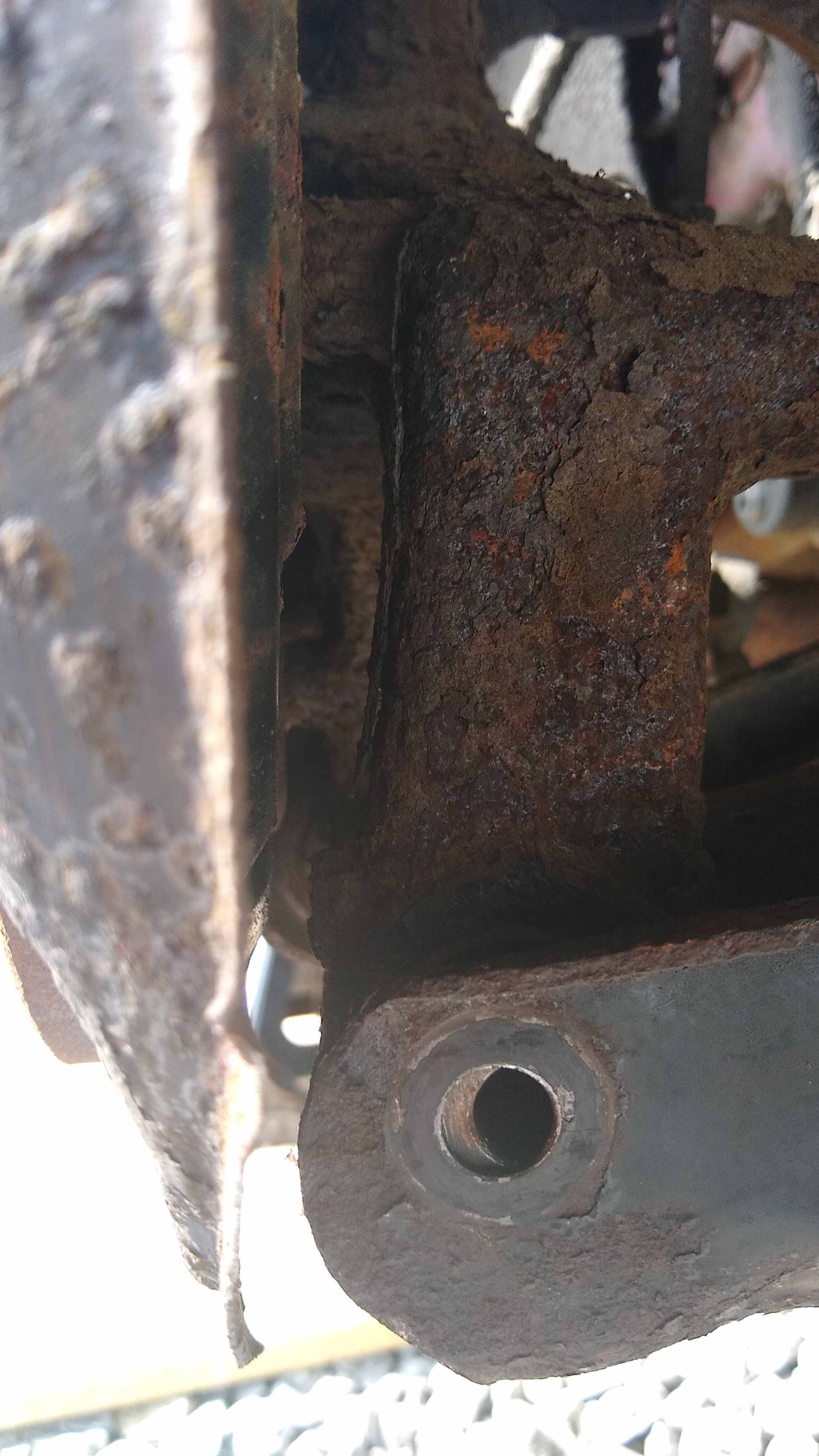

Fair enough, so I'll just reassemble it then...
At the moment, I cannot get these holes to line up. No amount of levering, hammering or swearing will get the arm to budge.
Any thoughts?
Pic below.
Pin punch will work quite well, alternatively a screw driver with a small bit of rag over the end so you dont damage the threads. However i never use ths rag and have had no problems
  • Sponsor
Is the car jacked up in one corner only? If so, levelling it may help?
I had something similar. If I remember correctly  in my case one side of the wishbone hole appeared to be inboard of the hole and the other was outwards so the wishbone was not in the correct place alongb the length of the car. Try moving the trolley Jack and/or the wishbone slightly towards the front or back of the car.
The spring should be fine when compressed in situ as it's held captive top and bottom.
I've never had a problem jacking the wishbone up to refit the bolt, just a little manipulation with a longish No.2 Philips in the bore to help align the holes, I attribute this to flex in the wishbone/bush.

Ok guys. Not a complete success, although I did manage to reassemble with the aid of leveling the car, using a screwdriver and wedging a stone in there. Needs must!
