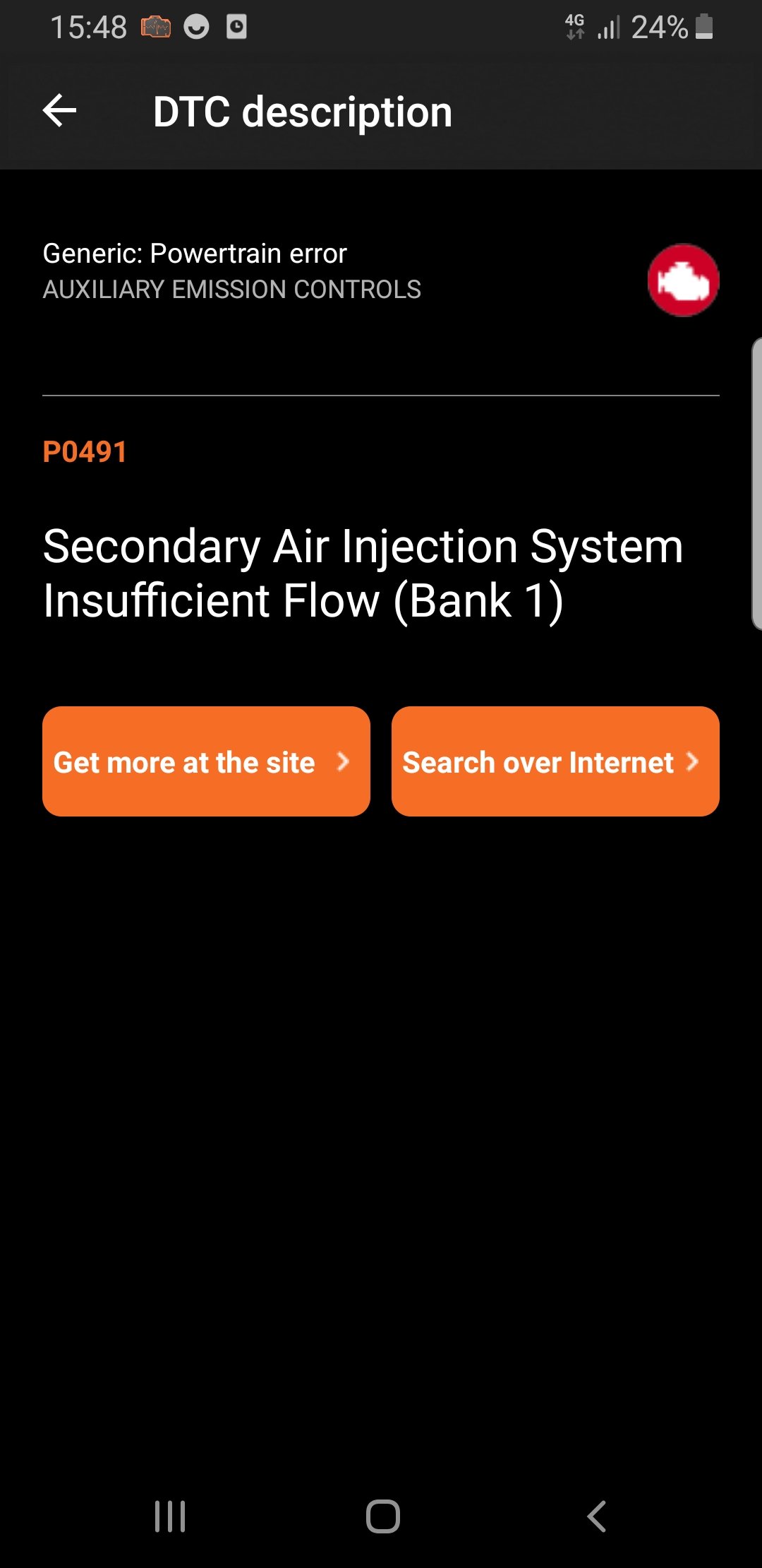

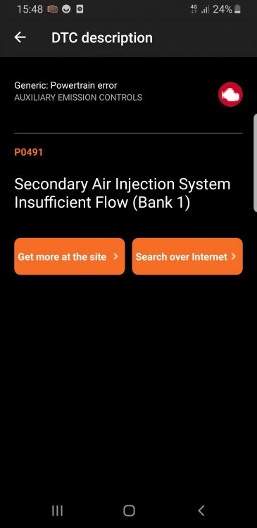

So this is what the garage has came up with any ideas
