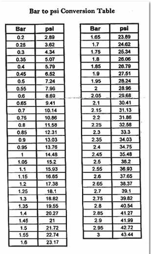

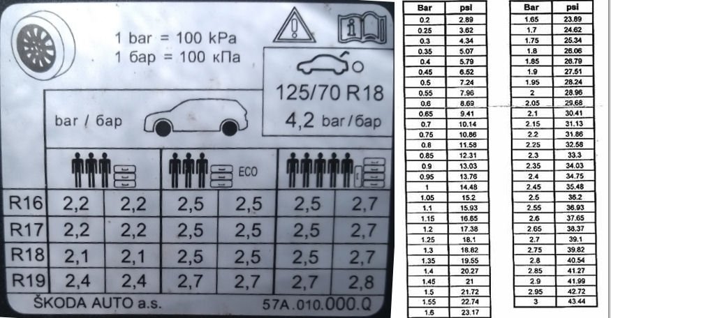

So I realised that a lot of people work in the new fangled "bar" scale so to help (mainly me when I come to look back at this) I have included my inflation sticker together with a handy psi to Bar conversion table.  See for my R18 tyres they are suggesting 2.1Bar (30.4psi) for normal.  That seems crazy low to me.  Even for ECO for the R18 they are suggesting only 2.5Bar (36.2psi) and for fully laden they are suggesting the same 2.5Bar.
Does anyone know what the 6ap figure is meant to be - I assume this is "atmospheric pressure" and I kind of assumed that 1BAR was 1 6ap at sea level??  the fully laden for my R18 is supposed to be 2.6 BAR and 2.7 "6ap".   Is this a special figure for high altitude locations???

Skoda suggest on the flap 2.1/2/1 normal and 2.5/2.5 ECO

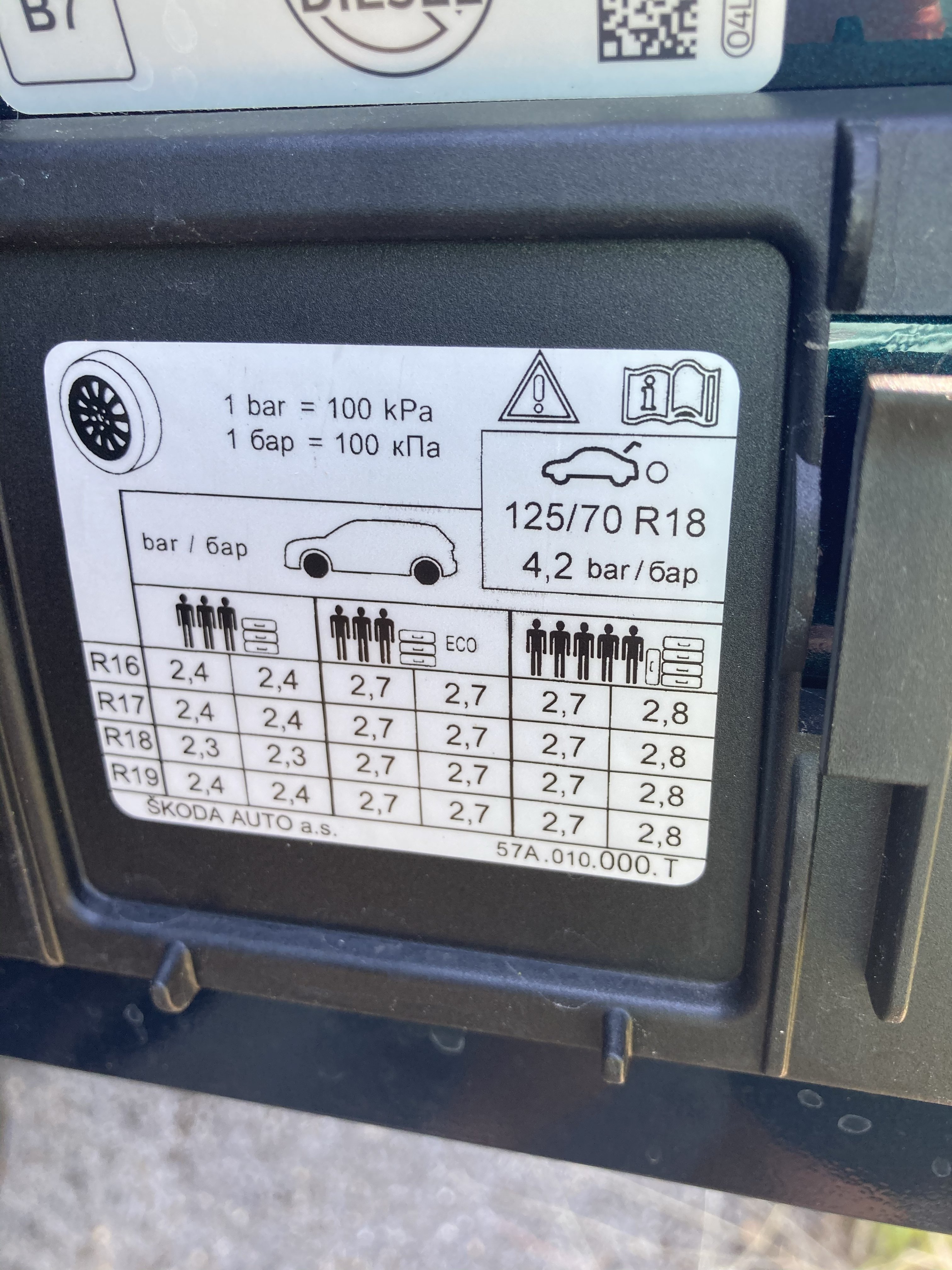

I'm happily running at the lower (1st row) sticker figures, which on 4x4's, fitted with 225 mm wide tyres, are factory set 0.2 Bar higher (see pictures above).
