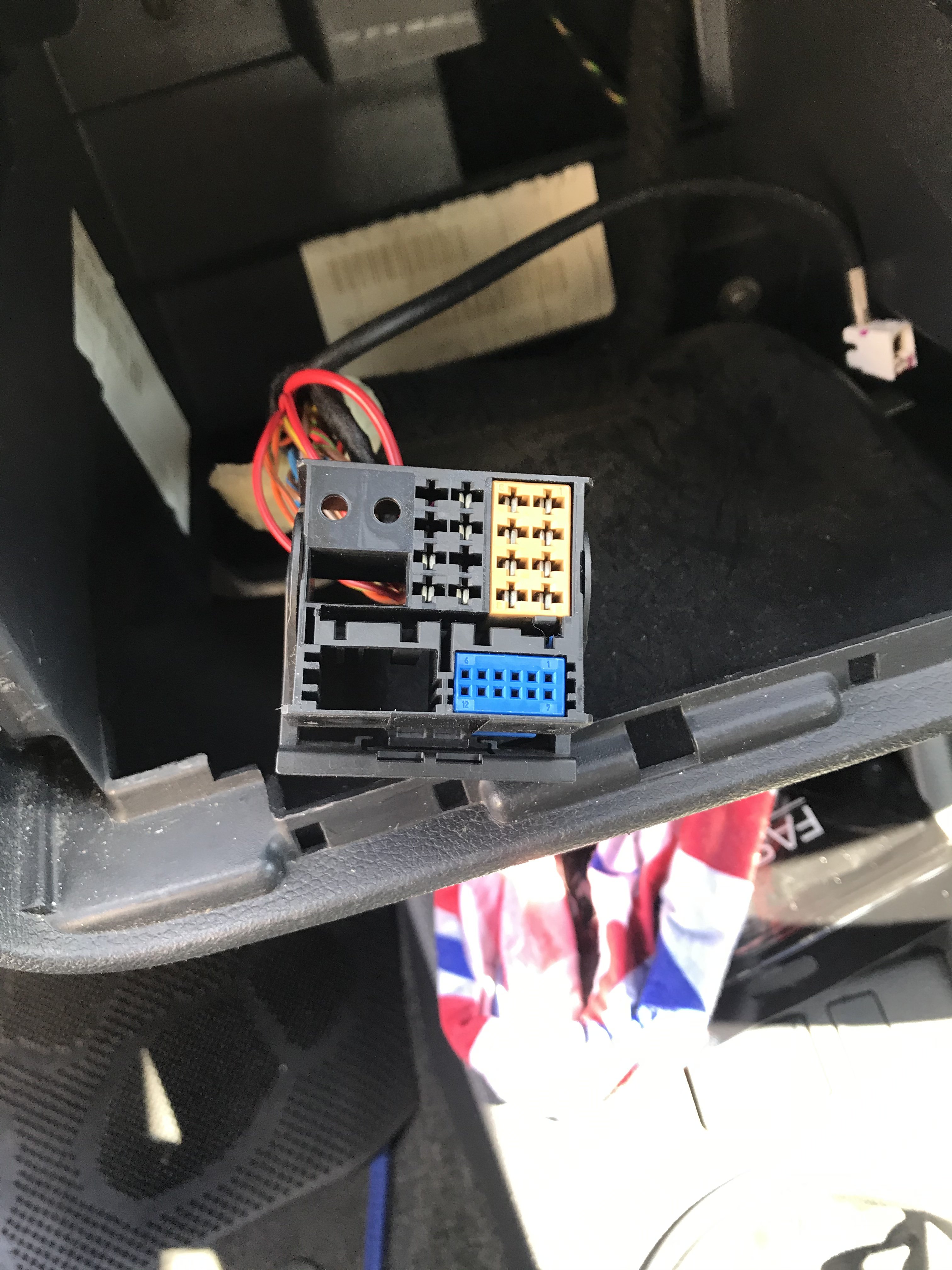

Hi I’ve not long purchased a 2007 Fabia1.4 TDI and with a view to improve the radio I’ve purchased a SkodaAuto Amundsen+ The photo is my present wiring, I have already tried a parrot ck3100 for which I had to buy an adapter.
My problems are 1. will I be able to use the adapter if one is needed and 2. Do I need an adapter for my aerial which is a single socket type the one on the Amundsen is a double ?

I think you might hit problems here with the CAN system. The Amundsen + unit being from a leter car works with CAN2.0 and I think your car uses CAN1.6, so effectively they don't talk to each other correctly. It won't turn on and off with the ignition, and the sat nav won't get instructuions from wheel speed sensors etc. to augment the gps system.
Also, your Amundsen + might have Bluetooth built in so you may not need the parrot kit. Then again, it might have Bluetooth but may not work due to the CAN issue.

That's because it's not actually a relay despite being described as one.
A better description is a canbus translator/convertor?
It has two can bus connections, one that speaks can 1.6 to the car and one that speaks can 2.0 to the headunit. It translates the messages from one to the other. It just happens to be the same form factor as a standard relay but the function/pins are completely different.
