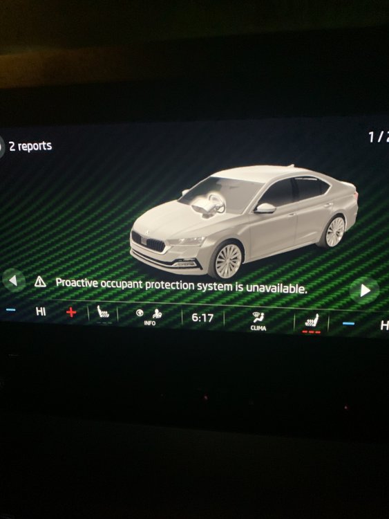

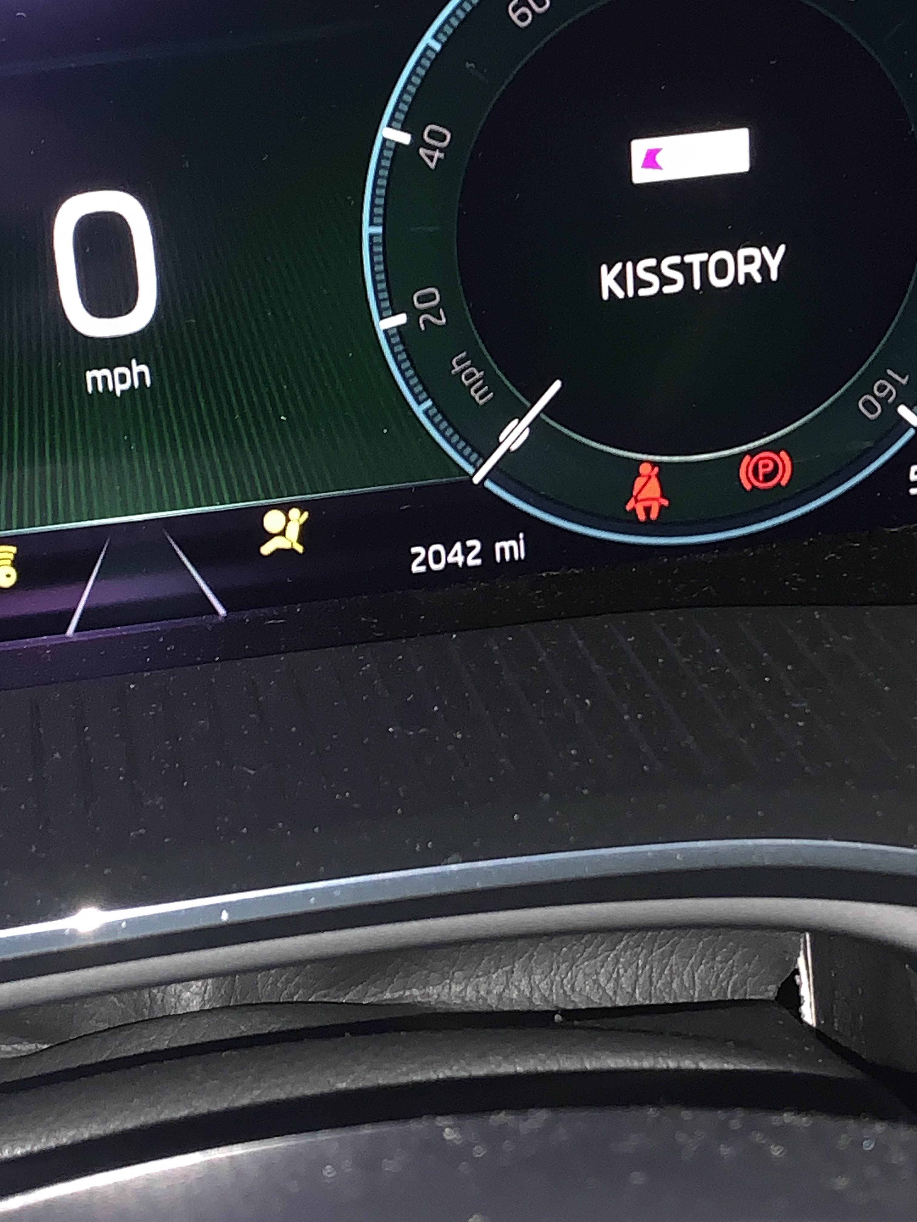

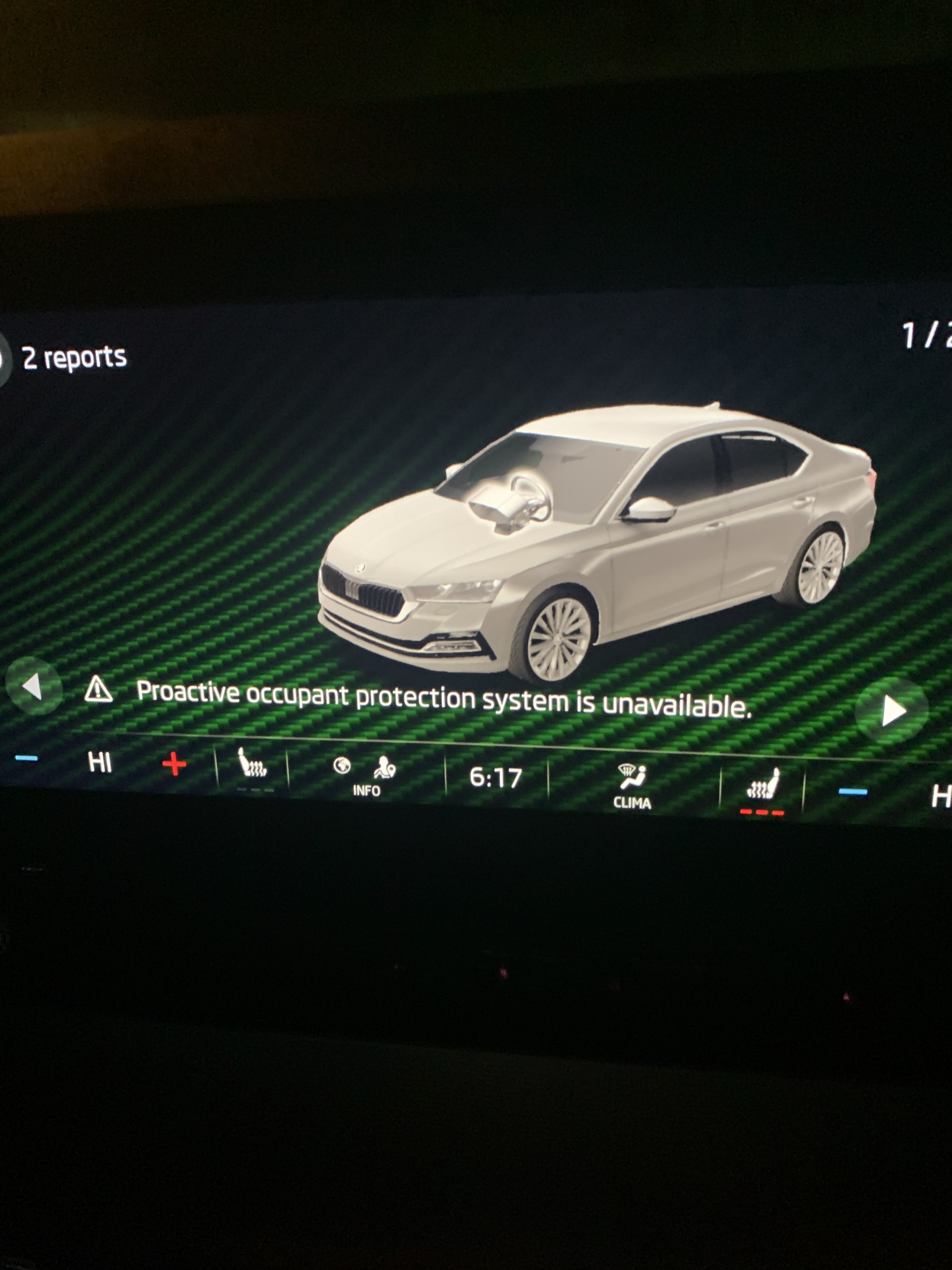

hmmm i have the limited availability on front assist most morning, had a new thin of airbag error and another saying proactive occupant protection system error ( when reported these did not show on system for dealer and also they not heard of it) i also dont have lock/unlock via app is that what ur issue was? Seems this magic selector may fix things, do we know what the selector is?? Thanks

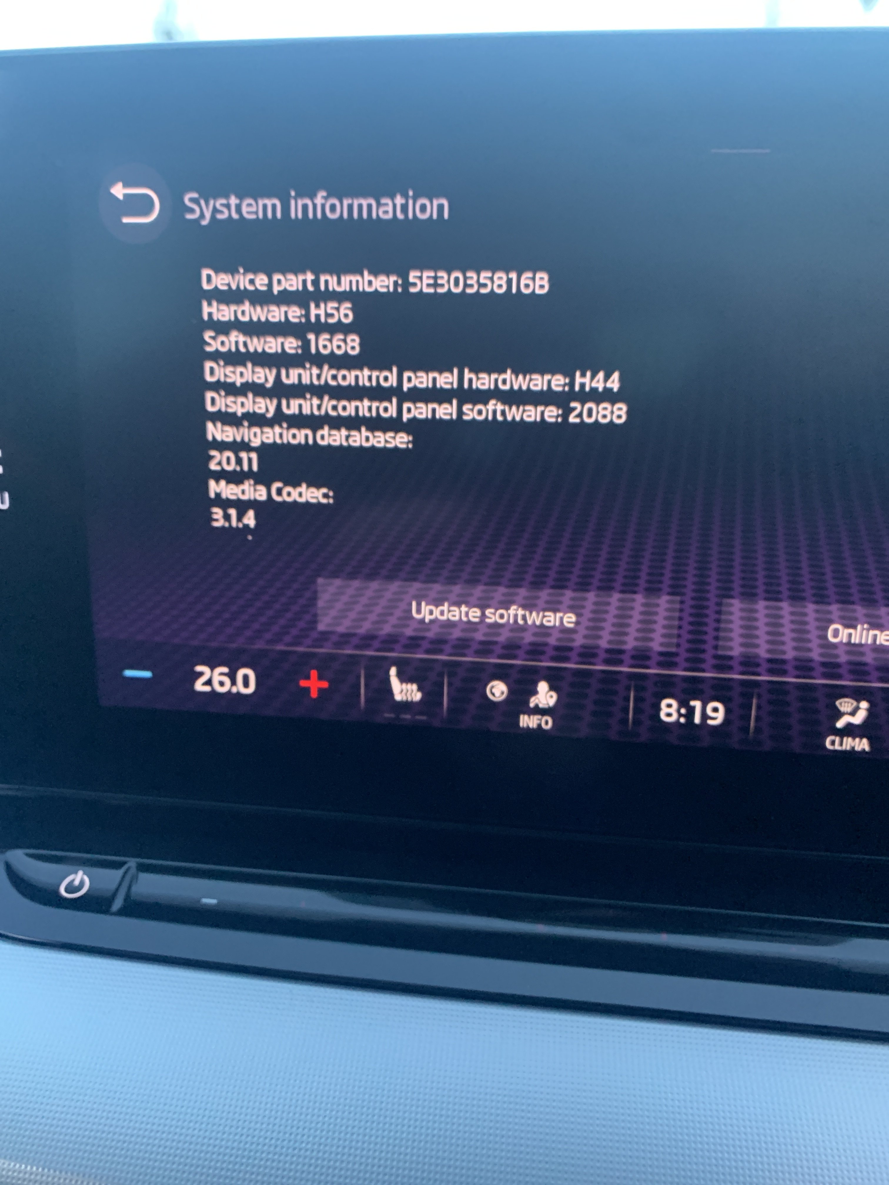

wondering what your software settings are?
I too had this airbag error prior to my car going in for the updates and the seatbelt warning light even though the wife was sitting with the belt on. Got the wife to film it and the comment back from the technician was that it was because the passenger airbag was switched off. This has been turned off since we picked up the car as I have never touched it and we have never had the error before.

ahhh how odd, and i can confirm i do not have the issue with mph, ill look tomoz at what software and get back to you, and when mine first did it i checked air bag and mine was also off for the passenger, since turning on still does it, and does it when im on my own too, pic included...... and yes voice command is a nightmare now wernt as bad before the update
Thanks, I am trying to understand if it is a certain batch they may have some of these issues. Also just looking a some vids on the digital dash it would seem that the background colour changes to what you have the interior lights to. Does yours do this? If we change the interior lighting nothing changes on the dash
Yes what ever i change my ambient lighting to changes the dash, but on the dash where you can change whats in different bits theres a backgrounds (if not there go on the settings and tick it on if you have it) then you can change to colour of ambient lighting , all black or black and white but i find anyone who does not have the clock is not able to this

thats my info
4 minutes ago, Matmacka said:
thats my info
Thanks for that. So the only difference is that you seem to have a later version of the navigation database. Ours is 20.10
