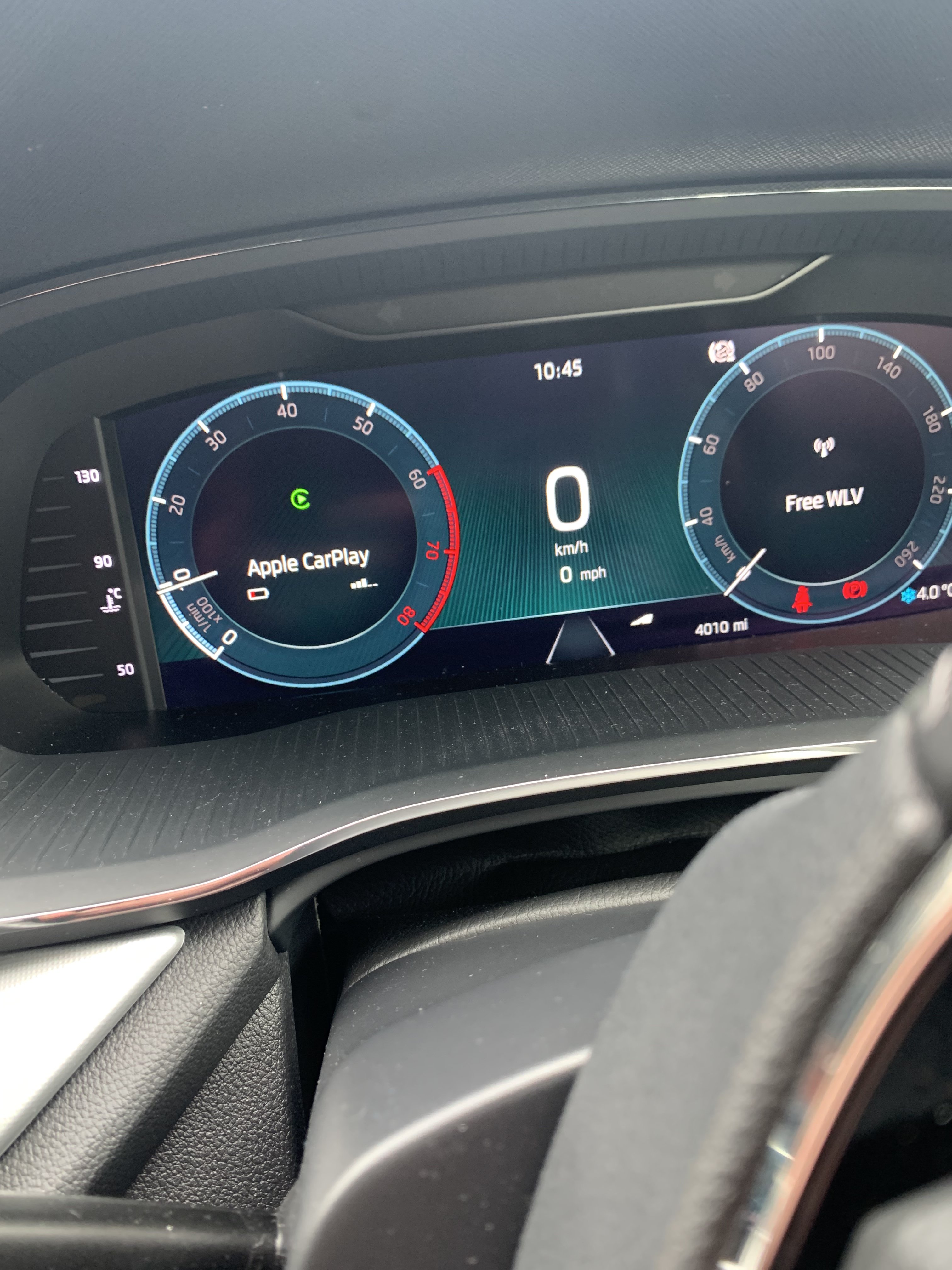

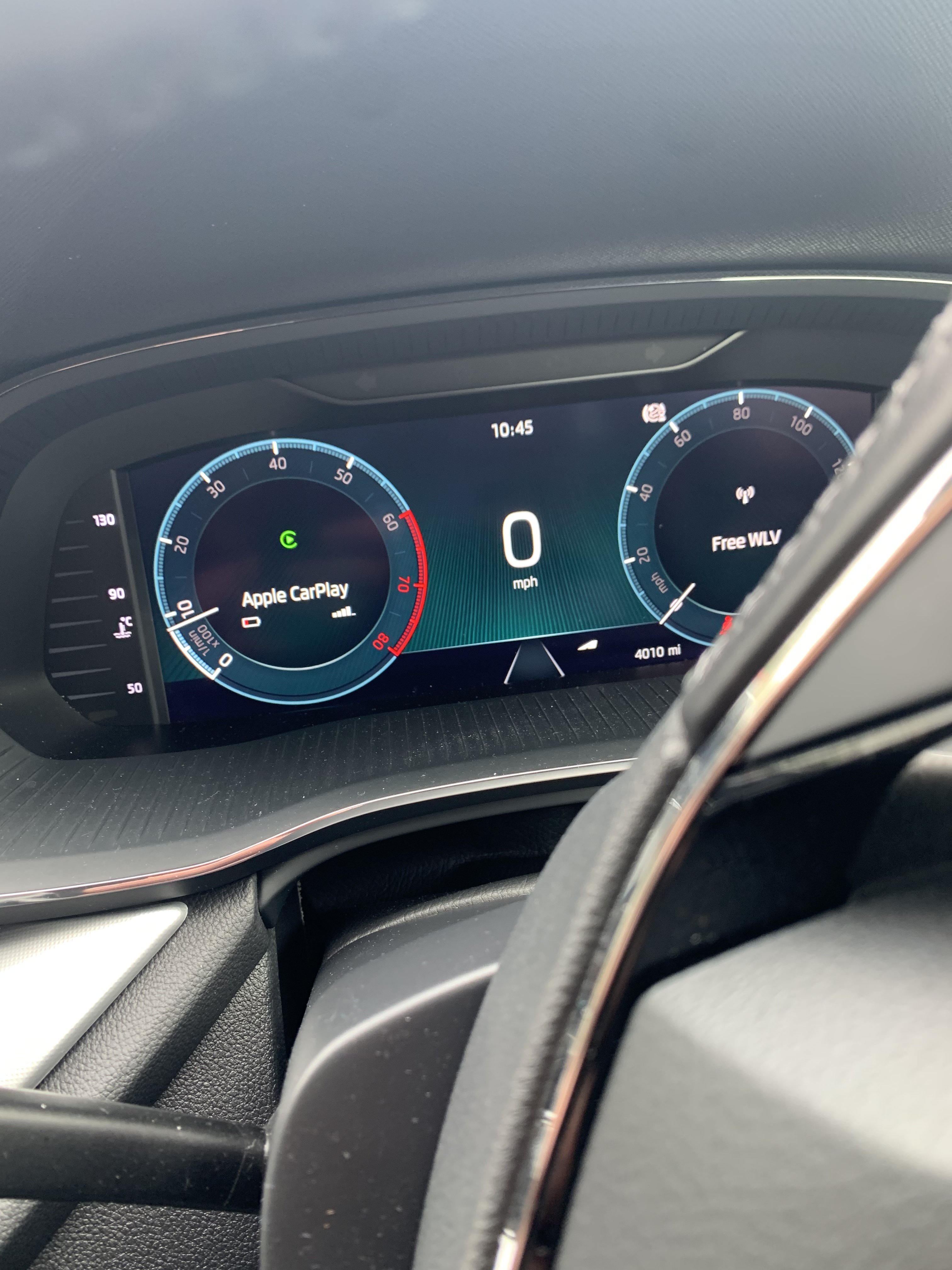

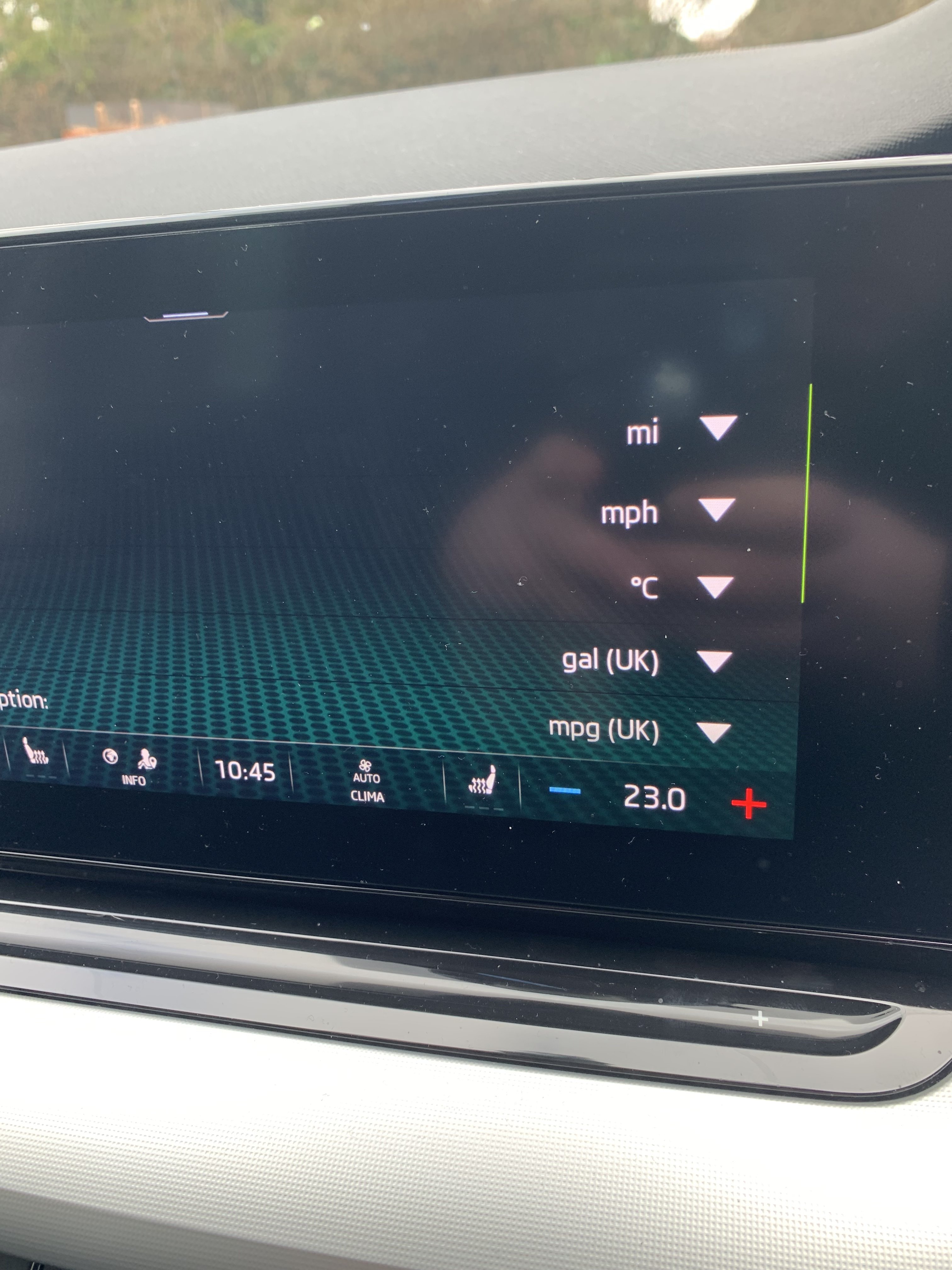

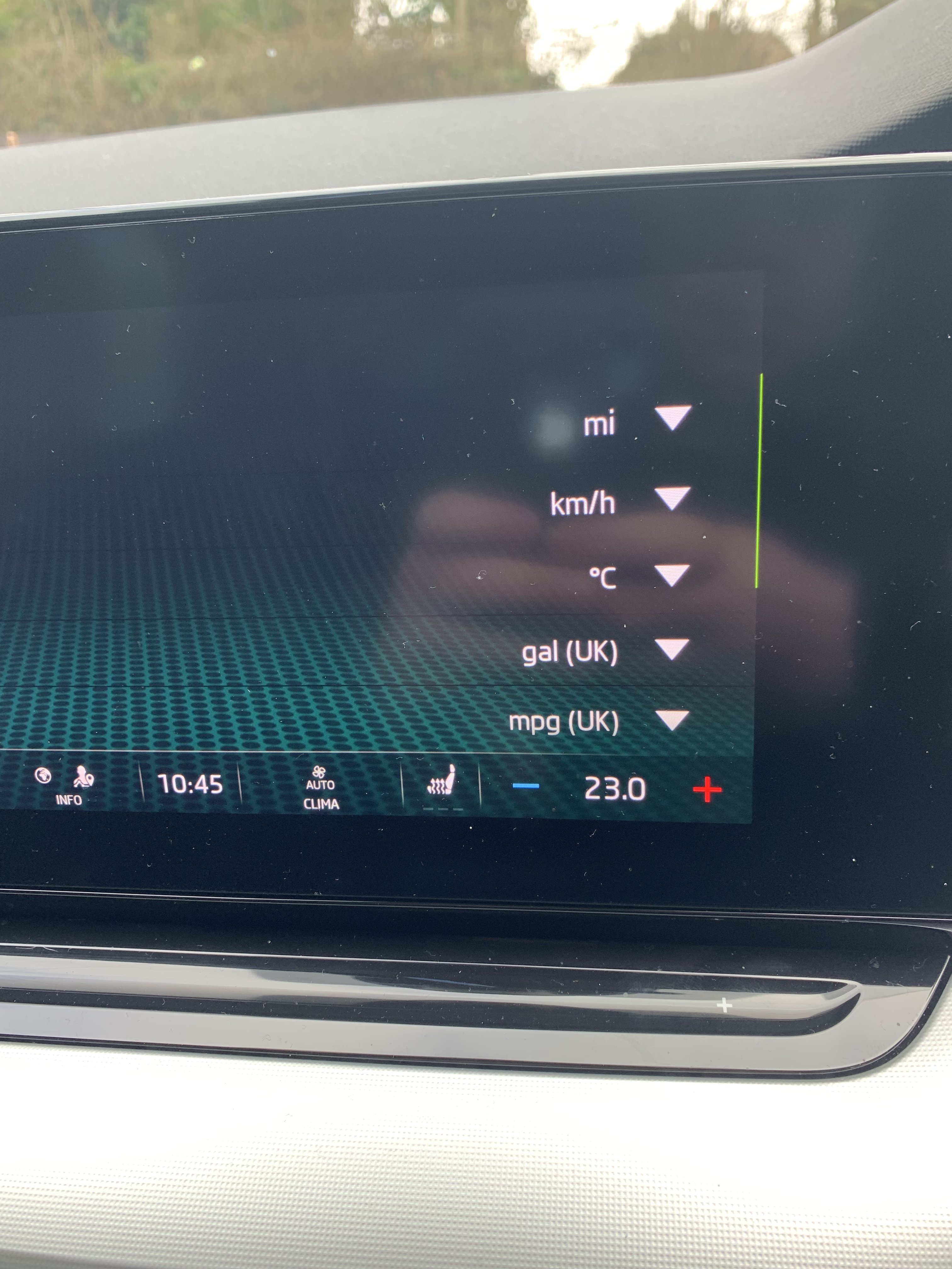

36 minutes ago, Coume said:
@Matmacka
You confirmed that your navigation is showing mph correctly; however, would you be able to confirm if the speedo unit changes correctly to km/h if you select km instead of miles in the units?
That would be extremely helpful if you could.
thanks in advance
will try this in an hour and get back to you

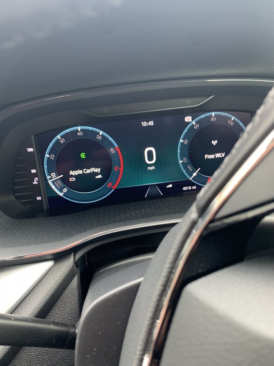

Seems mine does change
Thanks a lot Matmacka. Much appreciated.
It confirms that PN 5E3035816B makes the issue goes away so I can raise the issue formally with my dealership.
