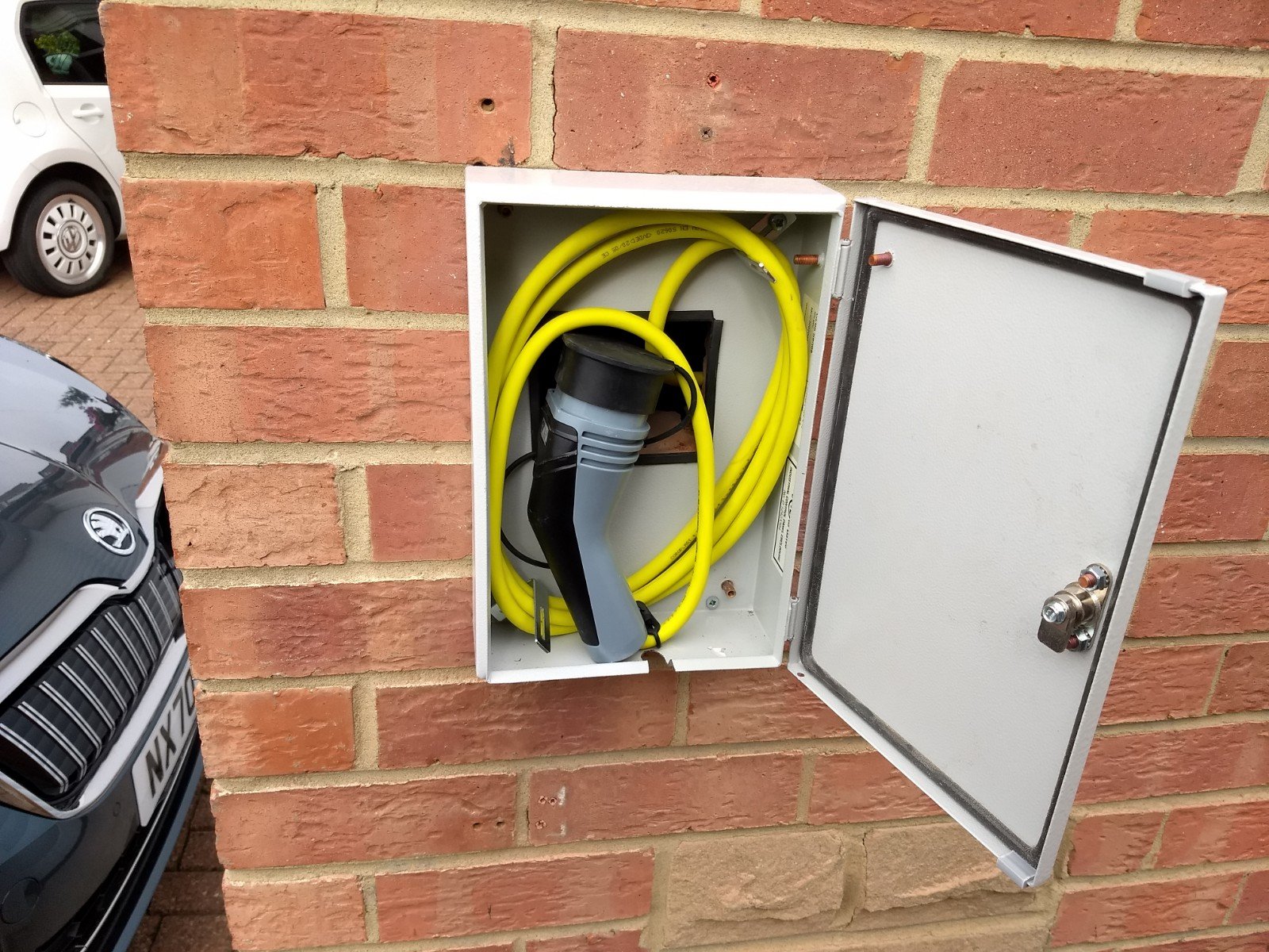

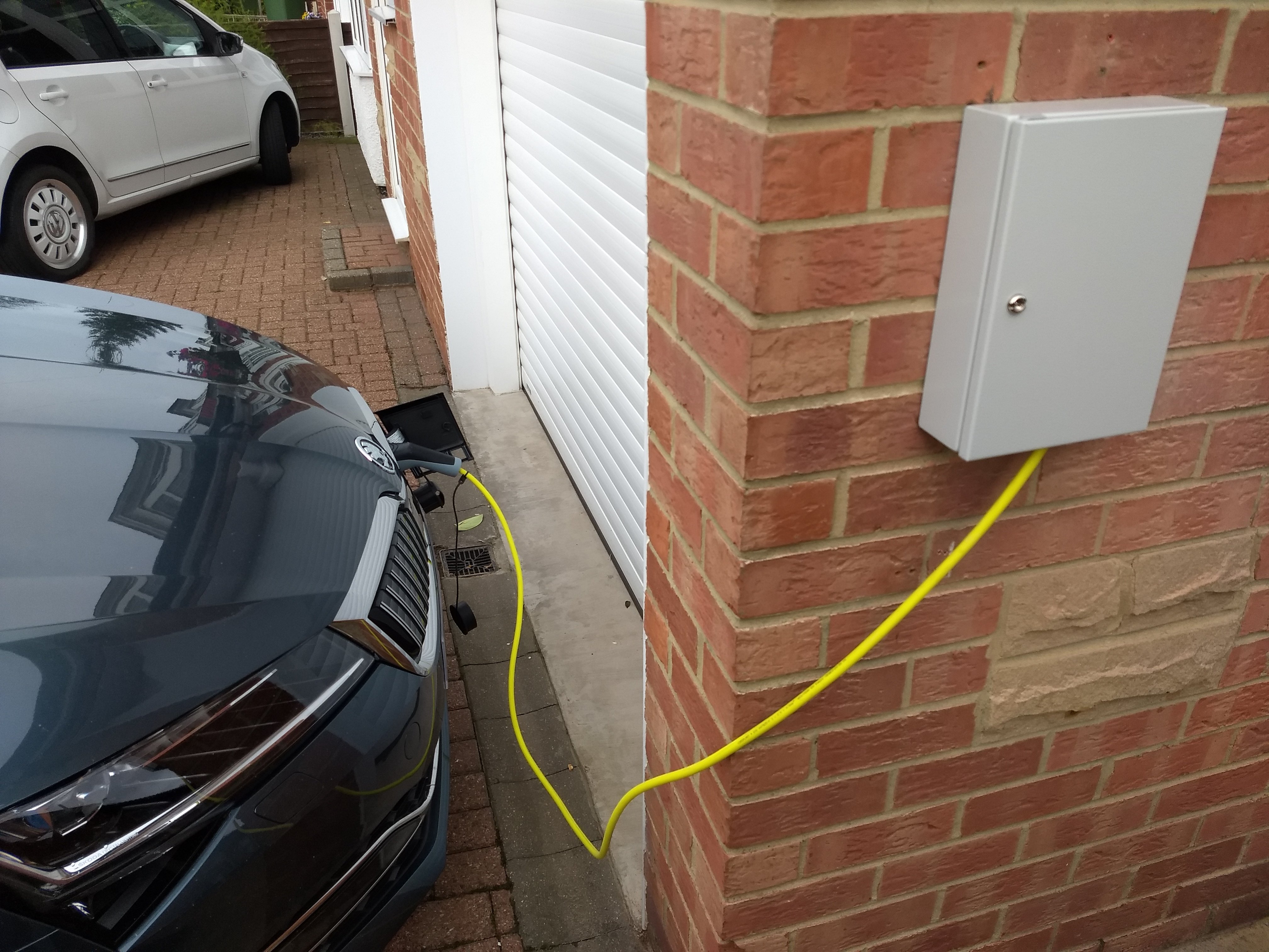

Though I would share my charging setup.
I knocked a half brick out of the side of the garage and mounted a weatherproof box with a similar hole in the back. I passed the cable through from the inside and when not in use it stores inside the box.
So I now don't have to open the garage door to charge up. The box is only 300x200X80 mm so not intrusive. The cable and plug store easily inside it.
If I need to take the cable with me I can easily feed it back through the hole.
Inside the garage the charger is plugged into a dedicated 13A socket via a smart plug from Amazon. This has the energy monitoring feature so using the app I can see how much its costing to charge. Its a Meross socket from Amazon. I can also turn charging on or off using the app or Alexa.
On a recent 640 miles round trip I got about 54mpg. That was just with a single charge up at the start. On the outward leg I got over 60 mpg but the battery was flat when I filled up at 300 miles. These are real brim to brim mpgs. The boot was also full of quite heavy stuff.
I decided not to bother with a fast charger. You only save 1.5 hrs to fully charge and they seem to be very expensive.
I regularly see 34-35 miles indicated battery range. Just back from a trip to the shops. 9 miles in e-mode and battery at 75% and 26 miles range left.

Very innovative! Looks good!

Hi Stephen
Thanks for info and especially the photos.  I wish I'd thought of that.   I have an outside waterproof 13 amp point but nowhere for the cable.
Have you had any issues with rain getting into the front of the car where the rain just runs off the bonnet.
Have you tried fitting the silly rubber thing that goes on the car end of the plug.  I got mine on the plug but found that it stopped the plug fitting into the car socket.

I forgot about those things so not tried them. Not had any issues with rain so far. Not sure if i've had it plugged in when its raining. I will investigate and also try the seals.
