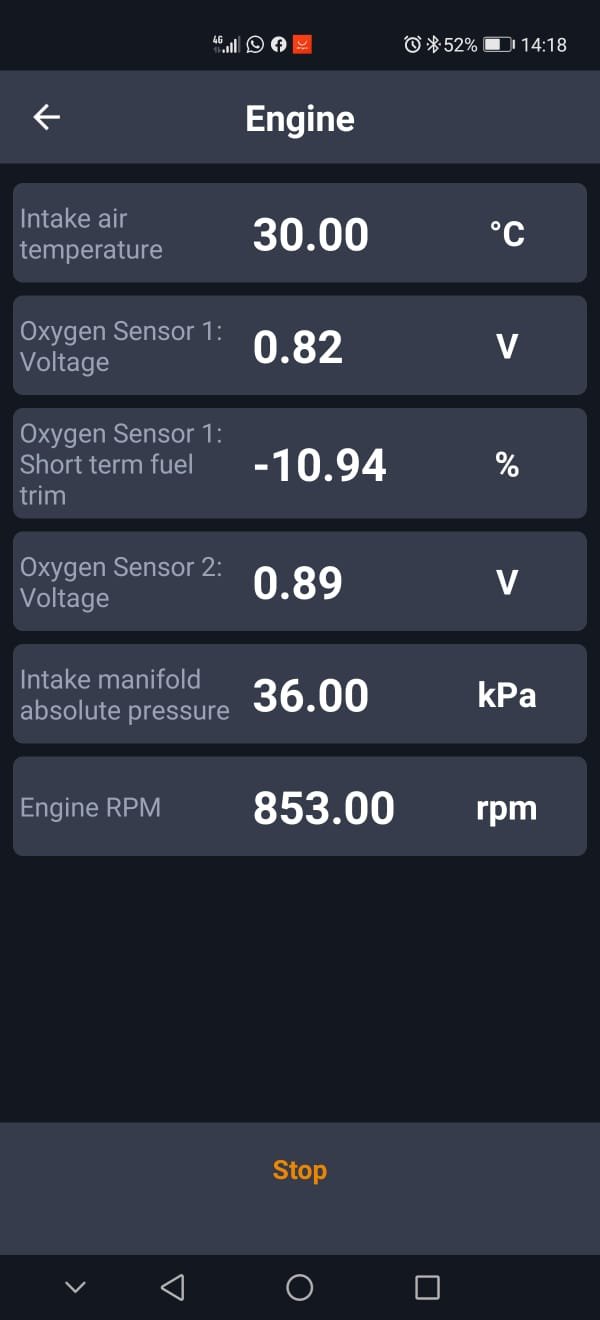

I've managed to get some readings, but are these OK?

Manifold pressure seems a bit high, I think.
