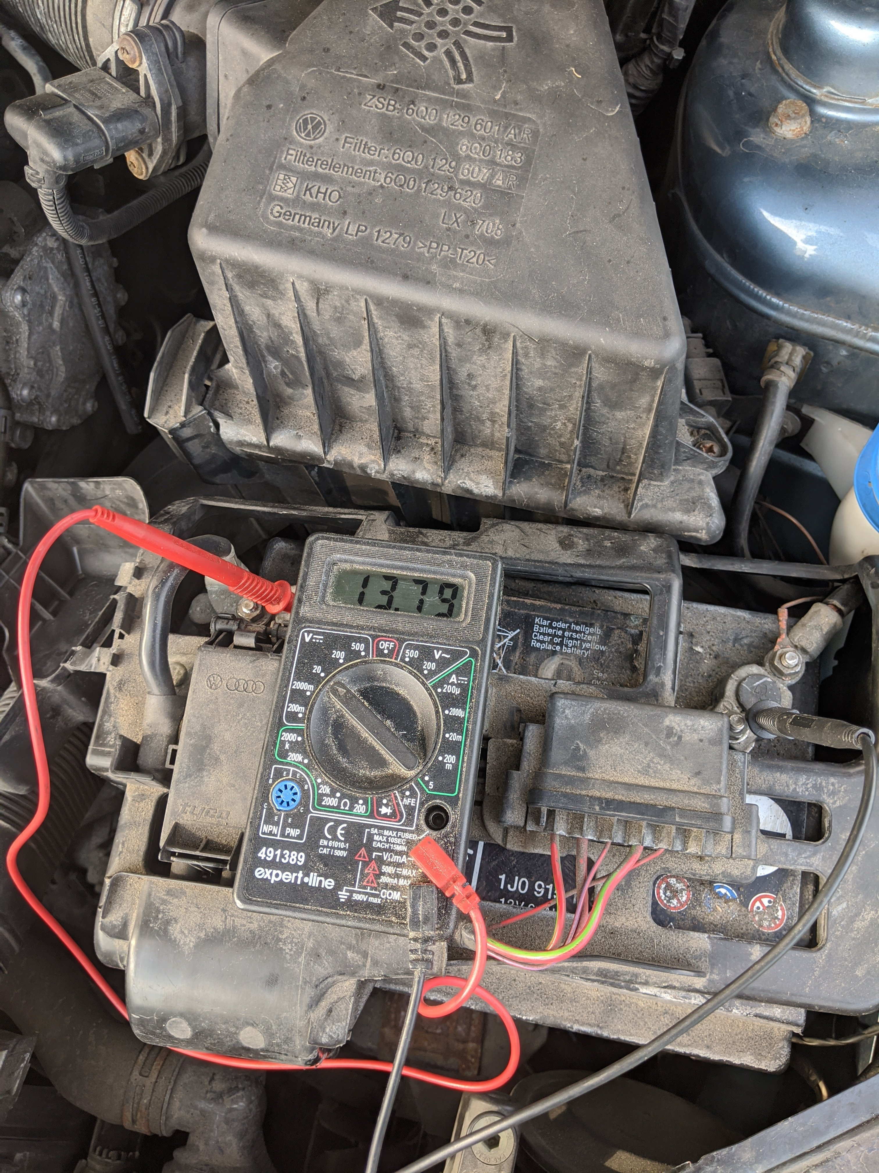

Well, I had a look around when it wouldn't start today (lots of fast clicking) and straight away noticed a large strap connected to the positive battery post which was pretty loose. I loosened the 10mm nut holding it *pictured below under the red diode end*, cleaned the base where it screwed down (with my fingernail, not properly, I might do it properly another day) and screwed it down nice and tight.
Since then I have had only very slightly flickering headlights when using power steering, no weird ABS light, no radio restarting, and no clicking on turning the key!! Oh, and the check engine light went out and hasn't come back on, fingers crossed that stays away!
I've attached a picture of the batt. voltage with engine running. It sat stably between 13.79 and 13.81v with various different electrical loads, including turning the wheel to full lock. I should note this was after tightening up that wire (I also checked for any loose suspects in the area, didn't see any but should have a proper look)
So, it looks like some tentative good news at first! IMG_20200915_103004.thumb.jpg.cf616f2291994814ed876ce8f9885e46.jpg
  • Sponsor
OK, that's good news.
Numbers are still on the low side, but will probably improve as the battery now charges itself up for the first time in a while.

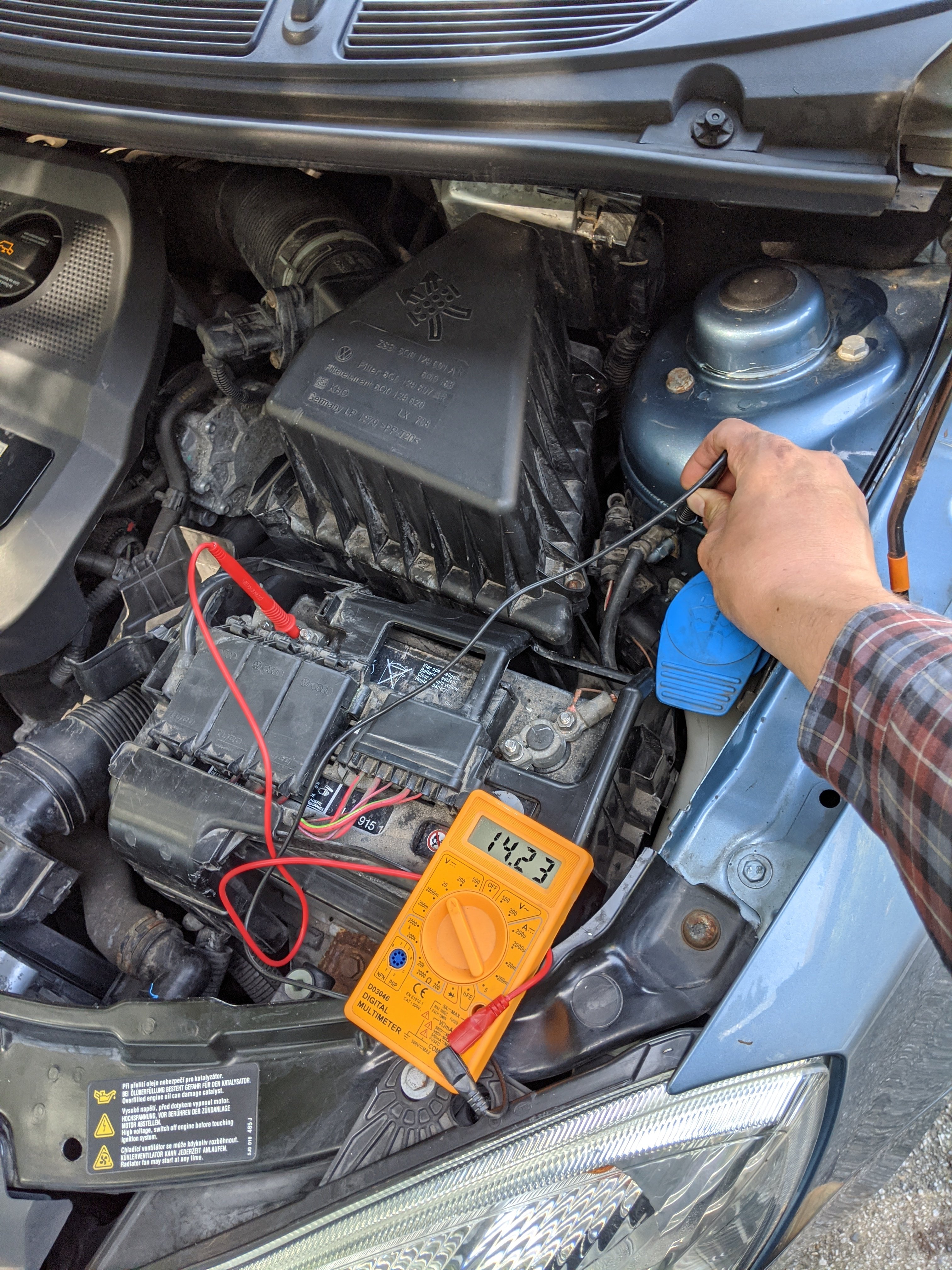

Ok, I got the multimeter on it and the numbers have improved even more!
12.59 volts with the engine off, with the negative lead on the battery and the same with it on the end of the lead to the earth bolt on the suspension tower.
Voltage settled at 14.23 with the engine running, but with high beams on it went down to 14.12.
Other good news is that the auto window up and down (the second click on the button) is working all of a sudden, no return of any weird bugs, engine light not reappeared, and it's also stopped vibrating at idle! (Maybe down to a fast run on the motorway)
