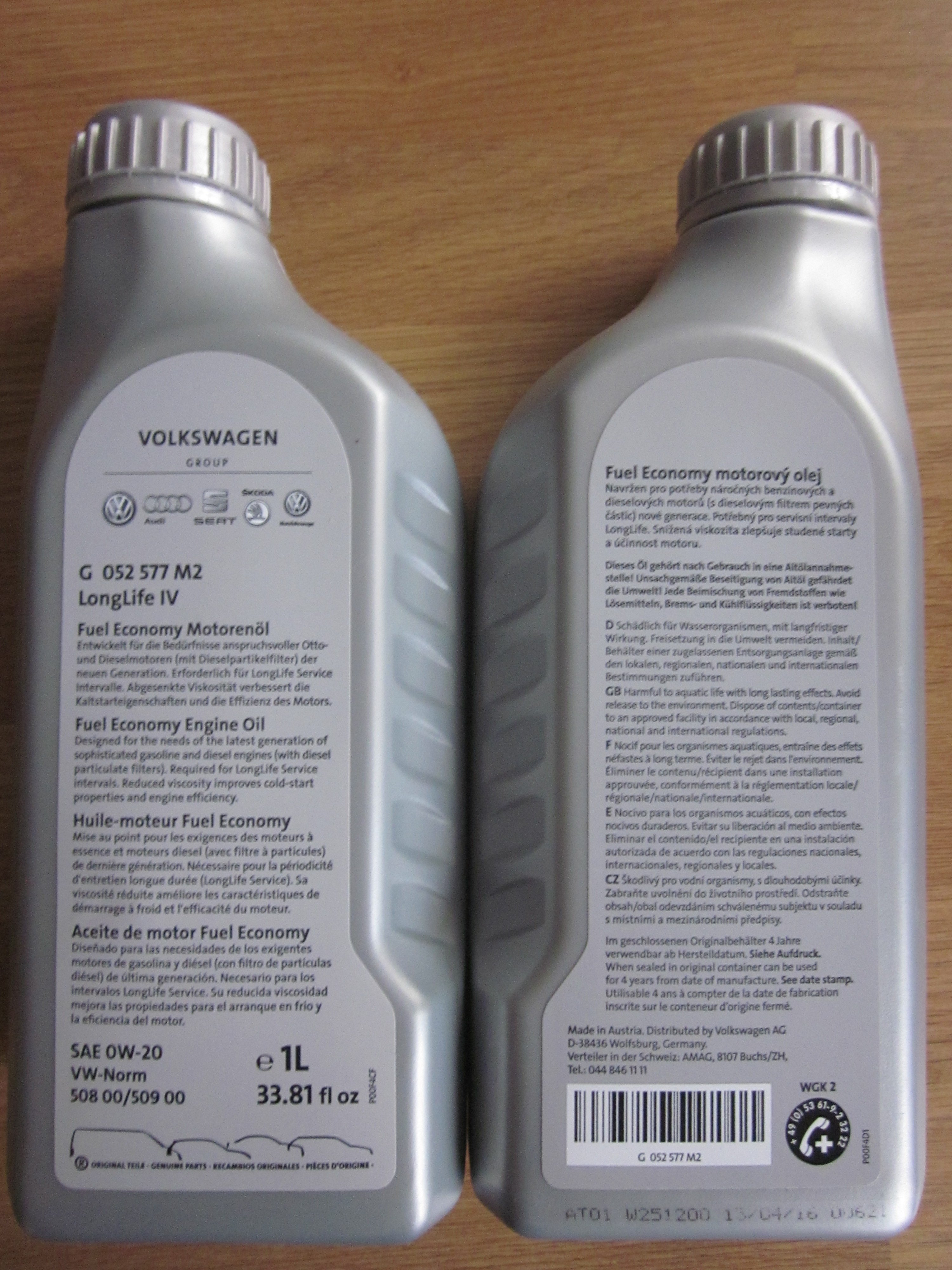

From the factory now the VW Engines get VW 508 / 509.  0w 20 FS IV.
With the Supermarket Brand or other oils the VW502 00 FS is for TSI's on Fixed Servicing if you want use.  Not Long Life and not for TDI's.

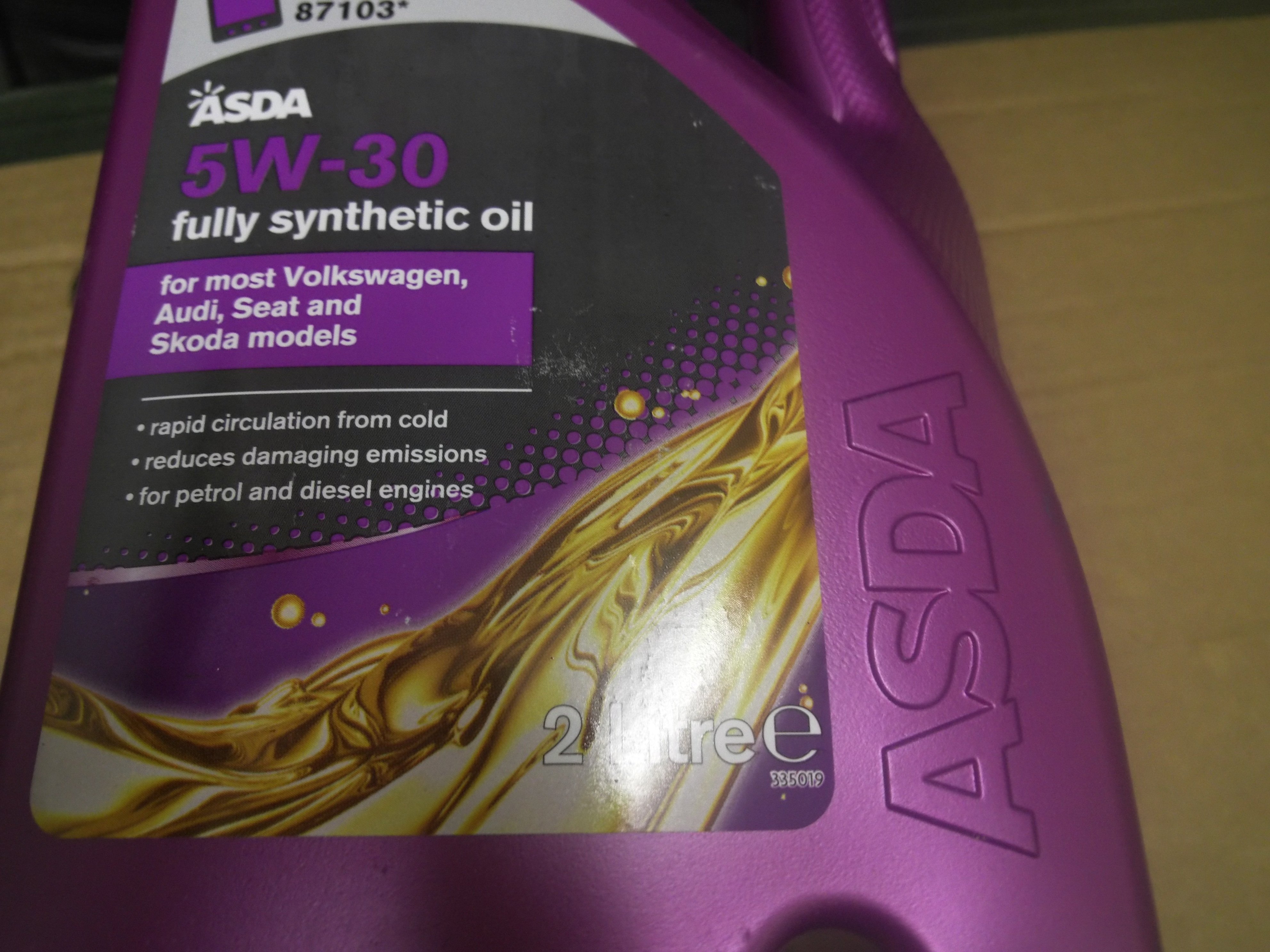

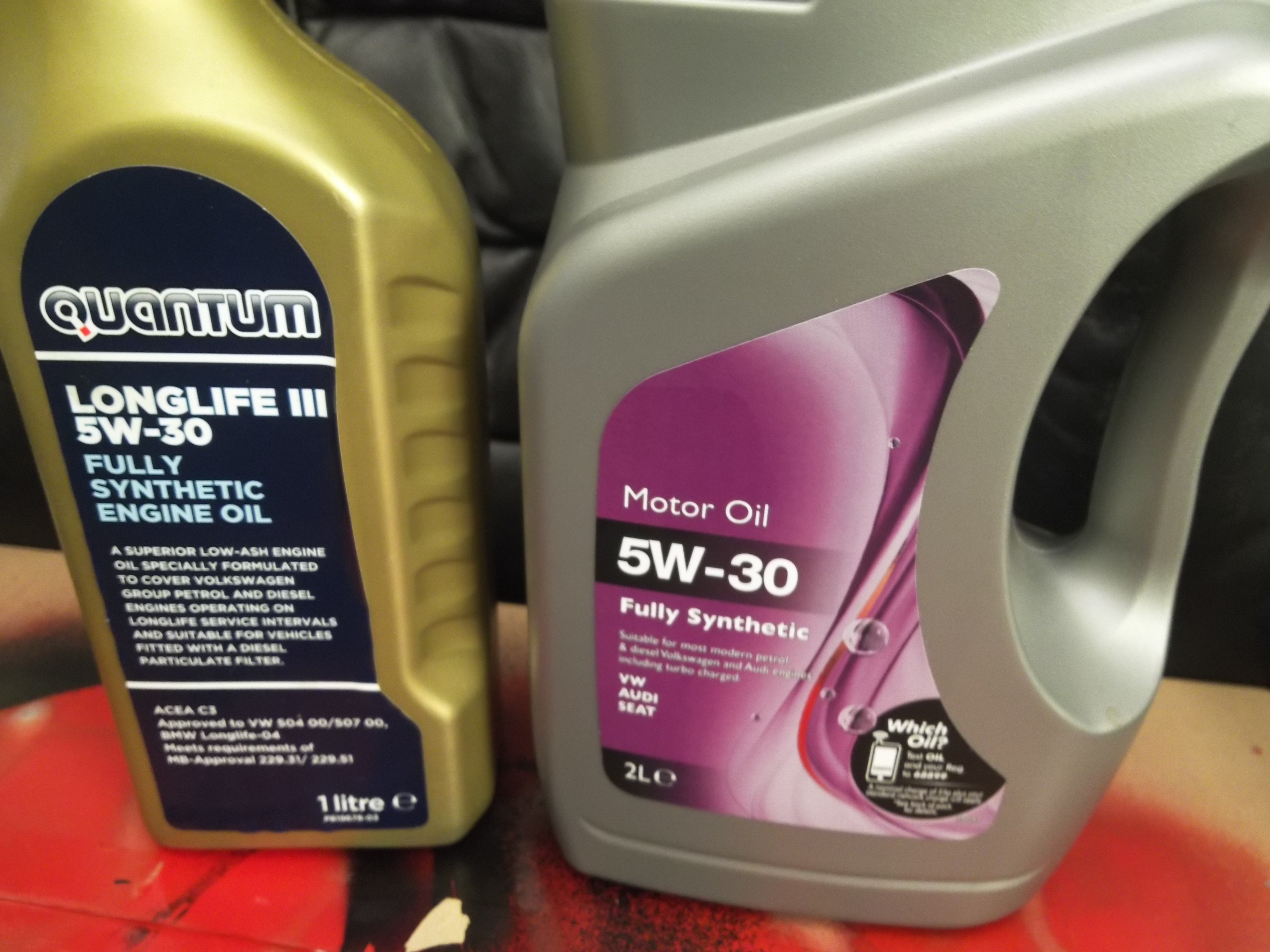

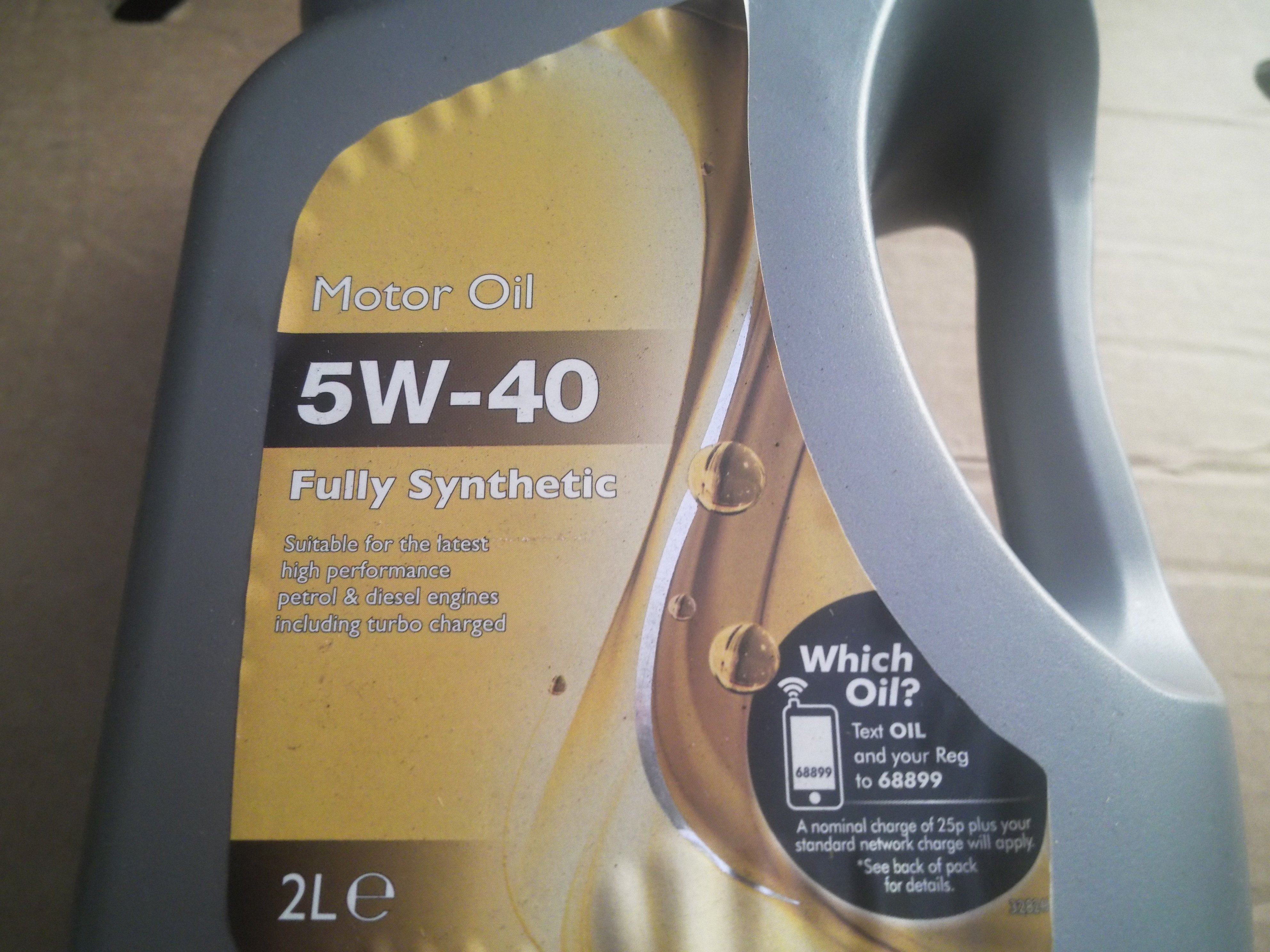

IMG_0480.JPG.7749bea2529914fff1bb454bae89ffa0.jpeg.c9887f900d7e3ef3d8380133d476d1f4.jpeg.6443515f8be1aa02b97d2ecb07a938f9.jpeg
DSCN0626.JPG.3e197b4aff79c06b5ba51bebcd7d607e.JPG.a31da8d542143b682cd003f628314cec.JPG.98bfec4920298c451d0ee42c6ac7a4c0.jpeg
DSCN0630.JPG.1a0b348ee21930609aed64c20d855480.JPG.7c66bc76c402c2f53669b7c9d0b27286.jpeg

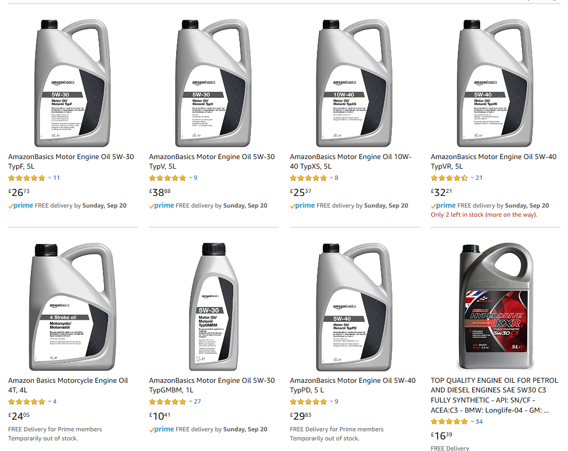

Amazon branded not as cheap as I'd've expected:
  • Sponsor
Haha, the logo on that with the drop as the o and the fact that I haven't got my reading glasses on made me read that as "Tap Water" at first glance. :D
And why doesn't it seem to say anything about 504 00/507 00 on the bottle?
Edited by Wino
I don't see any VW approval on the can.....
  • Sponsor
Looks like a misleading listing title.
3 hours ago, farty said:
So, a Tesco, Amazon or Halfords oil that meets VW 507 00 is probably just as good as a Castrol or Mobil equivalent?  And could be almost identical?
Not necessarily. As I said, an oil could sail over the bar but get no extra credit for it. This is where the oil companies attempt to show how their oils are differentiated from others and hence worth the extra.
Unlikely to be identical - even if a big name made the oil for another seller, they would likely not give away their ‘good stuff’ but would make something that just sneaks over the bar and is appropriately priced.
