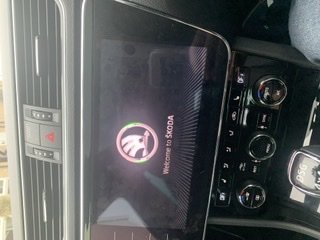

SportLine radio screen
It only works with Columbus, MIB1, 2 and 2.5. Not Amundsen unfortunately.
  • Replies 65
  • Views 22.6k

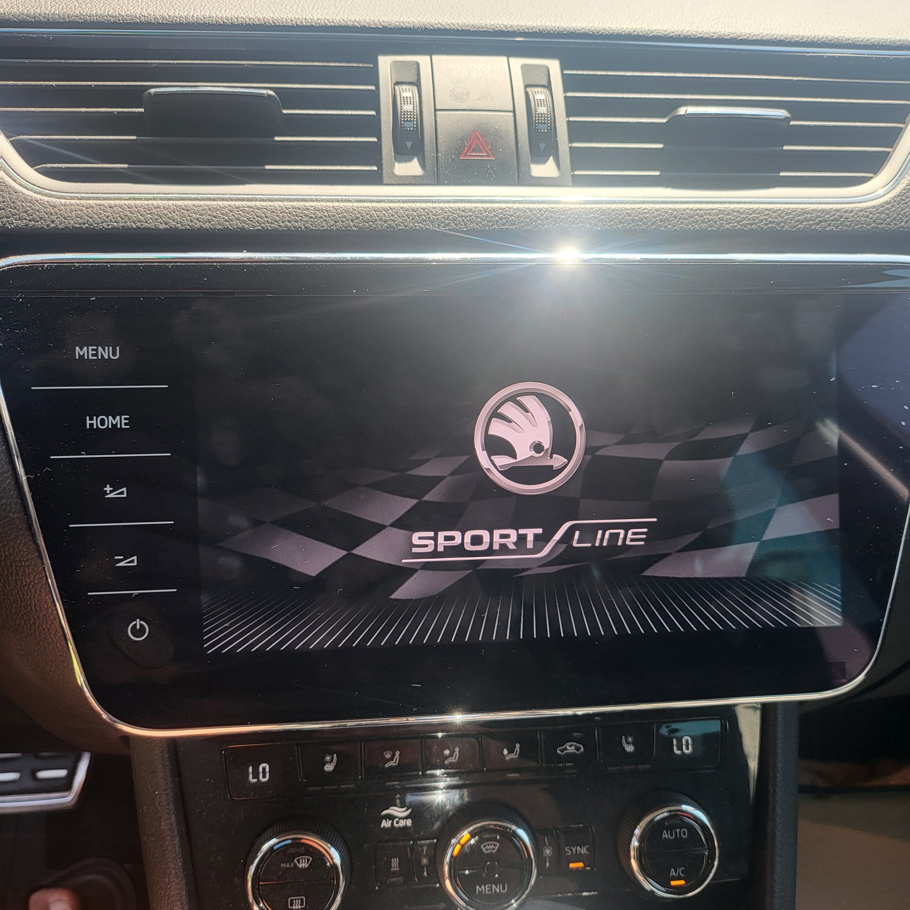

  • Unfortunately type 13 is not an option with Carista but I tried the others: Type none - welcome to Skoda (default on mine) Type 1 - vRS Type 2 - scout Type 3 - Laurin & klement
  • Yeah it is,   Go to 36 Drivers seat Long Coding and activate ‘Easy entry over MMI’ and then 5F Infotainment Adaptations in Car_Function_Adaptaions_Gen 2 and activate menu_display_drivers_sea
  • Got invited to beta test Carista again today after sending a debug log yesterday and they have added option 8 for the infotainment startup logo. just tried it and I now have the sportline startup

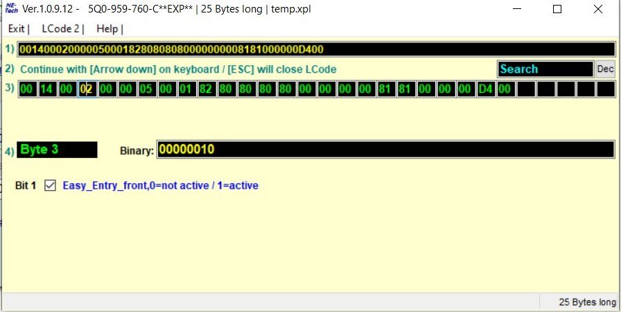

Sasha, how did you enable the menu in the infotainment for the seats?
Mine doesn't have it, now I've got VCDS I have compared the coding after changing it with Carista and confirmed its byte 3 bit 1 to enable or disable it but I can't seem to get that menu to show on the touchscreen.

Edited post as I've now sussed this out, enabling the Seats menu and comfort entry toggle as below:
Long coding byte 3 bit 1 to enable comfort entry:
Then byte 9 bit 6 (part 1)
and then adaptions gen2 menu display seat configuration (part 2)

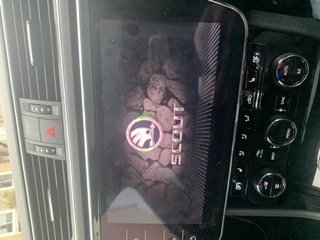

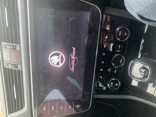

Type 1 - vRS
Type 2 - scout
Type 4 - n/a (welcome to Skoda)
Type 5 - n/a (welcome to Skoda)
Type 6 - n/a (welcome to Skoda)
Type 7 -  Monte Carlo

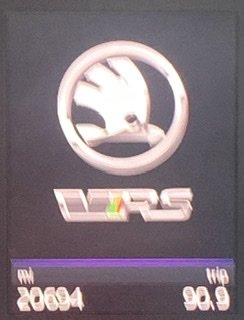

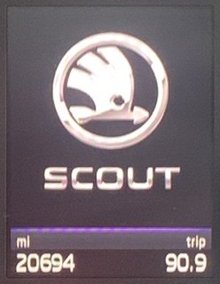

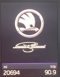

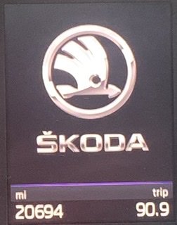

Also tried the instrument cluster start logo:
Type 1 - Skoda (default on mine)
Type 2 - vRS
Type 3 - Laurin & Klement
Type 4 - Scout
Type 5 - blank
Type 6 - sportline
Type 7 - Skoda
Type 8 - blank
seemed a bit hit and miss with the ones that were blank (depended on what was set before it seems) and the infotainment blank ones certainly set the “module incorrectly coded” flag but the other seem to work fine. Pity none of the options for the infotainment are relevant for my car so I’ve left alone but I was pleased to discover the instrument cluster one had a sportline one so I’ve kept that!
pics below:
VCDS - Module 5f, byte 18 change to 08 and you have sportline
Edited by moldi
Programing using vdcs
Mine has been working with the sportline startup logo for years since I coded it as I posted previously on this thread! I did quite a bit of experimenting as detailed at the time to find the correct combination for my car
