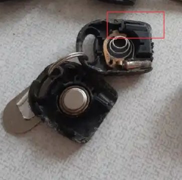

If you want to be 100% sure, you can take key apart and check if there's immobiliser chip (sorry for picture quality)
