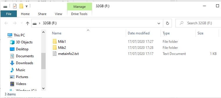

Note there should only be 1 file "metainfo2.txt" and 2 folders "Mib1" and "Mib2" at the top (root) level of the USB stick. If there are any other files showing in addition to those then delete them from the USB stick before step 10 above.
If you extract the downloaded zip file directly to the USB stick/SD card then check if the extraction process creates a new folder and copies the files inside that folder. That would mean the required files would NOT be in the root/top level but would be inside a folder and therefore would not be found by the Columbus. This is why I recommend extracting the zip file to the hard drive of the computer first, then copying the resulting files manually to the USB stick/SD card as this gives you more control over where the files are copied to.
This is how the USB stick/SD card should look at the root level

And make sure the folders "Mib1", "Mib2" and the file "metainfo2.txt" are at the top  (root) of the SD card's folder structure before you put it in the car. See the screenshot above for what you should see when you browse the SD card from your laptop.
