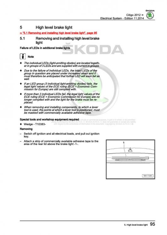

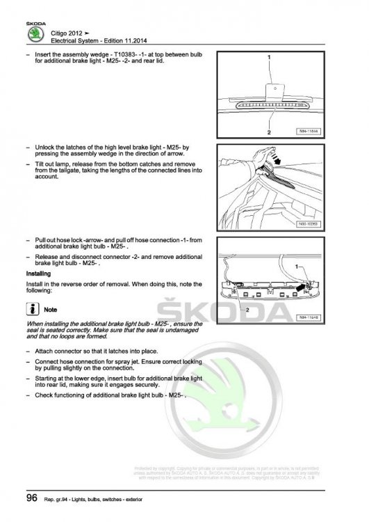

Here's the guide from the workshop manual on how to remove and replace it.   It's quite unlucky and uncommon to stop working on a car from only 2017.  If you have a simple circuit tester you can check if it's receiving power once its removed before buying a replacement.  If it is then a replacement will mostly likely fix the issue, if its not then unfortunately it'll be some electrical gremlin that'll need further investigation.
