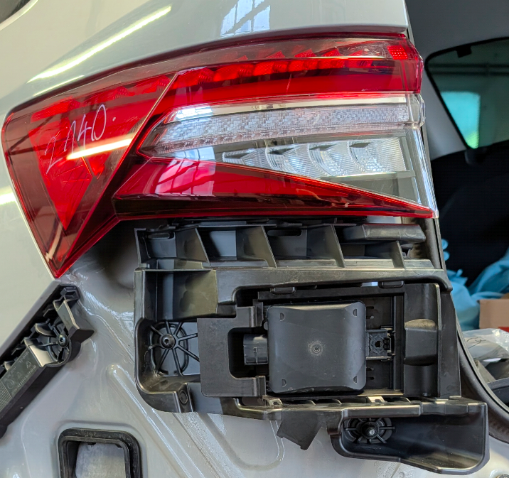

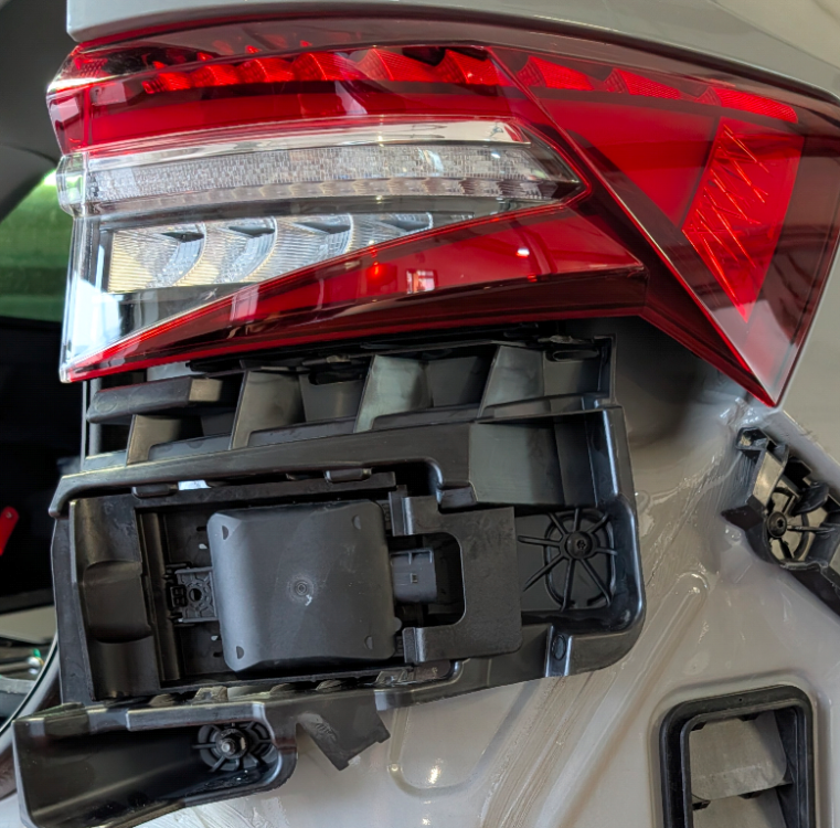

Today we started installing and wiring the radar sensors.
Since it's the facelift rear end, we installed the OEM bracket for the 2Q0 radar sensors.
At the same time, we installed the tow hitch.
The mechanical part is mostly finished; the cables are in the trunk and all that's left is to route and connect everything inside the car. Coding is also required, of course.
A few photos.

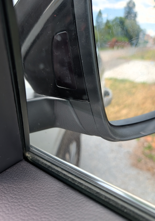

Does the kodiaq have the warning lights on the glass or the mirror covers?
I’m thinking about adding this to my Superb but was looking at the generic kits and then thought about connecting the indicator wiring to OEM lights in the mirror caps.
Control units, brackets, etc., are all OEM parts. Here in the Kodiaq, the visual display is integrated into the mirror glass; these are aftermarket parts because genuine OEM glass costs over €300 each. The wiring harness is partly self-made and partly sourced from AliExpress. It always depends on the current price.

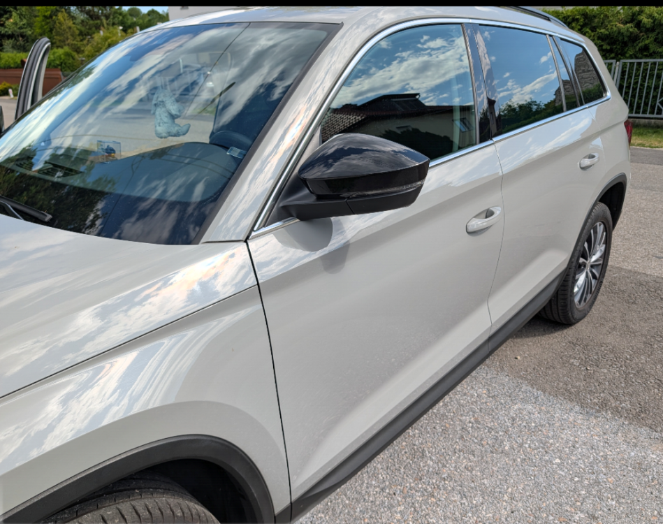

It continues, in 34°C shade... Driver's door fully wired for lane change assist, only one connector is missing... Driver's door lock also replaced, because it sporadically wouldn't open.

Yesterday i Finish the Retrofit
Can you describe the OEM behaviour of the lights? Do they increase in intensity with proximity? Do they behave differently if you are indicating at the same time as something in your blind spot?
Going to have a go at fitting my non-OEM kit this week and see how it compares. Will then look to connect to OEM lights in the wing mirrors if it works well.
Also can you describe how much coding was required and did you have to remove component protection? Just in case I decide to go down the OEM route.
Guten Morgen.
OEM kann man die Helligkeit einstellen. In dieser Einstellung Leuchten diese konstant, ausgenommen es ist eine Gefahren Situation bei Spurwechsel. Dort ist die LED immer am hellsten und blinkt extrem schnell.
Wenn ein Fahrzeug erkannt wird, leuchtet die LED in der gewählten Helligkeit auf, solange wie es eben das Steuergerät sagt.
