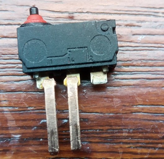

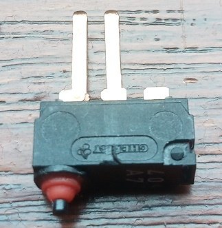

I have a micro-switch from a Yeti if anyone needs it although it is very hard to get the boot handle apart without wrecking it.  I got a spare boot handle from eBay for £24 so I took the old one apart out of curiosity.  The micro switch just needed a wiggle to free it up.  Maybe yours just needs a few technical taps?
Edited by farty
If that's all it is I will have a play as skoda wants £315 to do it lol many thanks...
My switch was stuck 'in' so the two contacts were shorted.  If you are going to prise yours apart, put it on top of a radiator or somewhere warm, as the plastic is brittle when cold.  Mine was quite easy to pull from the car, I just pressed both sides inwards with two, blunt kitchen knives.
