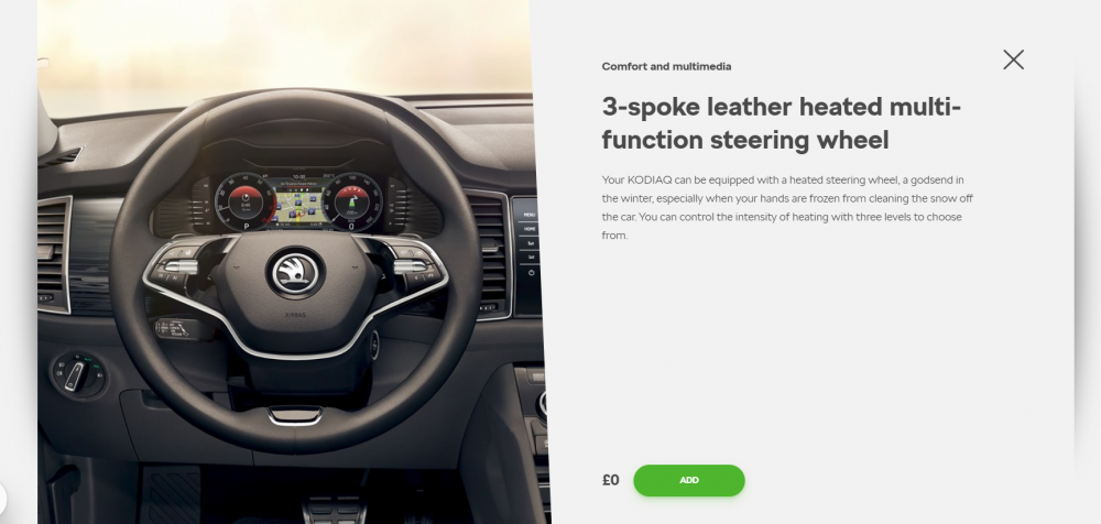

Seems its now a no cost option if you build car today.
From the Skoda website, its currently showing as standard equipment "2-spoke heated leather multi-function steering wheel with hands off detection and DSG paddles" on the L&K.  The 3 spoke heated wheel  is shown as a no cost option.

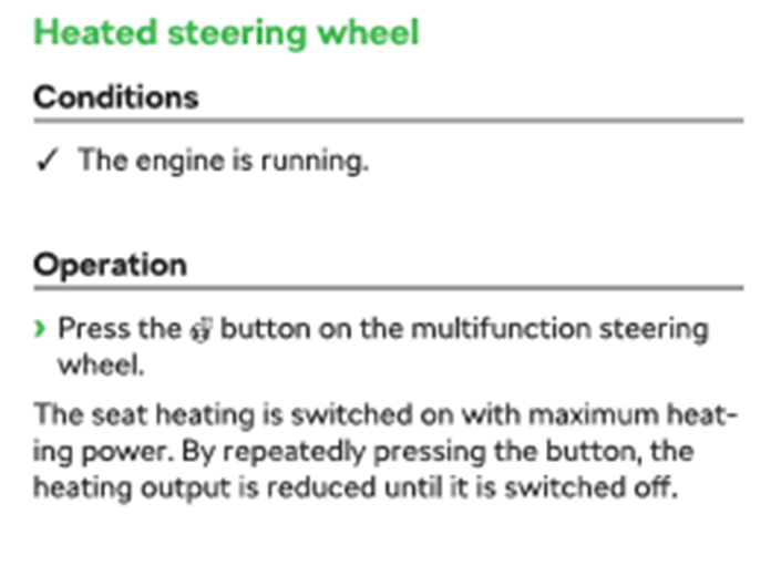

RTFM
spacer.pngThis is the steering wheel that I have, that doesn't have the button that Arkaig refers to.

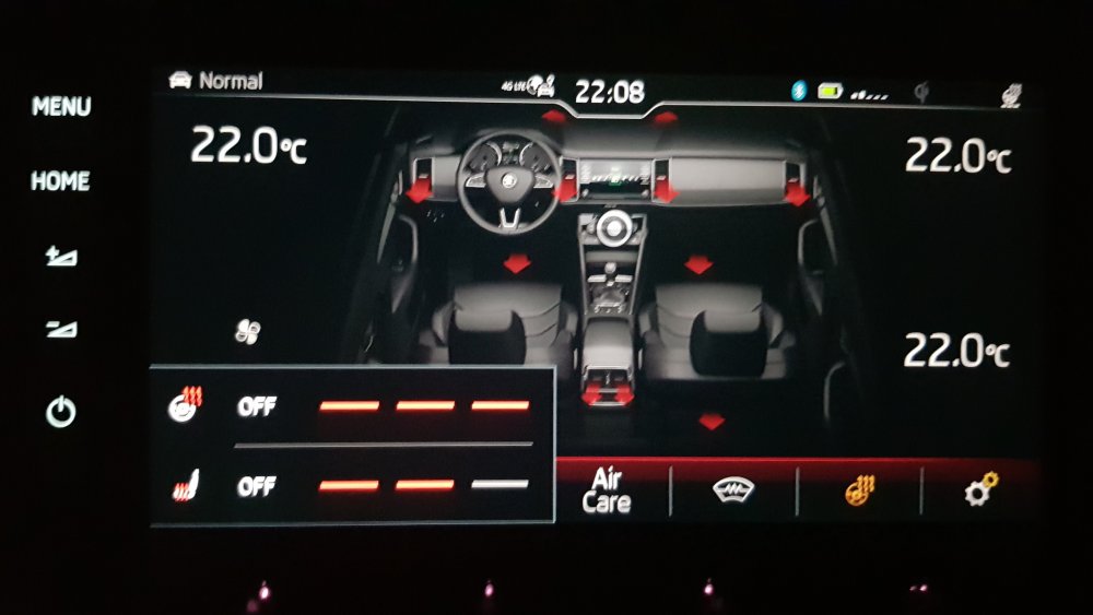

Press Menu button on climatronic: do you have steering wheel option there at all?

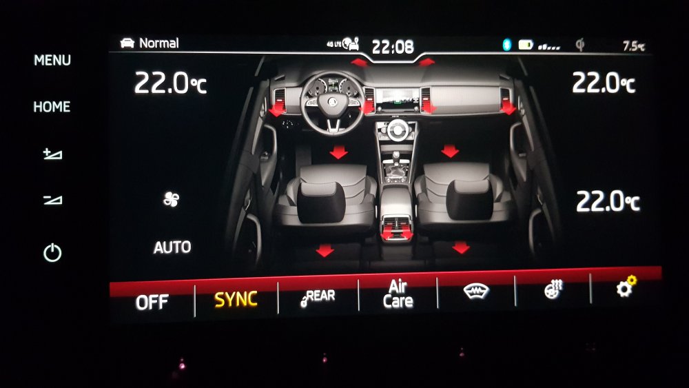

 Hi Linni.  No heated steering wheel option.  Hopefully these pictures will be clear enough to show what I have.
Unfortunately it means you don`t have heated steering wheel.
Clima menu should look like this:
Oh dear.  Not good.  I thought that it was standard spec on a UK Kodiaq L&K

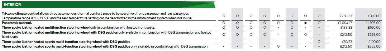

To confirm what SimonAudi has been trying to tell you, here is the options list from a brochure dated 16th Jul 2020
As you can see, heated steering wheel was an option on the L&K.  You've been reading the brochure for the current model  i.e. MY21, when in fact you've bought a MY20 car.
The only std thing on that list the L&K has is a sunroof. You'll have to invest in a pair of gloves if you want warm and toastie digits.

Thank you Scot - that clears things up for me, even though it isn't what I wanted to read !   From reading, then rereading all of the Autotrader Ad for Kodiaq L&K's at Skoda Main Dealers, it looks like I've overlooked this bit at the bottom
"Please note
The data displayed above details the usual specification of the most recent model of this vehicle. It is not the exact data for the actual vehicle being offered for sale and data for older models may vary slightly."
