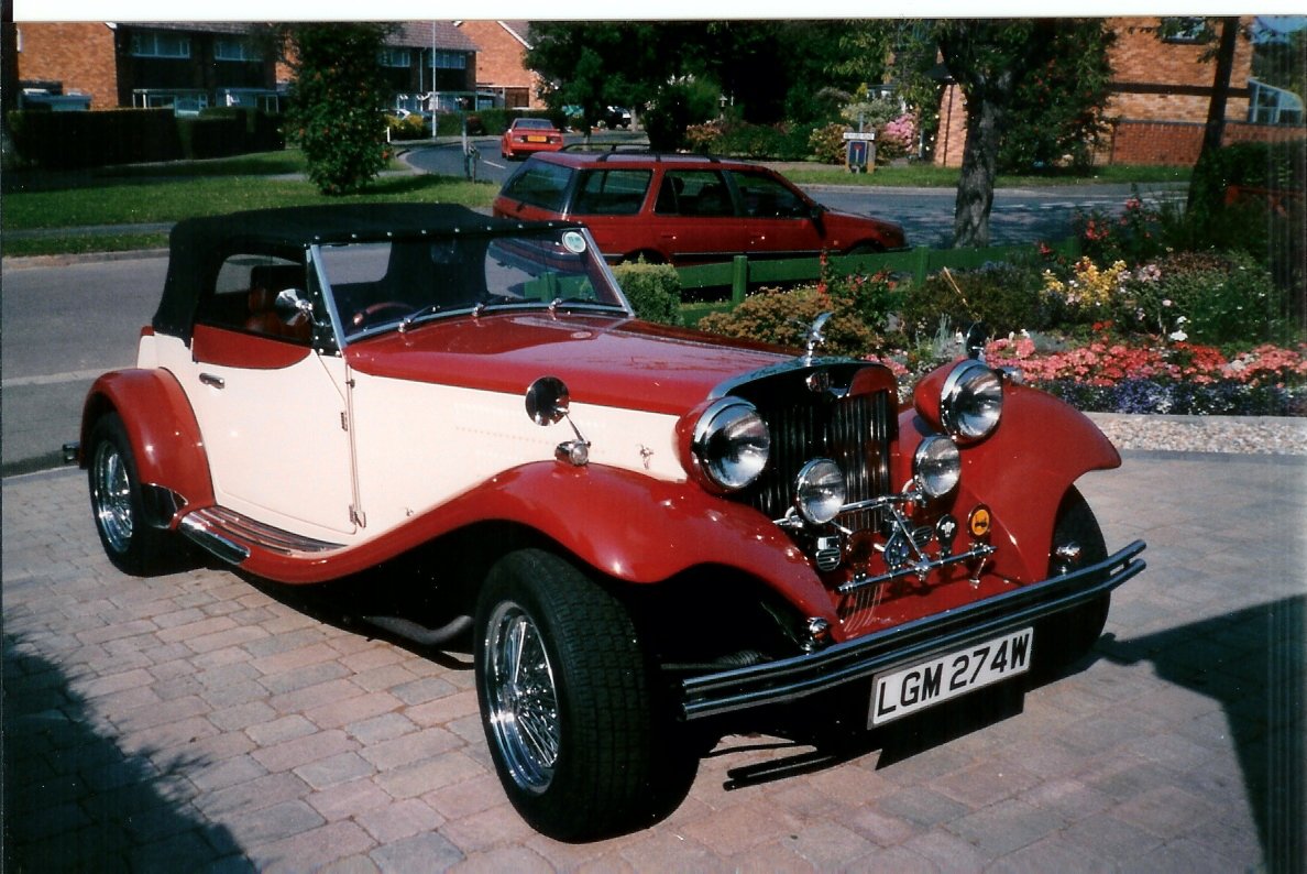

Thank you for your constructive advice, there is a lot to take in and I am in the cautious stage of this area, I might just use the OBD11 as a last resort. I did not order a RVC with my car at the recommendation of the dealer as I had ordered Park Assist that came with front sensors for not much more than just adding front sensors, also came with headlight washers as standard I think.
There is an old saying that a little knowledge is a dangerous thing, how true, I have built my own PC and have delved into the registry on occasion, so far it's still running fine :smile:. I did build my own car, a JBA Falcon in the early 1990's but due to two disabled relations arriving (Long Story :sad:) I got very little use after becoming a carer so had to sell it. It was a lot simpler to turn a Mk5 Ford Cortina into the JBA than do anything on a modern car!
