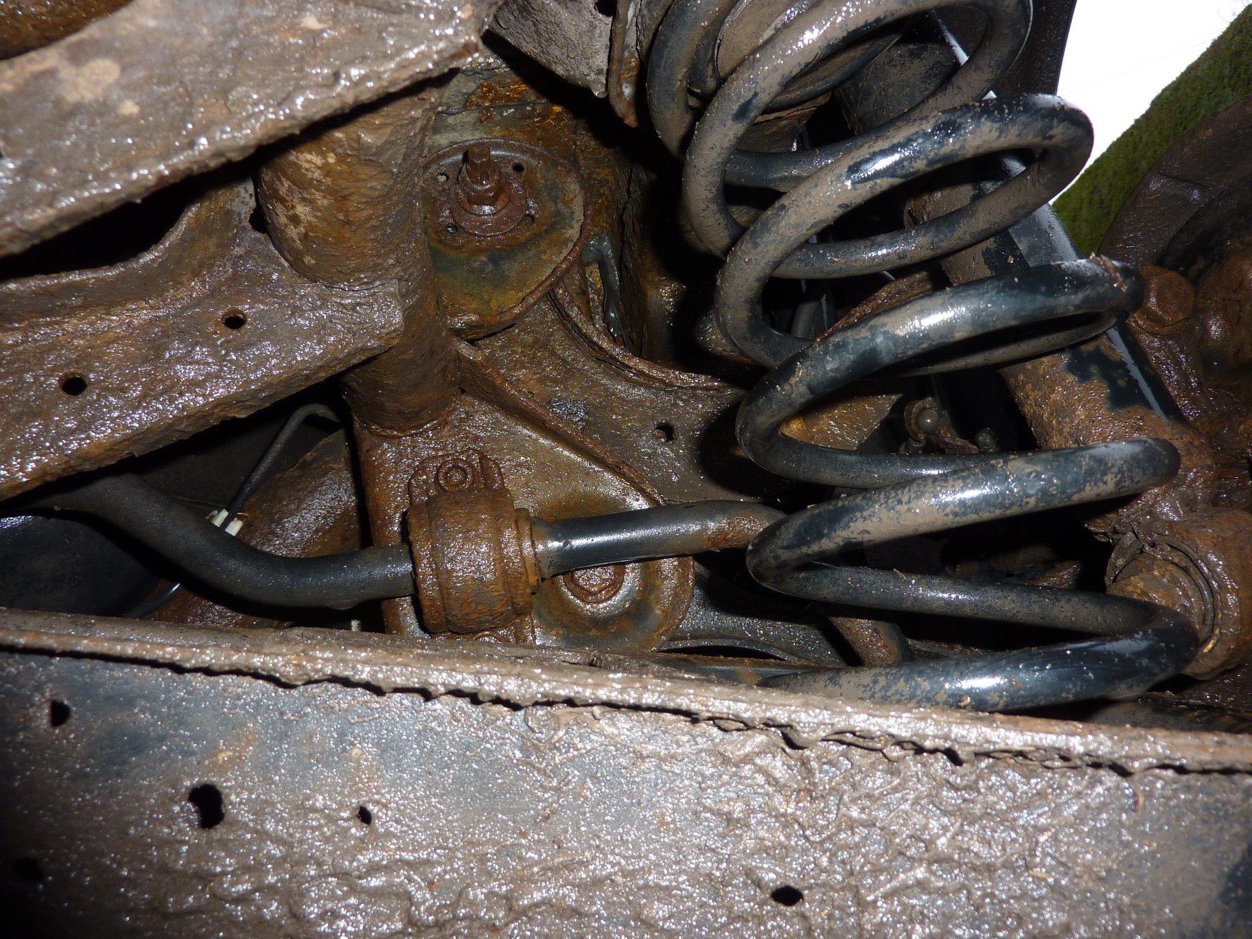

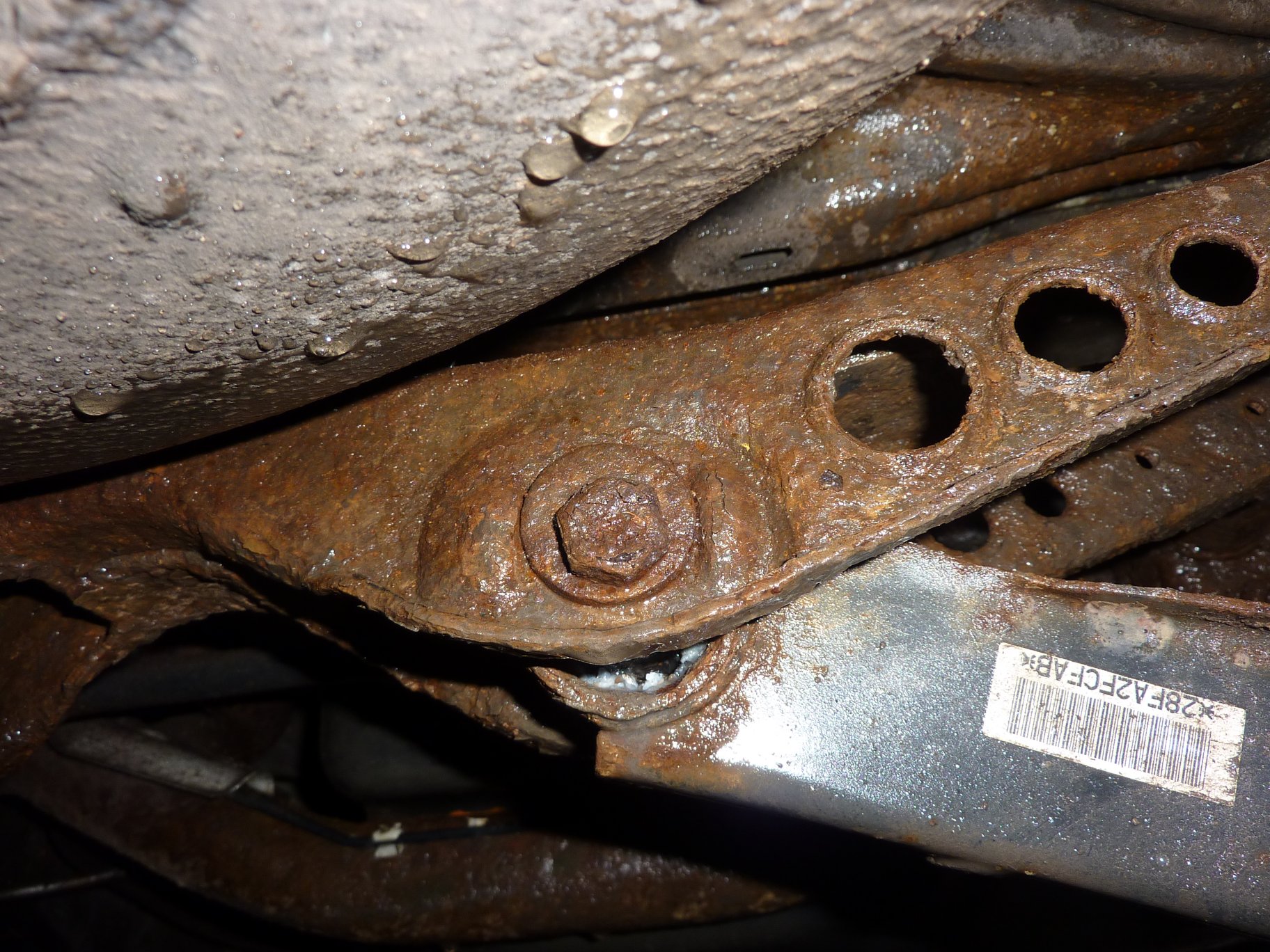

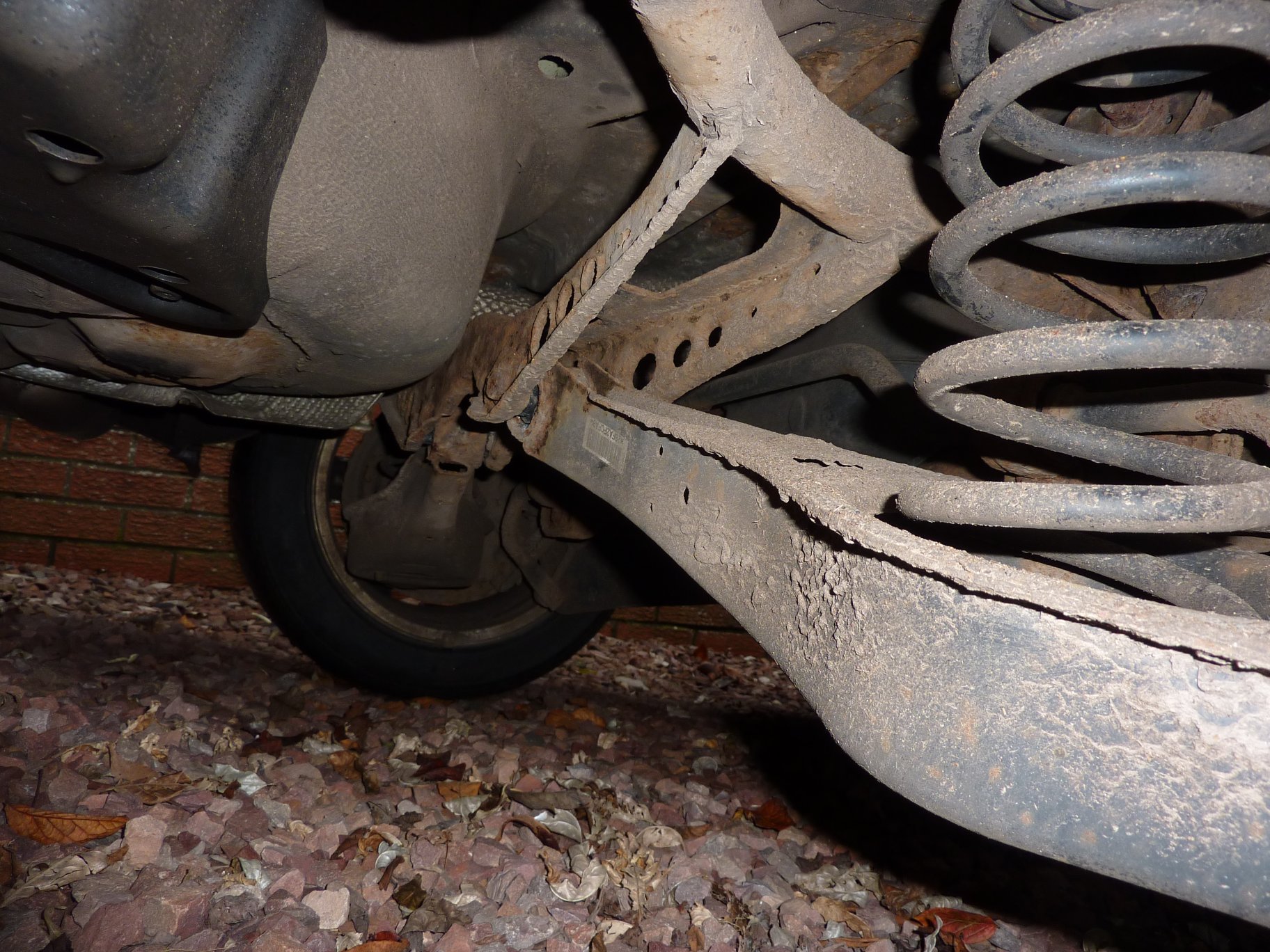

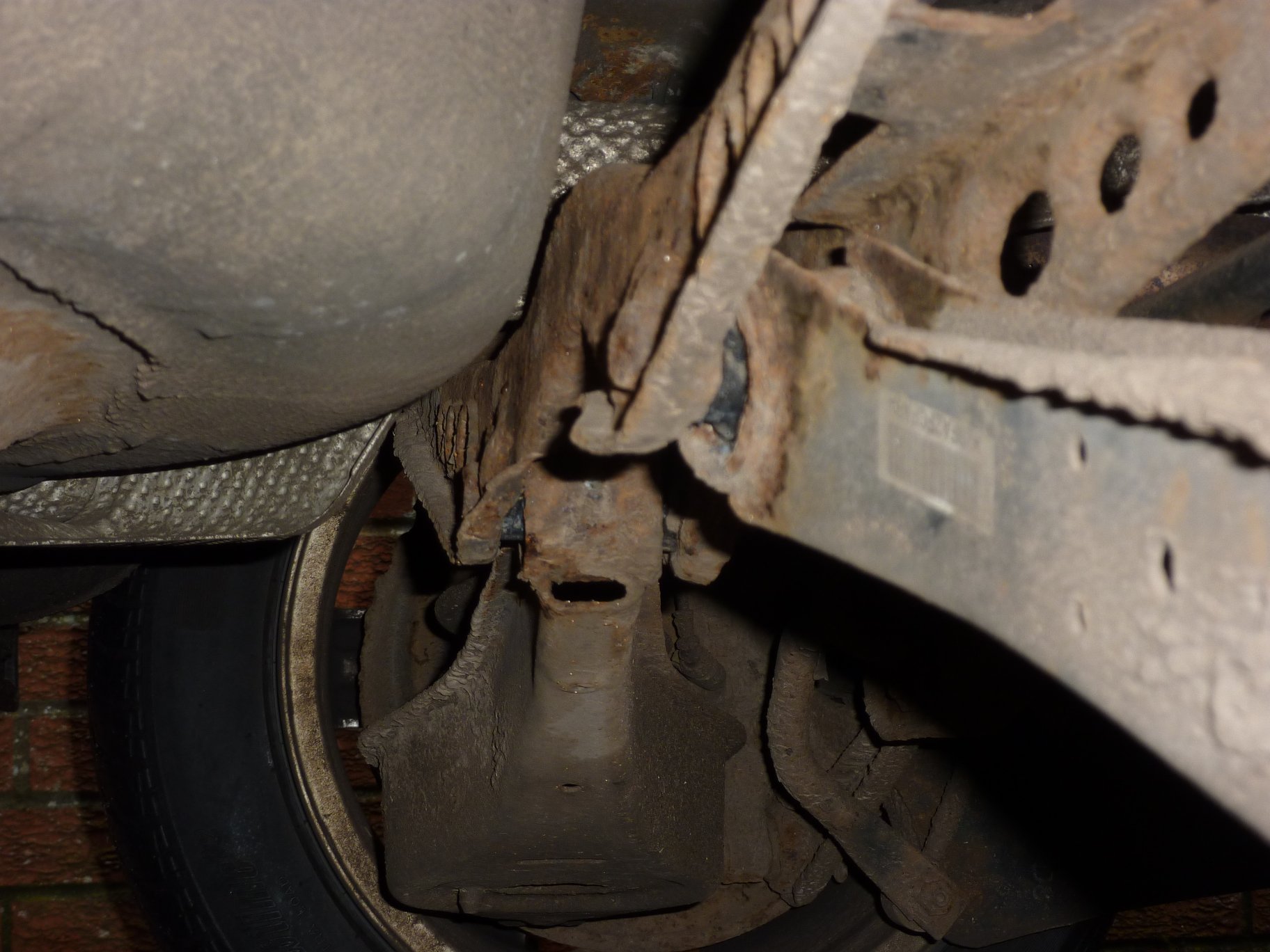

Well I finally decided to have a closer look.
To my inexperienced eye, the bushes in photo 1,2&3 look worn.
There is also the ARB bush, but I couldn't get a good photo.
The rear drop links were also difficult to see.
Are there any wiggle/lever test I can do to identify bits that might need replacing?
Thanks for any advice.
