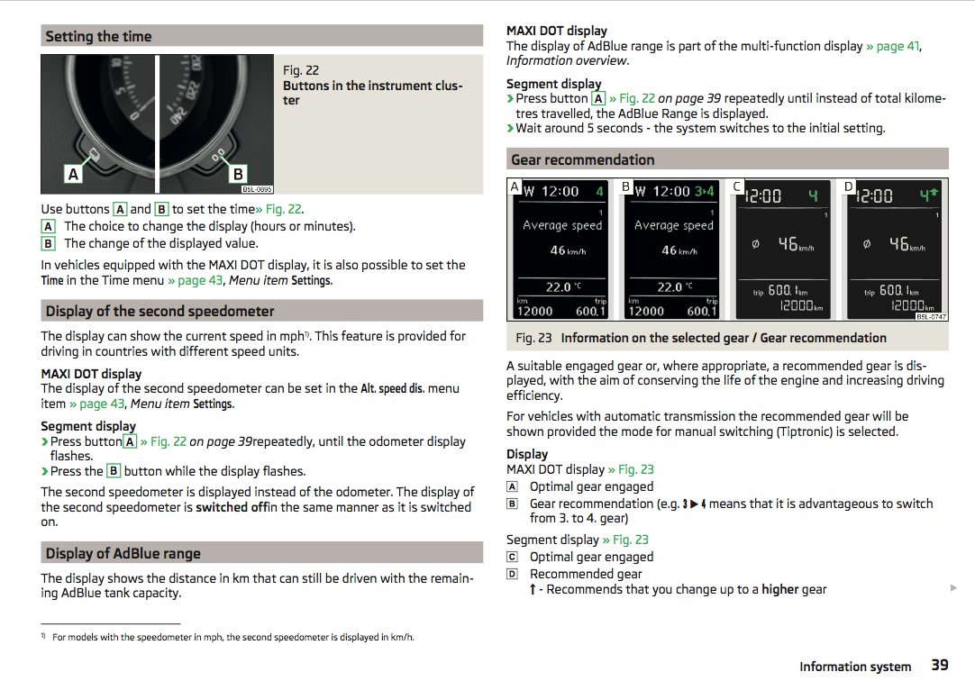

Is there a way to change the 'Second Speedometer Display' in the Maxi Dot?
I realise that it is set to KPH for when driving abroad, but can this be changed to MPH?
The manual is a bet confusing, referring to different sections of the manual, but without actually explaining how to change it.

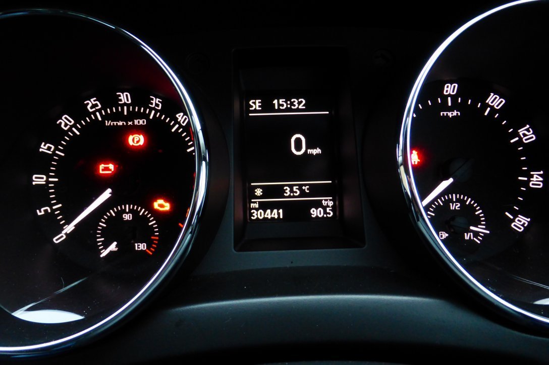

I have a slightly different requirement if its possible.
Living in France as I do I am quite happy with the standard UK setting of a MPH analogue speedometer and the km/h display in the maxidot, it is however very small, I have sight problems especially close up and its difficult to read sometimes.
I keep reading postings on the subject of "LARGE MPH display on maxidot" is there some VCDS coding where I could have the km/h digital display in larger font?
I dont mind if it has to be on a seperate display from the MFD info.
