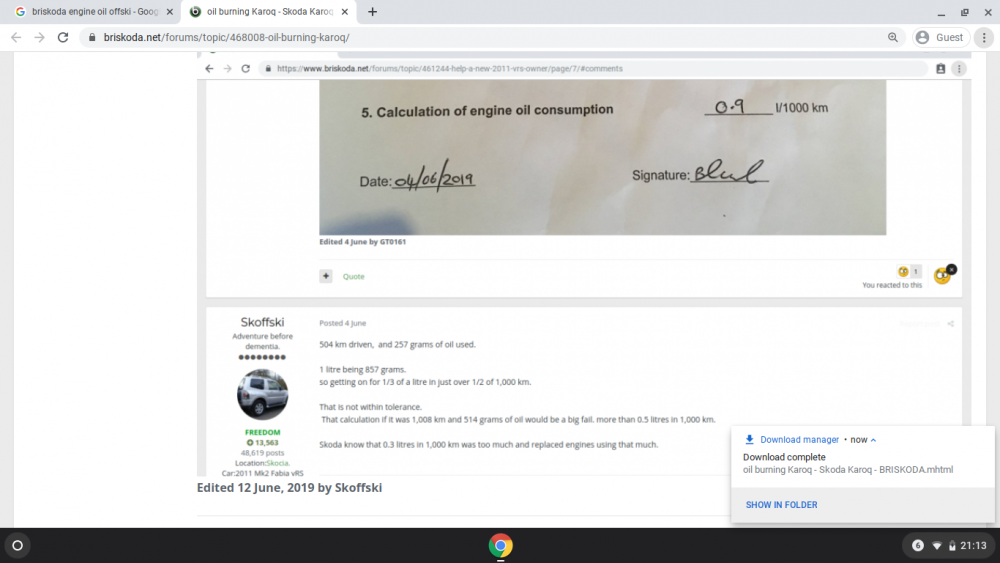

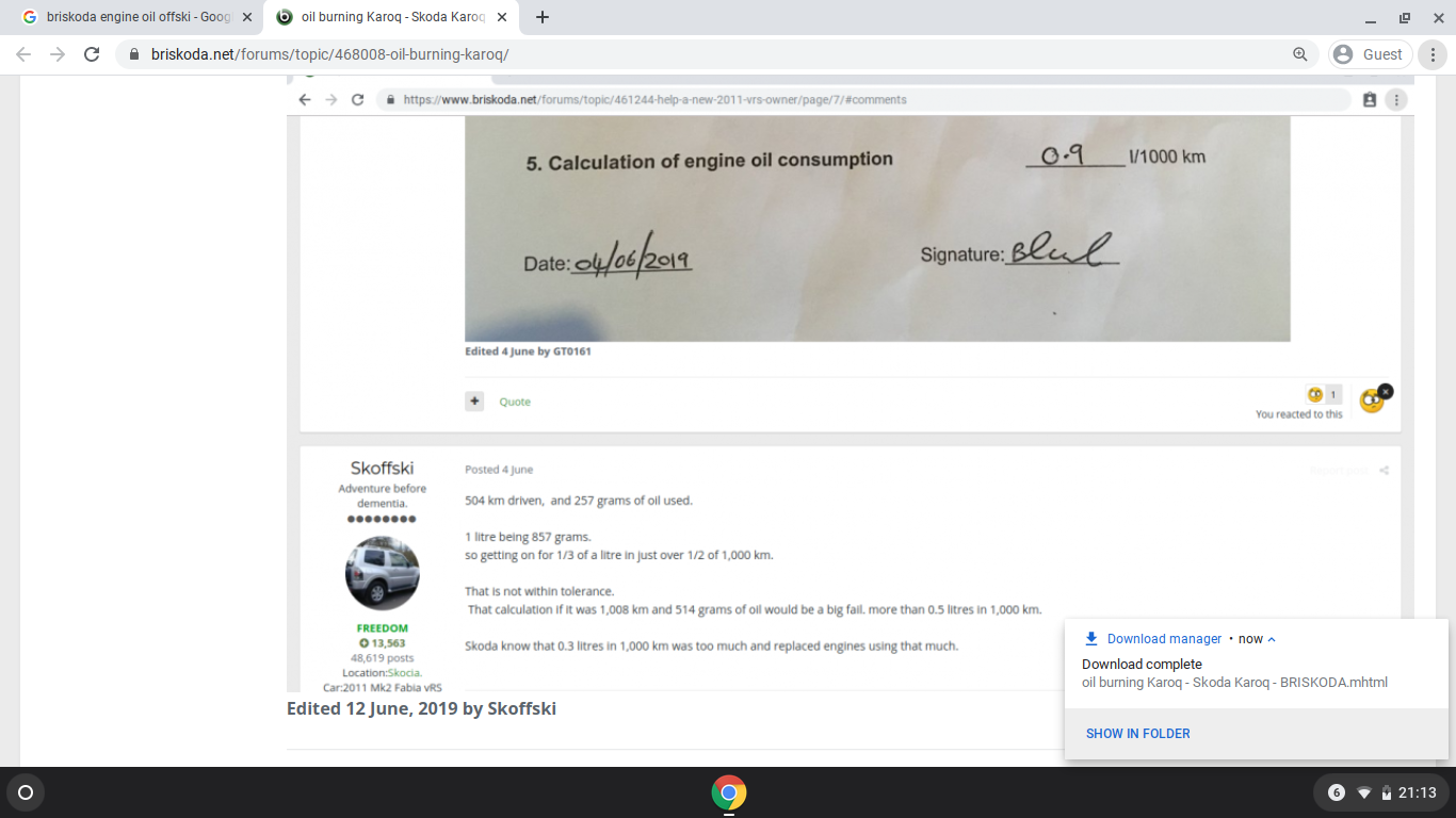

The Invoices / test results below were done wrongly. A litre of engine oil does not weigh 1,000 grams, and the first test meant the owner got a new engine.
The bottom test was also wrongly carried out by some muppet of a technician.
