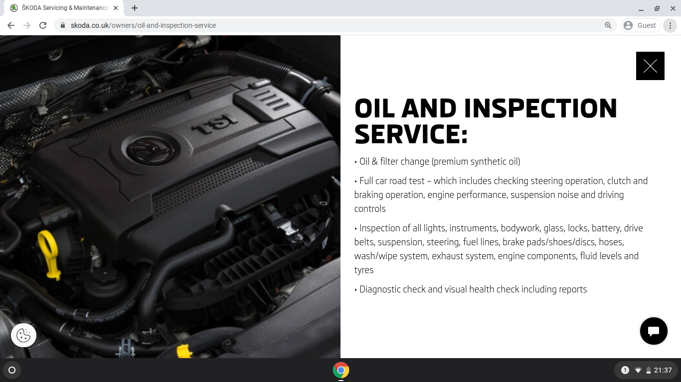

For a last few weeks when I turn on the engine it says "Oil service in X days". Wanted to book it online but when I go to web page I have the following options:
Recommended
- Skoda Manufacturer Major Service to Schedule (£214)
- Brake Fluid Change (£60)
- Complementary Health Check and Report (FREE)
Which of the above options equals "Oil service" ?

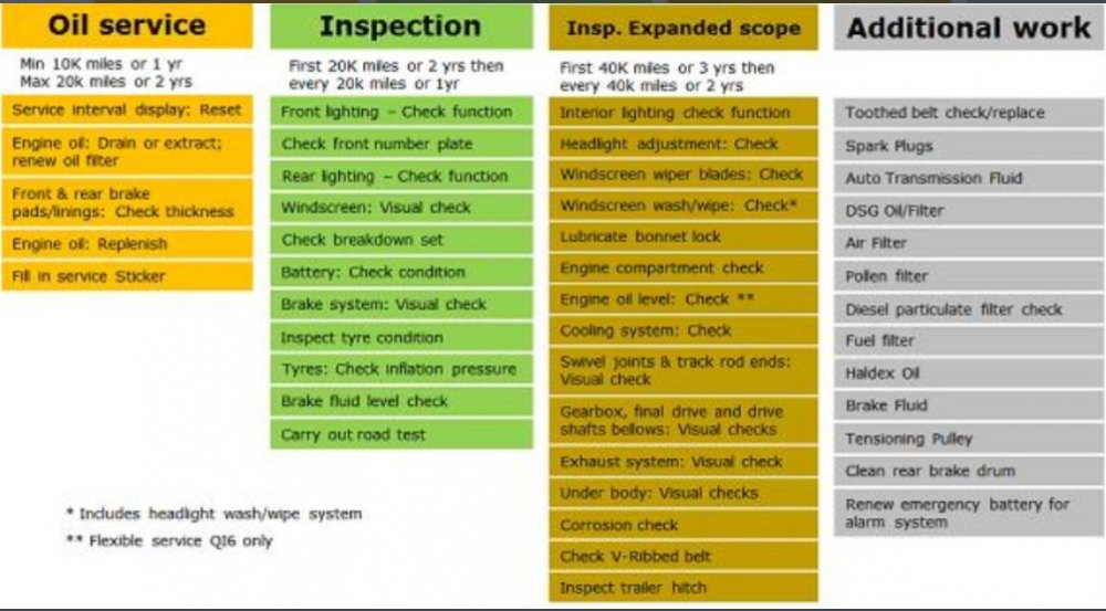

A 18 month - 24 month old car just needs an Oil & Inspection Service, even at 15,000 miles.
Nothing Major about the service.    Pollen Filter due at 2 years or sooner, but needs looking at to see if needing changed.
Then the Brake Fluid is @ 3 years.
If the car was put on Fixed Servicing @ the PDI that is 372 days / 9,400 miles.
From the Factory on Variable Servicing the Interval is 24 months / 18,000-20,000 miles.
The Services are now called 'OIl & Inspection services', Year 1 & 2, or 1st & 2nd Services & then Extended Scope & 3 years.
A pollen filter is the extra cost over and above the Service you need to pay.
This is at Participating Dealership, and is plenty expensive as it is.
 Interim & Major Services were stopped according to Skoda UK at the start of 2020.
