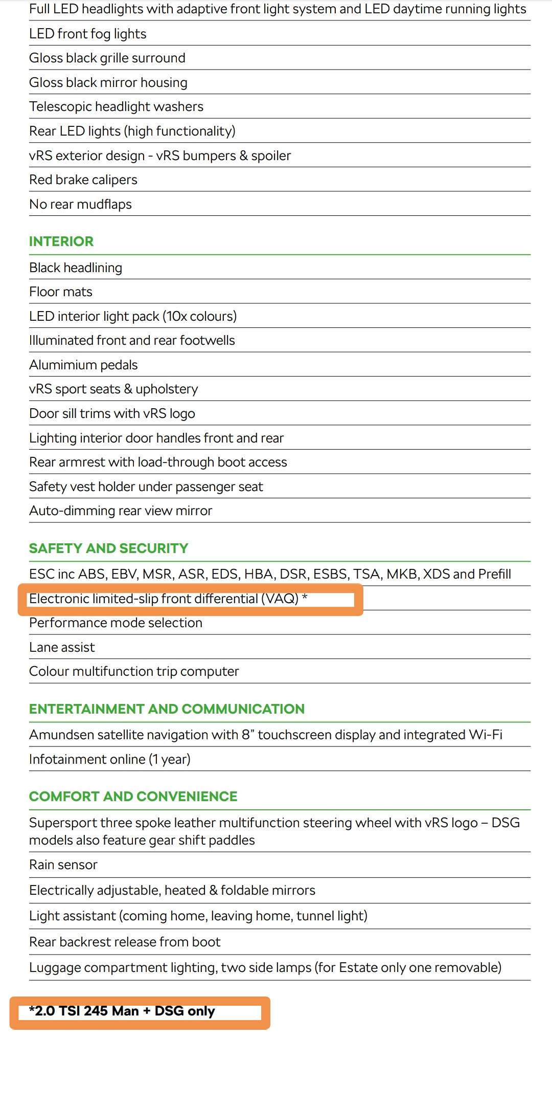

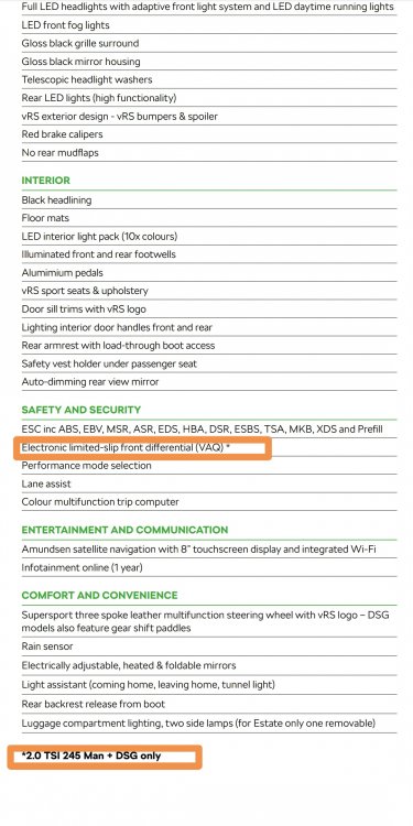

All 230s have the E-diff and is different to the 'electro-mechanical' VAQ diff.
Are you sure? I'm not sure that's 100% correct
The VAQ is an e-diff and is fitted to the 230 VRS as explained here : https://www.carthrottle.com/post/is-a-clever-diff-all-the-skoda-octavia-vrs-needed-for-greatness/
The final item on the 230 menu, however, looks like it might just do the trick: VW Group’s Vorderachsquersperre (or VAQ, if you find that a bit of a mouthful) front differential lock. It’s the same thing you’ll find in a Seat Leon ST Cupra or a VW Golf GTI with the Performance Pack installed, and it has a justified reputation for completely changing your perception of what’s possible in a front-wheel drive car.
It’s best thought of as one half of a Haldex four-wheel drive system, and is able to distribute power across the front axle as it sees fit. Anything up to 100 per cent can go to one wheel. Thanks to the Octavia’s more modest power output the VAQ isn’t quite as compelling as it is in the 276bhp Seat, but crikey, does it make a difference."
Edited by Maggle
That's the pre face lift as per my original post.
Sure, but you intimated that there was a difference between an e-diff and a VAQ when in fact they are one and the same!!!
So the e-diff or VAQ Is fitted to ALL Pre facelift 230's, some face lift 230's and ALL 245's to summarise.
