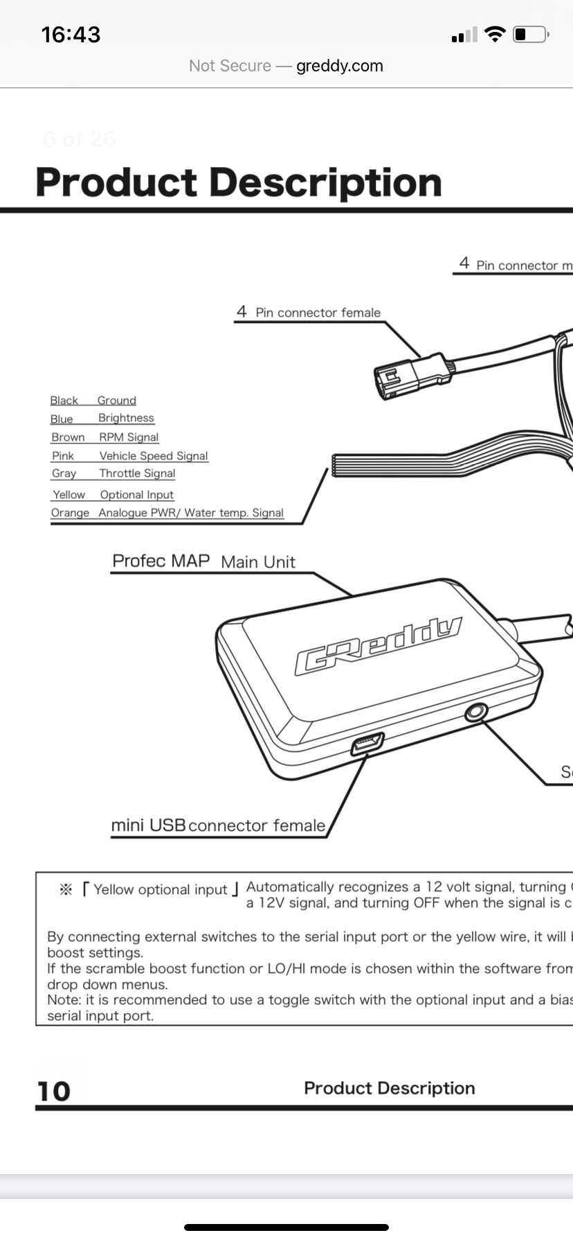

High guys I’ve bought a greddy Profec map adapter for my Fabia vrs im just wondering where you would get these signals from in the photo below cheers guys 😌😀38760CB9-60A3-427D-A102-D35DAB3407B3.thumb.png.aff90c5f70e0c226c7787fc5fe5ec087.png

I think you'll struggle with that. Vehicle speed signal will be a CAN message from the ABS module to any interested fellow modules. RPM similar from engine ecu, though you could maybe take it raw from the crank sensor, but not sure how.
Throttle signal, not sure whether that would be throttle pedal or throttle position, water temp will again be a CAN message from engine ECU to other modules.
I think things may have moved on too far since that was designed, unless I'm misunderstanding.
Wino is right, your new box doesn't say what kind of signal it wants, I'm guessing it's looking for analog square wave pulsetrains for RPM and vehicle speed and maybe a DC resistance value for throttle position.
But speculation is pointless because you'd have to tell the box in software what it was looking at in order to calibrate it.
