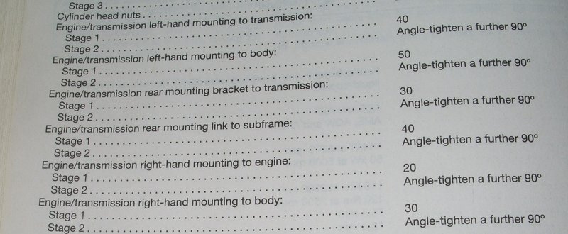

Here's what's in the Haynes manual. Torques in Nm as couldn't fit the full width of the page to show lbs ft....

That's great thanks so it looks like they are only 20nm and 90degrees doesn't seem like a lot 😁
They are meant to be replaced too but I reused mine and the engine hasn't fallen out yet :D

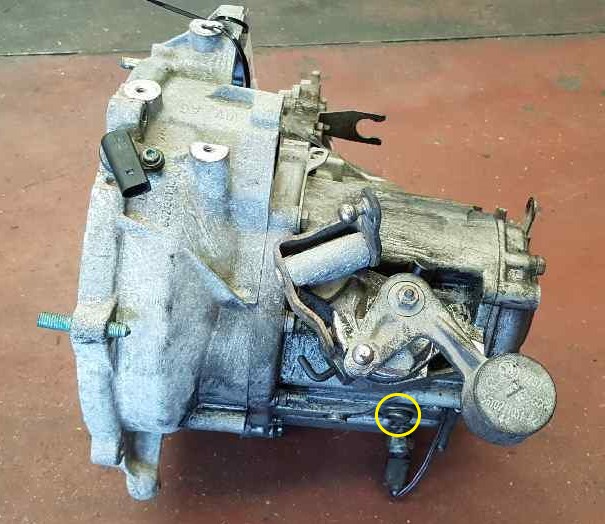

The gearbox oil level plug is 17mm hex. I used the head of a bolt to undo mine as didn't have a 17mm hex tool.
Level plug location...
