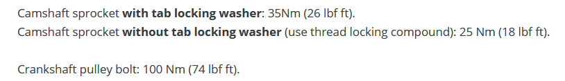

Here's the torque settings in case you need them...
That's great thanks, I do have a Haynes manual on order but royal mail delays mean I've had to start without it and rely on info I have found on here. I think I saw the crankshaft bolt has to be 100nm but will double check before refitting. It was a bugger to get off ended up lying on ground and using both feet against the rachet.  I'm guessing there will also be torque settings for sump bolts and will check these also. 😁

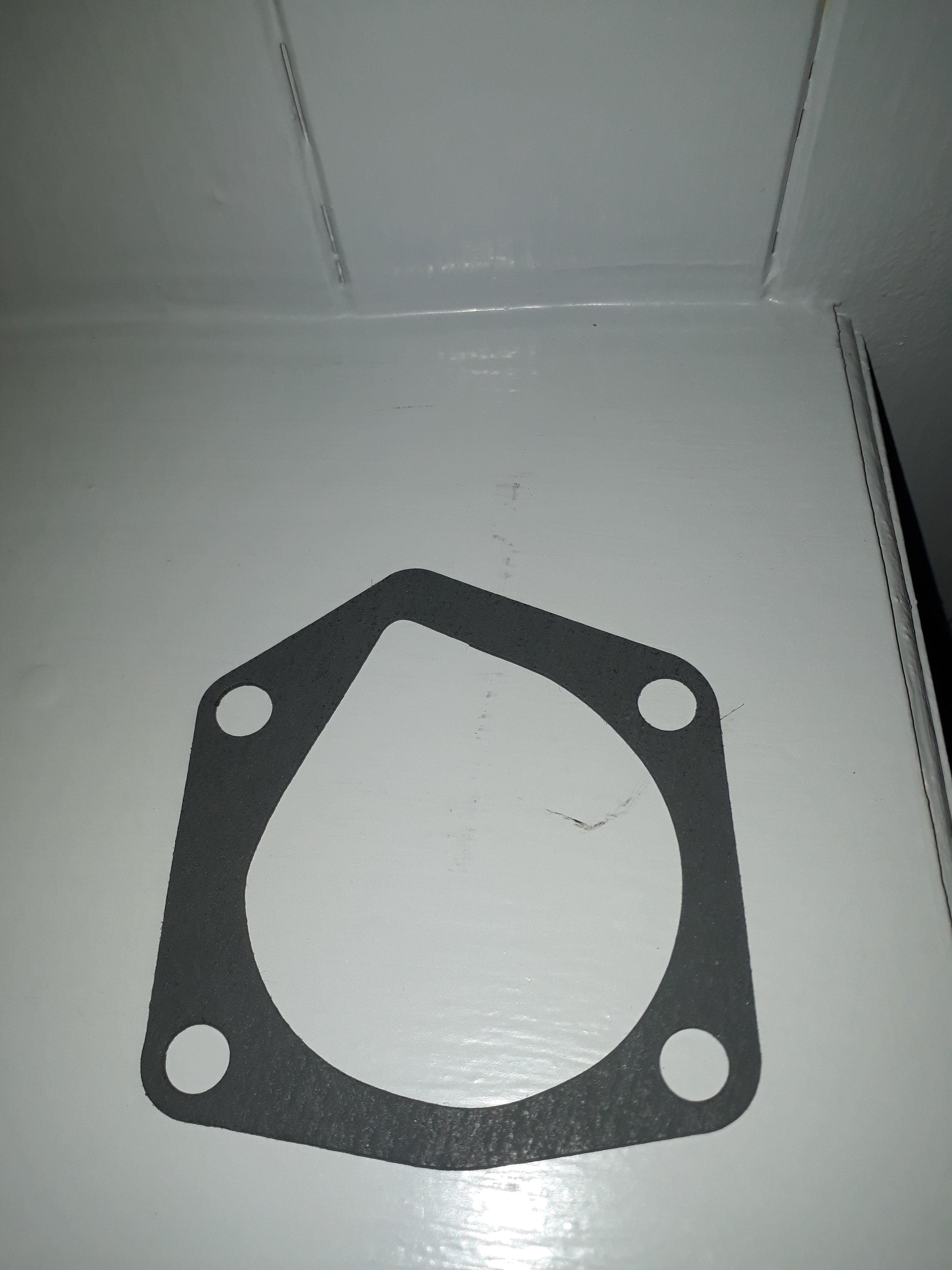

So I have managed to get the chain off now. In the kit I got it has a replacement crank oil seal but I can't work out how to get to the old one to remove it. Does the shaft with the pulley bolt need to slide out or does the seal surround this do you know. Also in kit are 2 silver thin metallic rings and another smaller paper gasket that I haven't worked out what these are for yet 😁 if u have any ideas please 😁

Thanks I just realised that the oil seal included fits into the timing chain cover so I have put that in. Just been trying to work out if the shims are needed I put both sprockets on and tried to use a metal rule across the face of both and they seem well aligned. Not sure if there is another method to do this. Looking at the kits available they don't appear to be included in all kits depending on manufacturer. I'm still waiting on the Haynes manual which might make things easier. Picture below of the gasket I'm not sure about if anyone has a clue might just be me being dumb lol 😂
That's the water pump gasket.
Part number 047 121 228
Edited by TMB
Ahhh thanks TMB is there any reason they would have included this or am I missing something? The water pump is driven off the aux belt so no need to remove it from what I can see? 😁 guessing it's maybe needed for a different variant. I noticed that the timing chain cover gasket they included is not quite right so am going to use a thin bead gasket silicone instead as have plenty of it anyway.
I don't know, it's a bit odd as there's no need to take the pump off, as you say. I wonder if it has to come off on models with A/C. Not sure.
Edited by TMB
