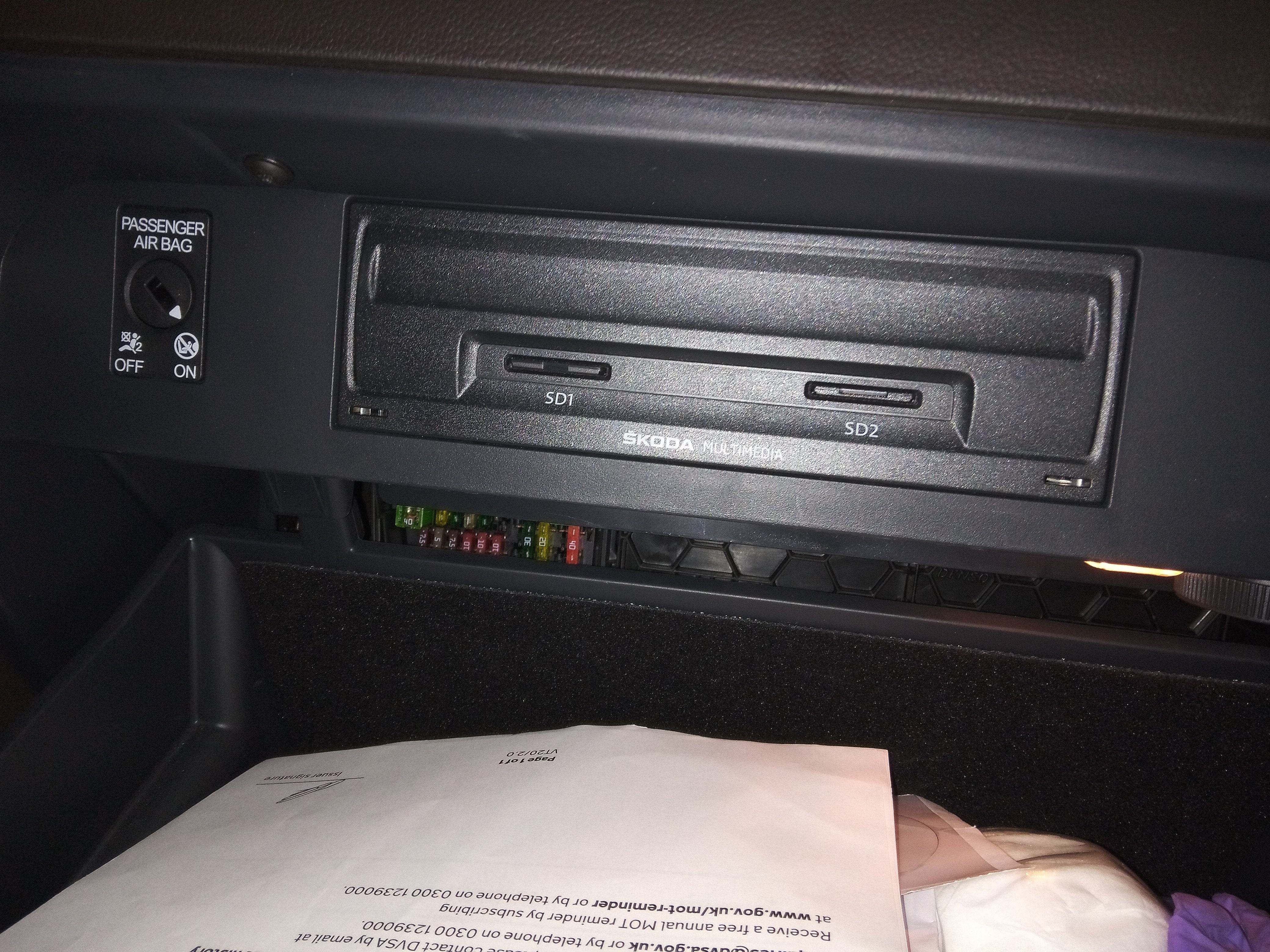

I have a small display screen, no CD slot (just 2 SD slots).

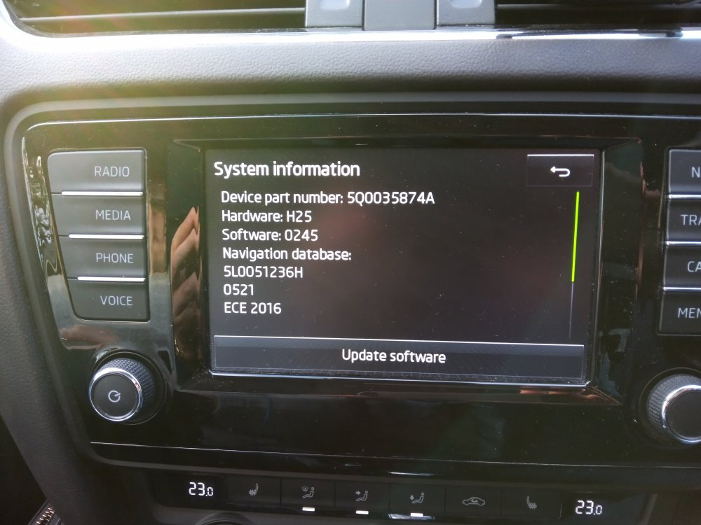

Feel free to post a picture of your headunit, that'll help people identify it and give better advice...

Here it is, thanks.
Pretty sure that's an Amundsen, I think the latest software for that version is 0253. Not sure what changes there are or if it'll help your issues.
Amundsen maps need to be on an original Skoda SD card, despite the Skoda site claiming a 32GB card is required for the Europe wide maps, they will still fit on a 16GB card :)
