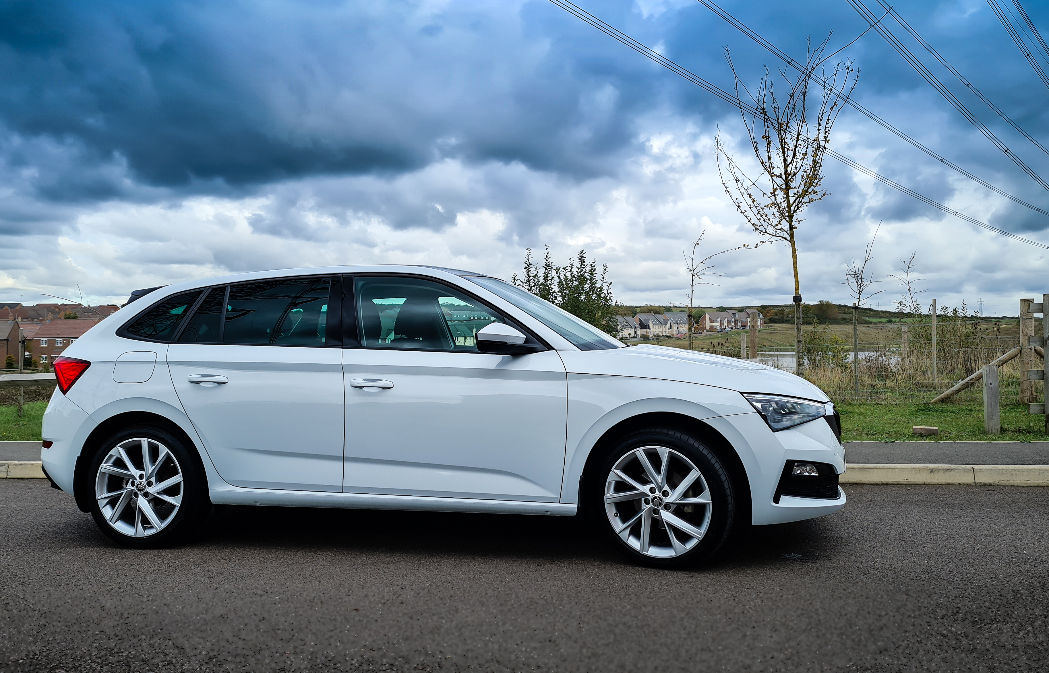

Personally I would keep those alloys as they are as they really suit the body colour. Black wheels on a white car looks a bit naff IMHO.
They are very nice alloys and you are right they do suit the body colour.  I go back and forth - a lot.  I almost went for the Vega Aero that come standard with the Monte Carlo Trim, but I am so glad that I didn't as the Monte Carlo has become very popular across Europe on social media and therefore instead of looking impressive they look a bit 'common'.
Maybe I should wait until its lowered first before deciding on the alloys.  The silver looks great, but I also think due to the angles in the spokes a good gloss black could really pop and make it look quite individual. Choices choices.
