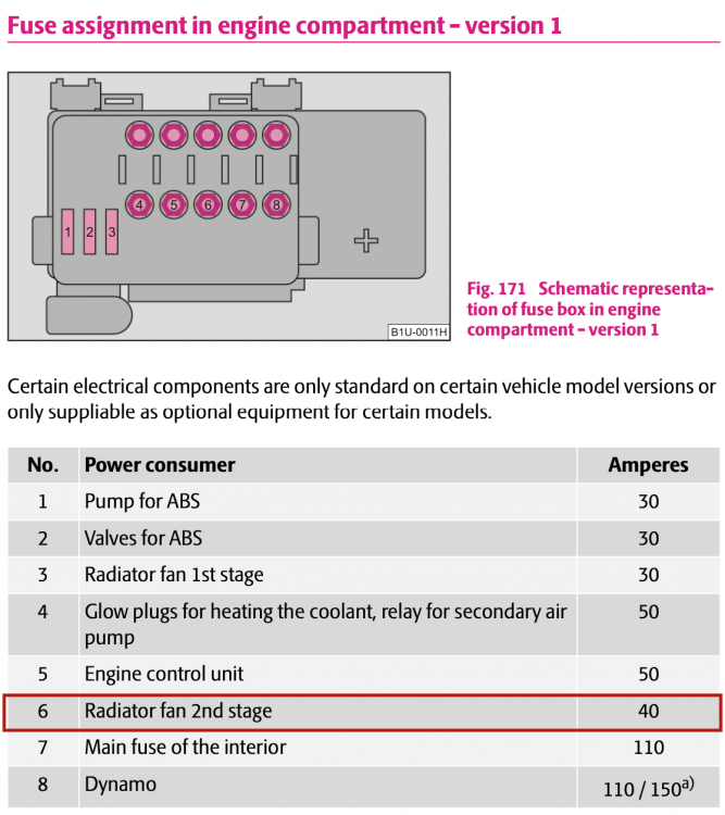

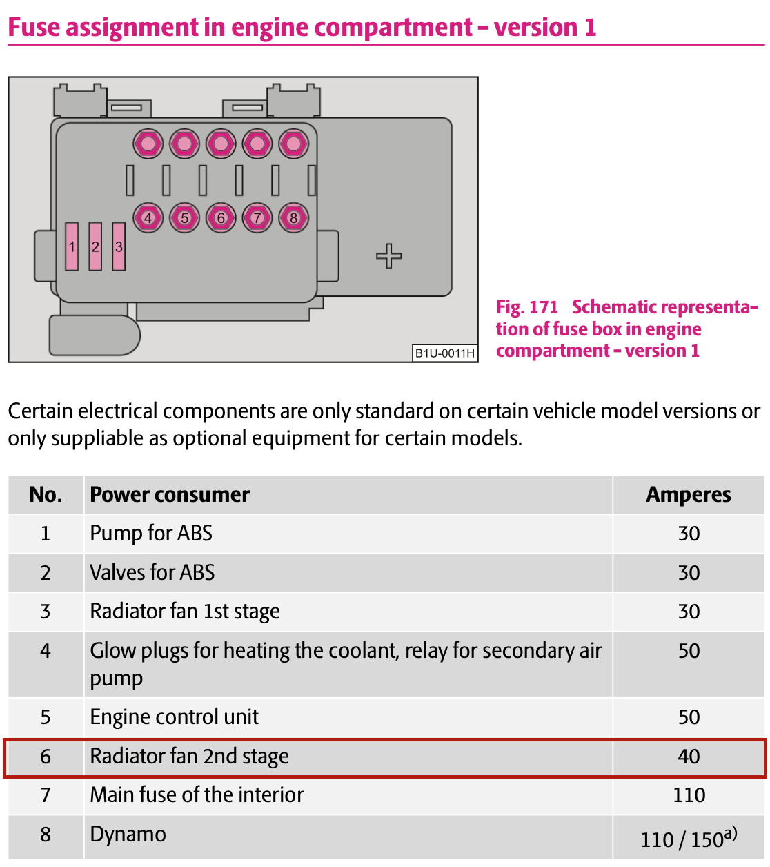

Thank you everyone for your help. My issue resolved by cleaning the fuse located above the battery. Radiator Fan 2nd Stage terminal fuse has caught a lot of carbon and was getting neglected all the while. I cleaned it's terminals and now engine is appropriately maintaining the optimal functioning temperature. Found no coolant leak. I was loosing coolant through overflow spillway of expansion tank due to excessive boiling of coolant and water, cause of non-functioning radiator fan (2nd Stage).
I hope this helps someone in need.
I have attached Schematic representation of fuse box in engine compartment for reference.
