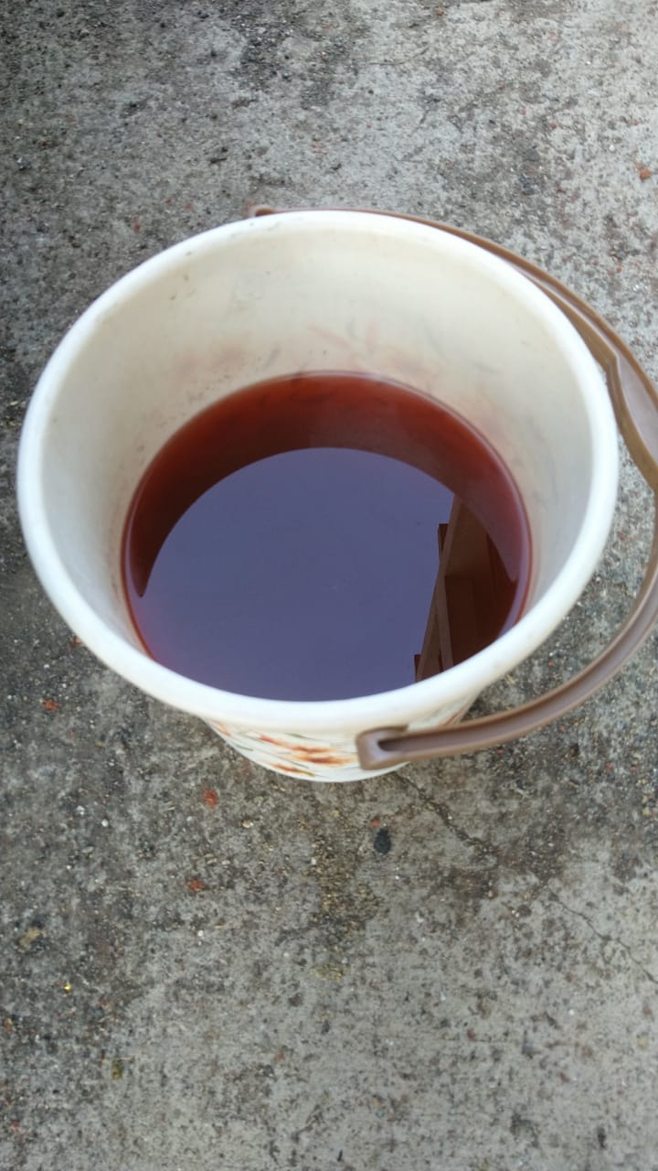

I flushed the coolant and changed it again with G12 coolant.....it's not overheating as of now but I have run the car on city roads only after flushing the coolant yesterday.
Attaching a pic of the drained coolant for your ref.

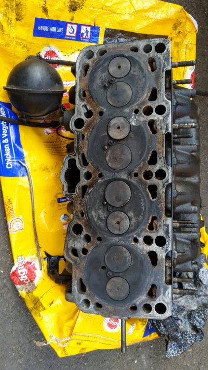

Also attaching a pic of the engine head which was taken during the HG change.

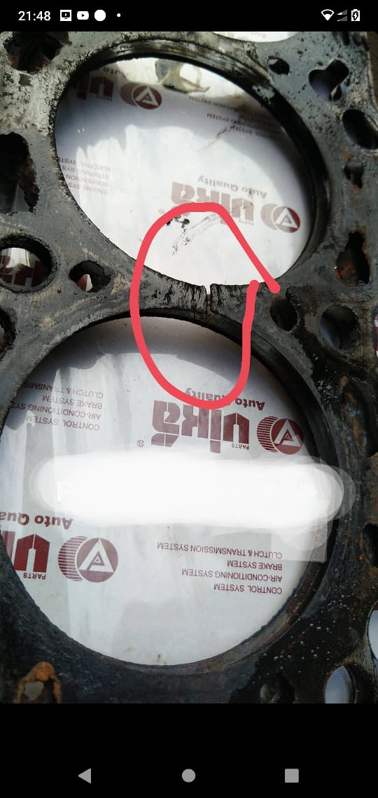

When you changed the gasket, what was your find? Was the gasket blown or not?
Have you checked whether the engine head or block has warpage?

I had checked the cylinder head for straightness and it was proper (I don't know the exact terms for these but since I was on a budget I did all these jobs myself) .
Before installing the head, I had cleaned all the oil, coolant passages.
And yes the old HG was damaged. Attaching a pic for your ref.
