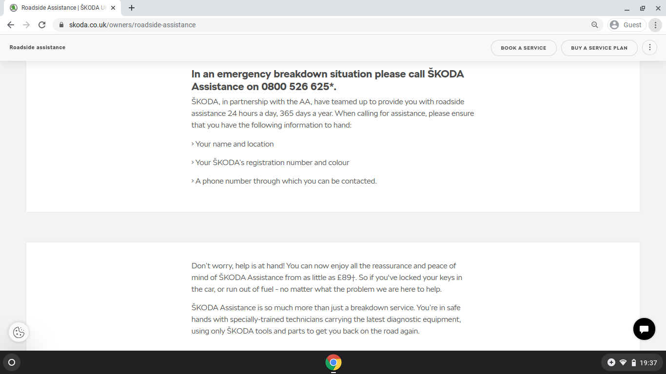

@DSLNot exactly SKODA coming out to you,
but the AA operative if you leave the battery flat if that is going to happen.

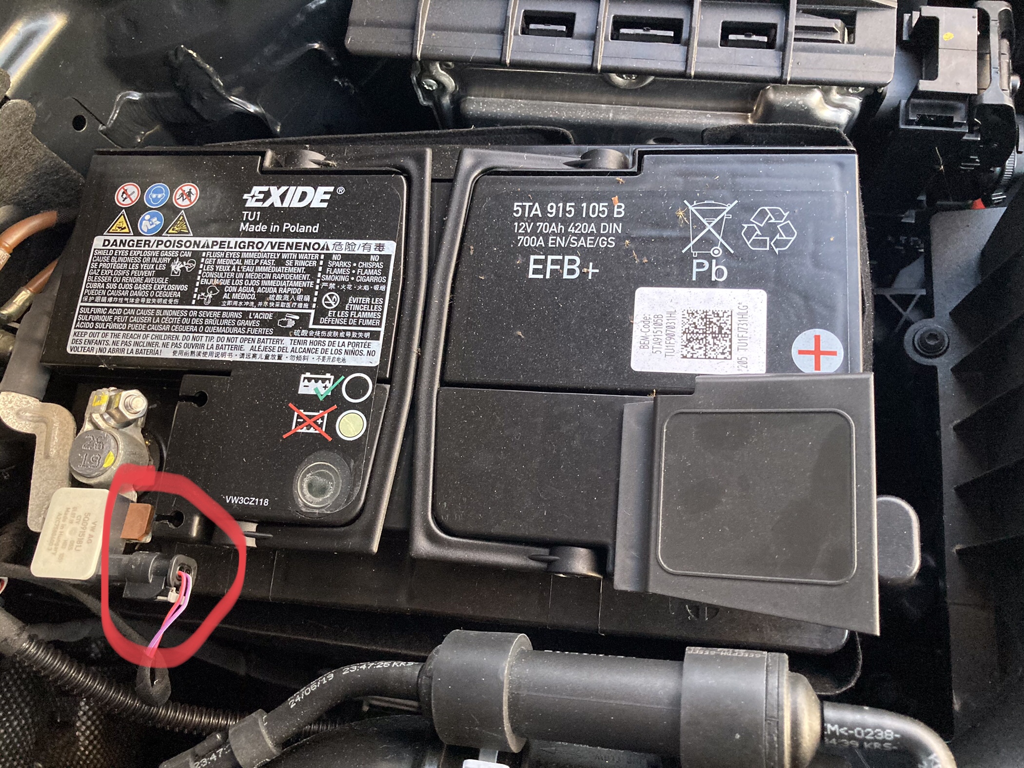

Interesting read, esp re disconnecting the SS sensor.  Not quite brave enough to try that yet but is this the cable that would need disconnected?  Don’t suppose just switching it off religiously achieves the same?

I agree - I'd be reluctant to try disconnecting the SS sensor. Haven't given our under bonnet area anything more than a cursory glance since we took delivery, so haven't investigated the battery negative terminal set-up fully. But it would look as though the bit you have marked would be it - I think all it does is decide if charge being generated needs to go into the battery or not, so logically it would be the final 'switch' in the circuit going back to the negative terminal.
As to switching SS off religiously, I would think that would only stop the engine shutting down (when SS conditions would support) but the sensor would still be active in determining whether or not to charge the battery - and presumably it would still be seeking to only allow a charge to c.12.5V level. I'd leave SS on and see what happens. If the battery is on the way out, then I'd think the SS system would rarely kick in as it would be trying to keep the battery charged up, and if it does start operating then that would indicate things are relatively OK. I can't give examples from our car as its petrol and as yours is diesel then the SS set up parameters probably are not identical - for example the SS on ours will start working after just a few minutes / half a mile distance and that may not be how things should happen on the diesel.
