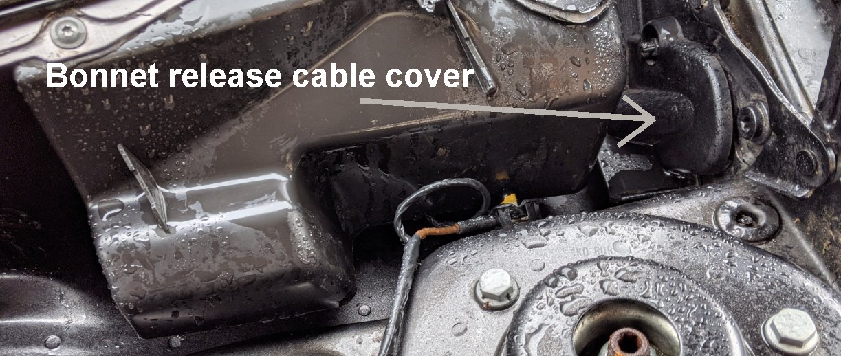

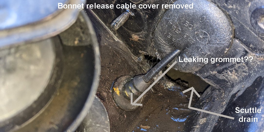

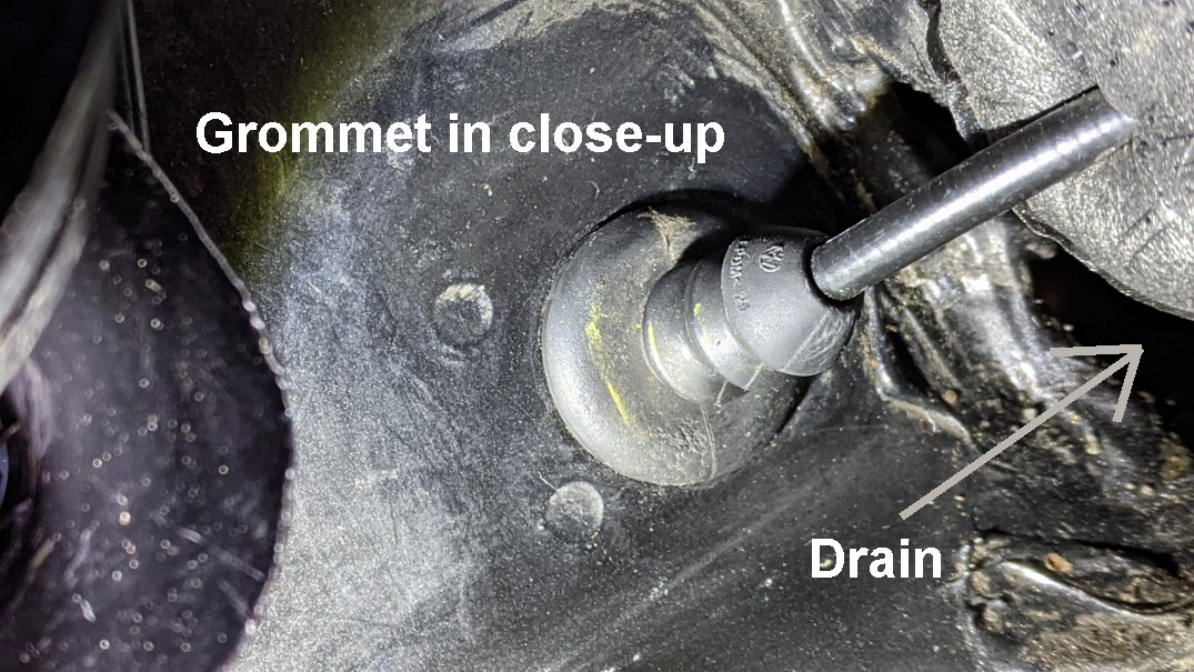

I think I might have found the source of the water leak into the passenger footwell, so I'm  publishing this post ahead of claiming my discovery/fix as final - in the hope it might help both of you as well as others. :notme:
I removed the scuttle covers and set about clearing the scuttle drains. I noticed that on the right hand end of the scuttle (right hand facing the car with bonnet up) there was a cover over where the bonnet release cable comes up through the scuttle - right next to next to the scuttle drain. There's an EDPM rubber grommet on the surface of the scuttle just above the line that draining water would follow. I've concluded this grommet is the source of my water leak, and have applied aliberal quantity of silicone sealant round the mating surface with the car. In a couple of days I'll check to see how well the silicone has adhered. If it's not good, then I'll buy some polyurethane caulk and use that. I've posted some pics of the part in question. I hope they help.

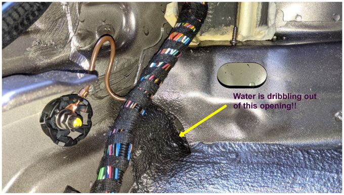

So, after a month has elapsed, I finally located and (I believe) fixed the rain water ingress. Despite my expectations that a leaky grommet in what Skoda call the "cross panel water box" at the base of the screen was the cause, it was a leak in the windscreen seal somewhere down the right hand side. This was sealed off over a week ago and as of the time of writing there has been no more water ingress.
What had me confused was the point at which the water was appearing in the passenger footwell. It's shown in the picture but I still can't see how it got there from the windscreen as none of the metalwork above it was wet. Still, I hope it's now fixed and if after the next significant rainfall there's still no water ingress, the carpets and the now dry noise-deadening layer can go back.1802471397_Waterappearshere.jpg.201f77474c4822192a346bca8878cdd5.jpg

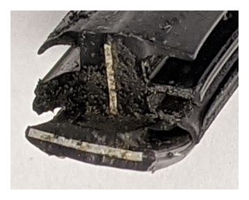

BTW, I'm also attaching an image of the right-hand roof channel seal, which I removed as part of the investigation. One member described it as being like held in by a windscreen wiper rubber-like seal, and you can see from the second attached image that's a very good description! The seal is held in the physical channel simply by the grip of the profile, but mine now has a touch of rubberised sealant to hold that one in place now.1889805601_Endonviewofroofchannelseal.jpg.432f1b3ff1d791d1a75a8d9eb5c642fe.jpg
