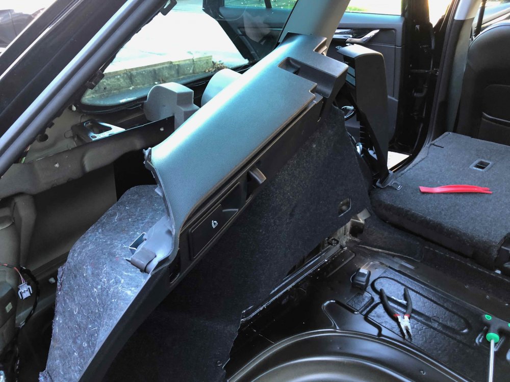

Thanks. Today I managed to get the trim by the load lip as well as everything on the boot floor out. Took out all the visible screws on the side walls. There's quite a bit to go -- the side luggage compartment trim panels needs to come off, which seems to require taking the back seats off. I am unable to figure out how to remove the hard top variable floor. More tomorrow.

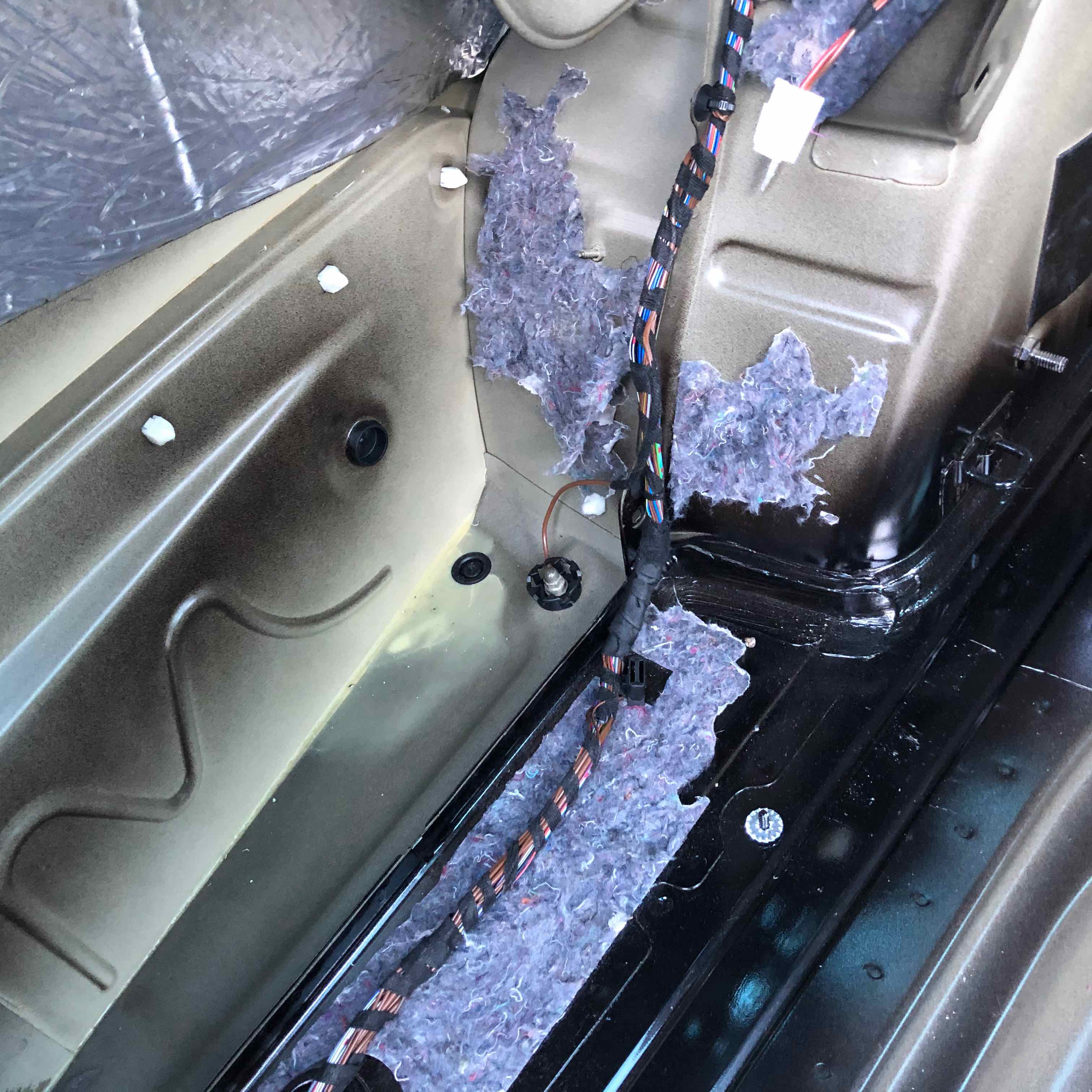

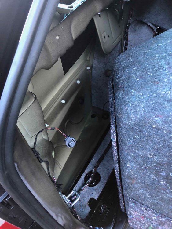

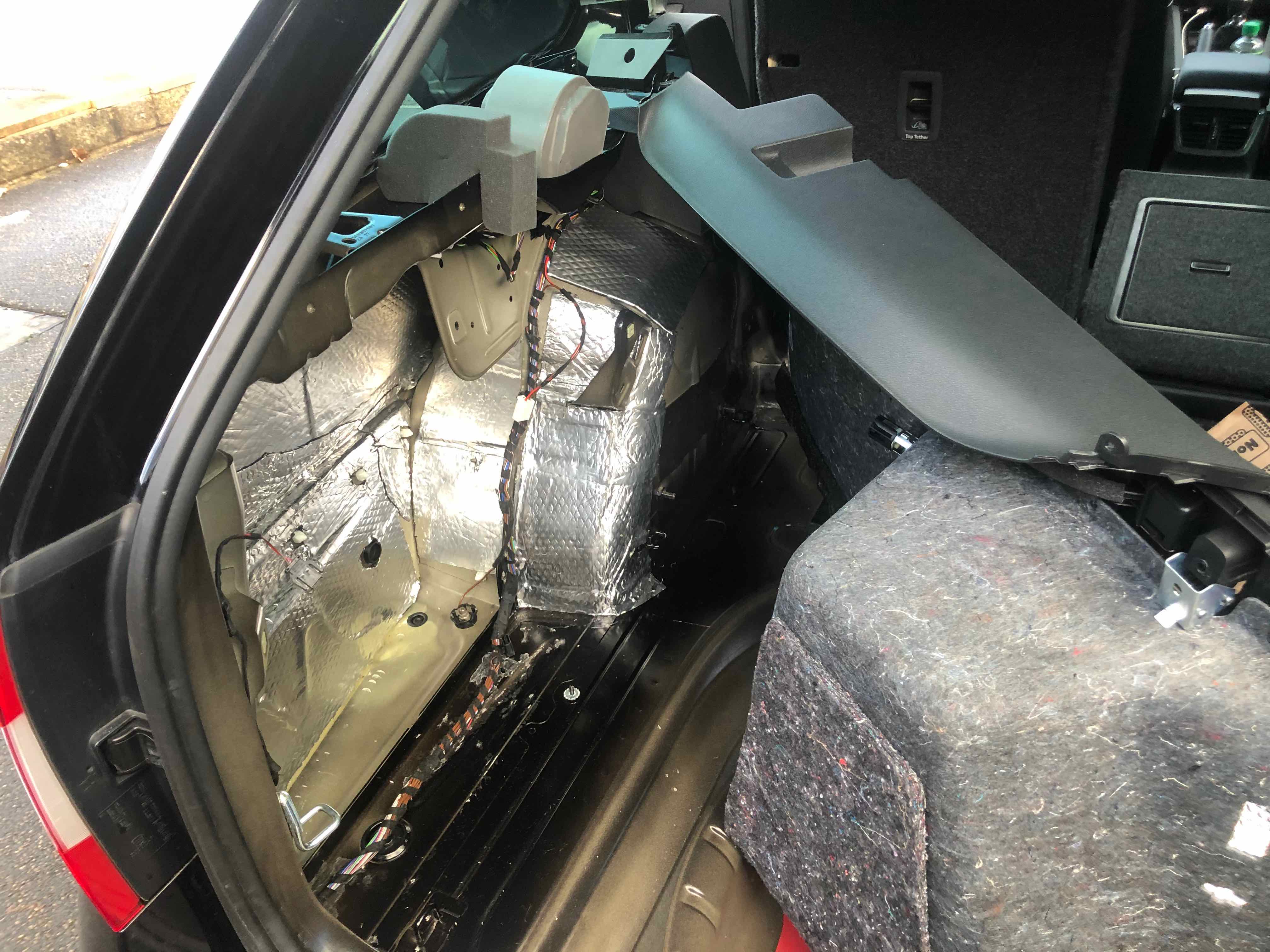

OK. So, you need to get the side trims off (both floor and roof) before you can pull the lining out enough to apply the deadening. Removing the variable boot floor is not intuitive. You need to first unscrew the VBF from the shaft that it is attached to, which in turn is connected to the hinges which are attached to the side luggage compartment trim panels. The boot roller blind can be taken off by depressing a spring button at the ends. Good lord, trying to figure out how to remove it was a real pain in the a**e.

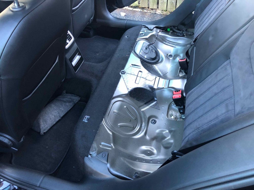

Removing the seat bench required quite a bit of wrestling and the grommets don't work now -- so have to order a new set. Warning for anyone wanting to remove the seat bench -- have a spare set of grommets ready before you take it off.
The worst bit was removing that silly felt that Skoda thinks is sound insulation. Removing it was a real pain as it stuck with this gunky glue that wouldn't come off with WD 40 or natural spirit. Didn't want to try solvents on it. So did my best to expose the panels by scrubbing with plastic brush, a gentle scourer, cloth, even my fingers and dried it off before applying the sound deadening.

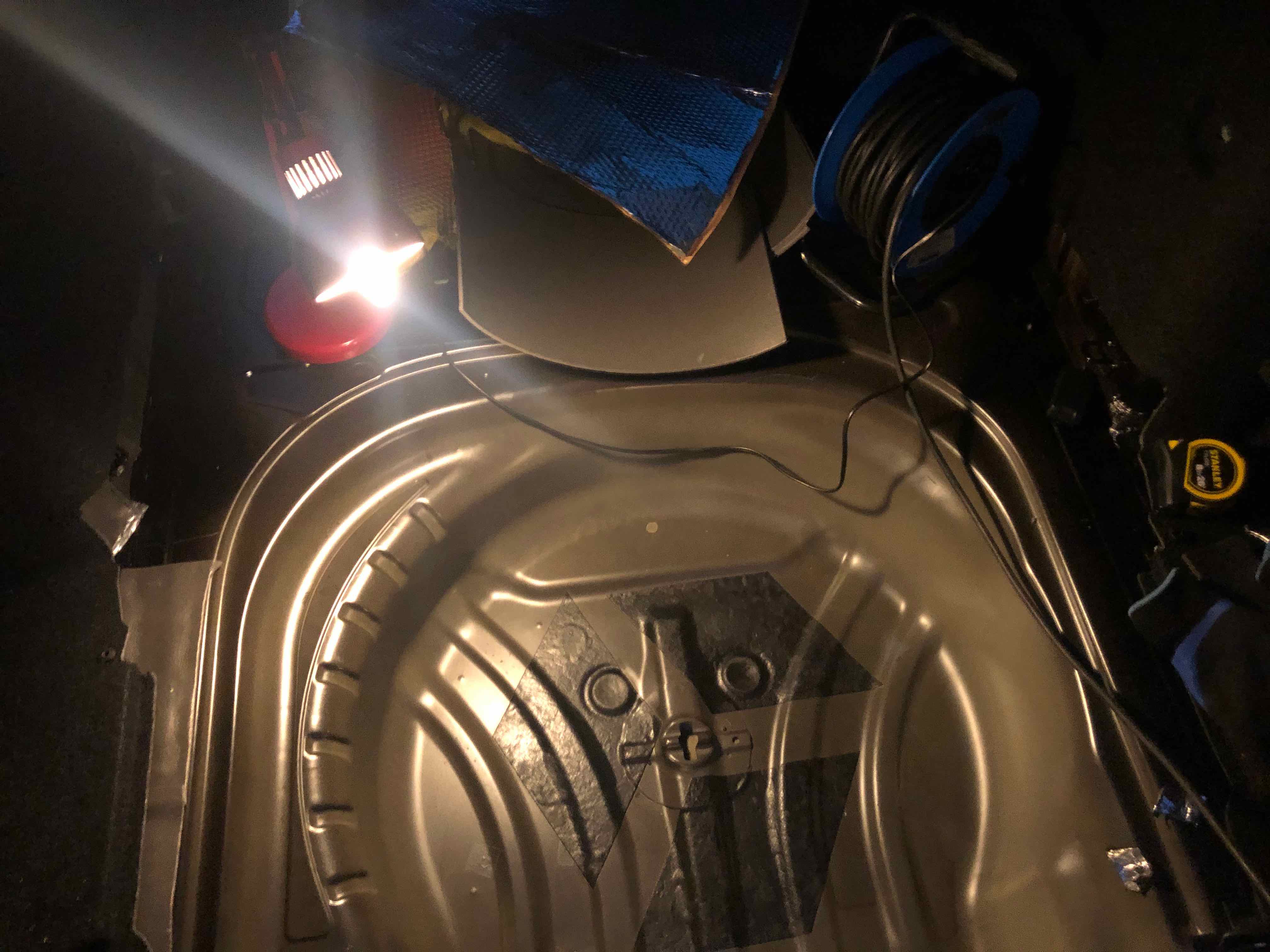

So today I got as far as deadening + insulating left wheel arch and rear seat. Was also able to fully deaden boot floor. I've run out of insulation so more is on order. Tomorrow I take off the other side trim and lining and get on with it.

OK. So done with it. Apologies no pictures as it was tipping it and early darkness meant I had to work at breakneck speed. Finished at 9pm finally. Made some rookie mistakes such as not factoring in tolerances for the variable boot floor and the bottom trim, which I will rectify in the spring/summer. But seriously, the parts used in these cars are just really flimsy.
So, lessons:
a) this is a job for spring or summer when you have a lot of light or else if you have a spacious and well lit garage.
b) make sure you mark out where the trims go and do not apply the treatment to those areas -- or at least do not apply the insulation.
What people are most interested in knowing -- is it worth the effort?
The noise from the rear is significanty reduced. Of course, there will be the low frequency noise that the tyres generate from certain tarmac that cannot be eliminated, but signifiant drop in the mid and higher frequency noise.
The noise now comes from the front and middle section of the car, which I will taking care of next. But already the stock stereo sounds much better and this is despite all the boom coming from the car doors.

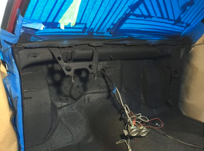

I have been deadening my last 3 cars with the same material.
But with my new Octavia I thought of using  some spray on deadener first,let it dry then apply the "normal"deadener.
Not my car in the pic!

2 minutes ago, hansen1 said:
@makemywish
Good job!

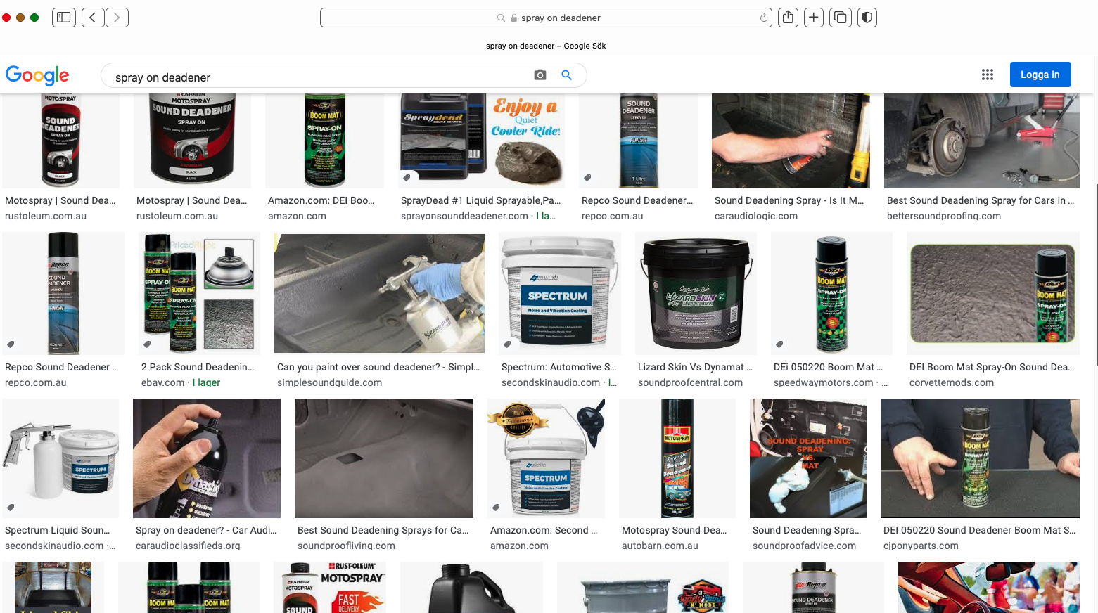

What make is the spray on insulation? And how thick is the coat? As I was applying the deadening I was wondering if I should have just gotten rubberised paint and painted it on the panels.

@makemywish
There are some out there:biggrin:671635298_Skrmavbild2020-12-17kl_09_24_08.thumb.png.7a766b6f1e0e1758bdc688b91c38b11b.png
