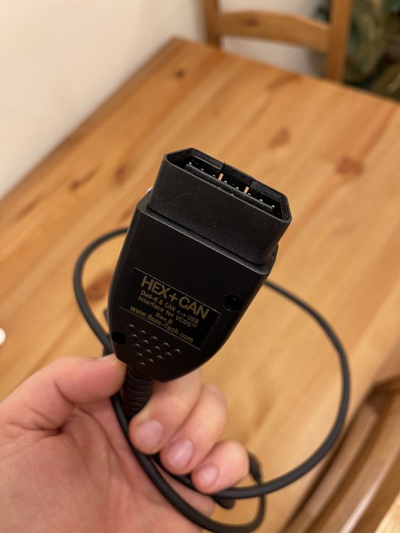

Is this working on Kodiaq 2020?
I thought you needed HEX-V2 (or HEX-NET) for anything after MY18, but someone else may be able to say for sure?
