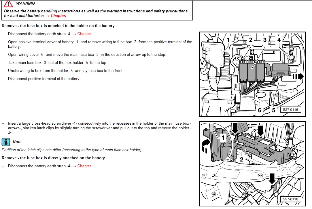

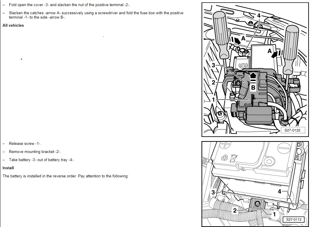

A long flat head screwdriver should take care of the plastic clip on fastenings on both sides and the back. It is a bit fiddly for sure.
There is a part of the casing that slides off the top as one unit (has all the cables going into it) to the right as you face the car. I didn't realise this at first and was thinking I would have to undo a few more cables. This enables the cables to be slid out of the harness they are in along with the part detached from the top of the casing.
The connecters to the terminals go over the top of the casing, so these will need to be detached before removing the plastic casing, and I think the positive lead needs to be further disconnected with a 10mm socket because the leads are connected over the top of the casing.

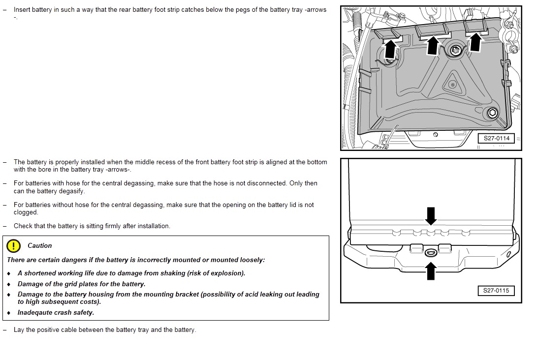

To remove the battery retainer I used a longish extension on a ratchet with a 13mm socket (if I remember correctly, something like that anyway).
