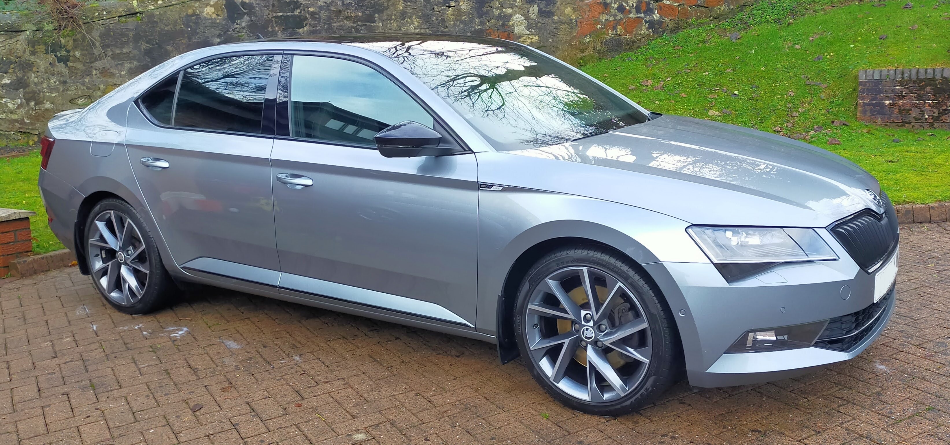

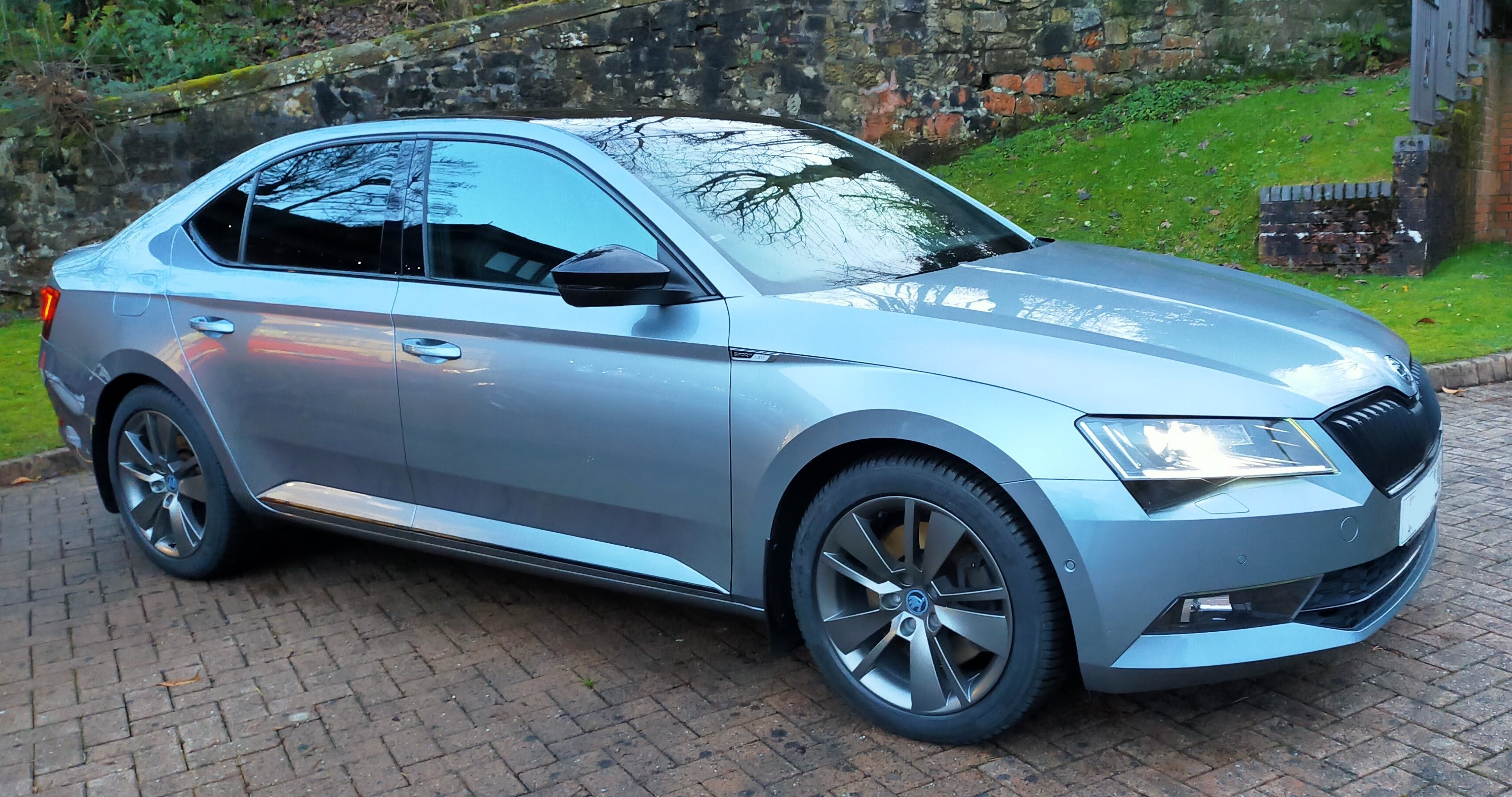

From my own research I would agree with the advice above, and have just fitted 4 x Michelin Cross Climate+ to my 280. I also invested in some 18" Zenith "Platinum" (Grey) wheels for Winter, but may end up keeping them on rear-round. Early days but definitely noticeably quieter than the Pirelli P7s on the 19s, will report back on all round performance in due course.

Pics to follow

3 hours ago, Just said:
Pics to follow
