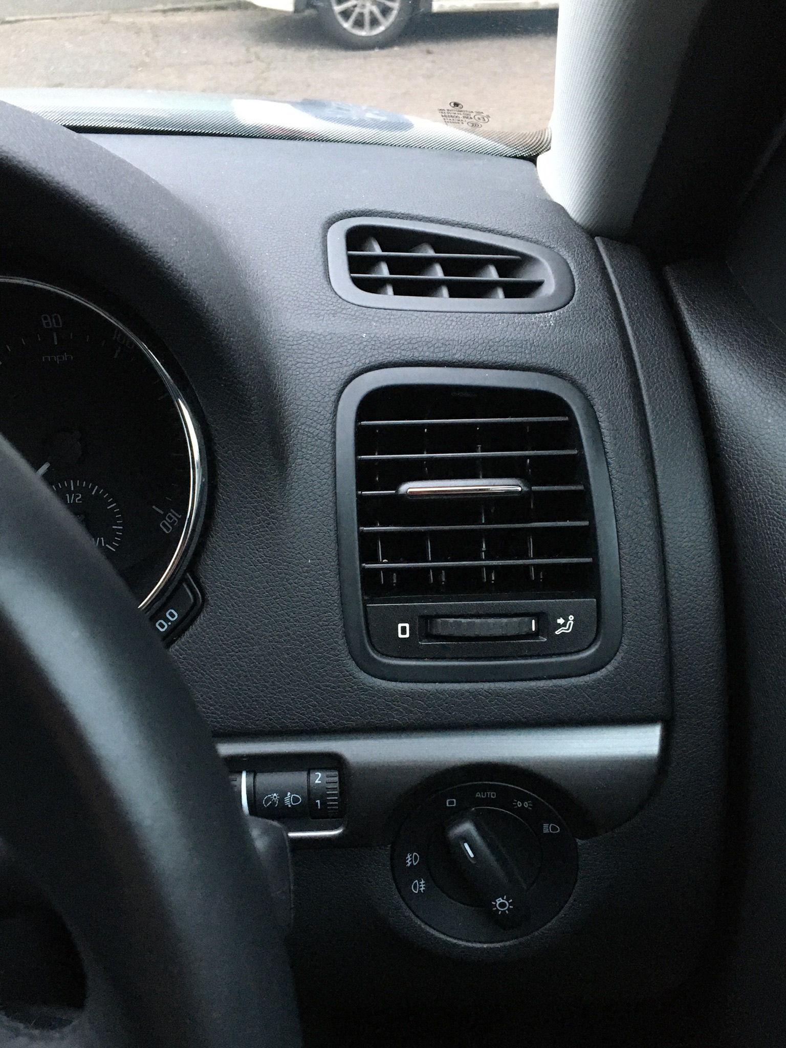

Dash board squeaks
Does anybody else suffer from plastic sounding squeaks and vibration from the right hand side of the dashboard, it only occurs on rough tarmac roads and possibly only in cold weather, if so and more importantly has anybody got a cure ? 🤔

mine squeaks/creaks on occasion, traced my issue to the chromed dial housing area.
fixed by placing thumb on the chrome ring and fingers on the top of the curved instrument housing as shown in your picture and squeeze together, do both sides

I have only ever had a dash creak in very cold weather and that stops when I press on the chrome ring, could it be down to the 16" wheels with 205x60 tyres.

There are very few fixings holding the Yeti dash in place, all at the sides & bottom, the whole upper section is retained by one central spring clip which should engage when the dash is pushed into position, sometimes these are very hard to engage and some mechanics have been known to remove them, the resultant movement will makes noises from all contact and fixing points.
If your dashboard has the centre cubby box then removing this will enable you to see the clip and lubricate it if appropriate, otherwise you can get a good grip with both hands to push the dash in all directions to try and find the source of the noise.
