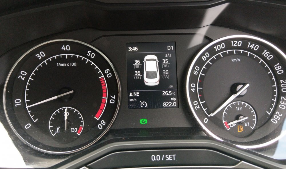

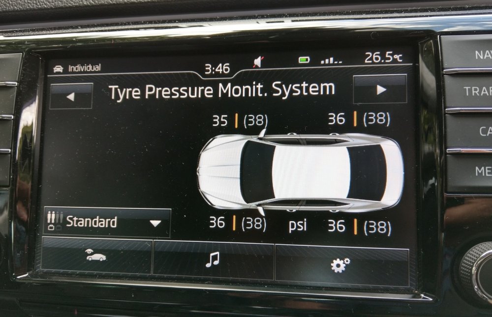

After months n months of planning, I finally retrofitted the Direct TPMS (Tire Pressure Monitoring System).
It all went well and everything is working as expected.
Turns out the module (5Q0 907 273 B ) was already parameterized (the VCP bit), so once I did the VCDS coding bits, it was all running.
I will however need to update (via VCP) the TPMS module's parameter file so it has the right tire profiles, but it's all good now 👍
Very happy I am 😊.

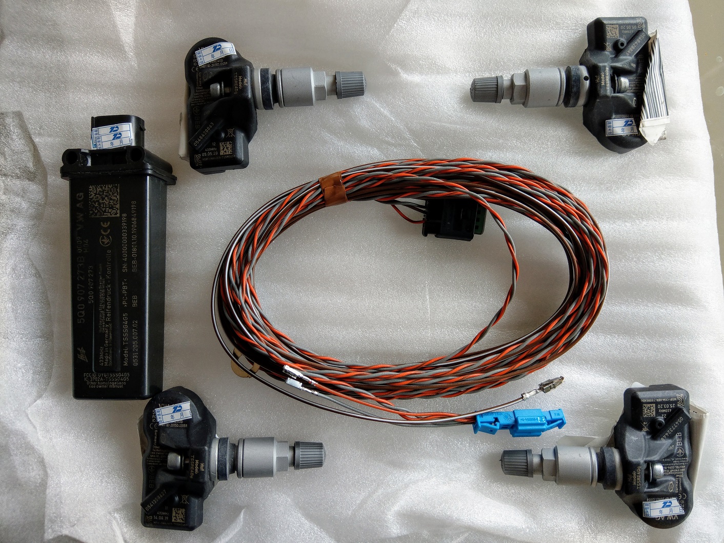

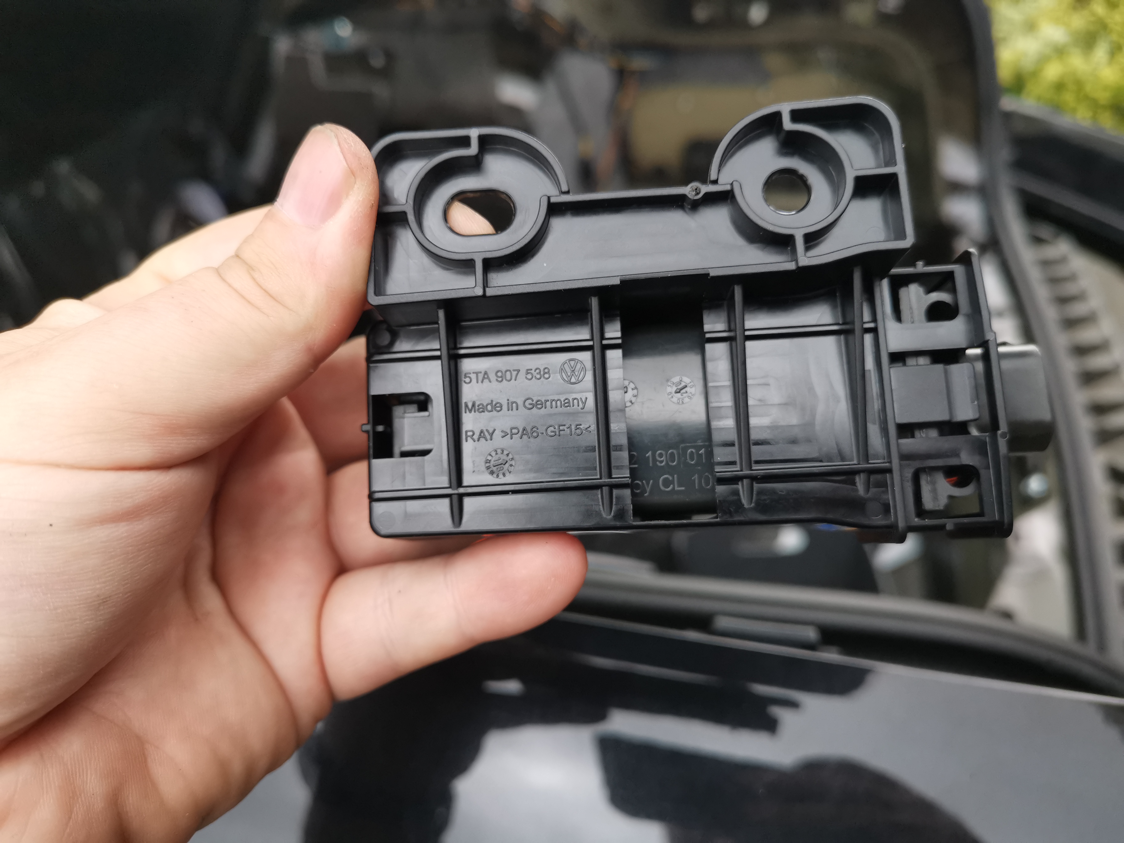

I'll put a write-up together, but essentially it involves:-

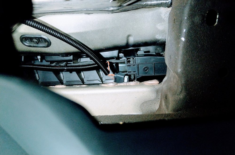

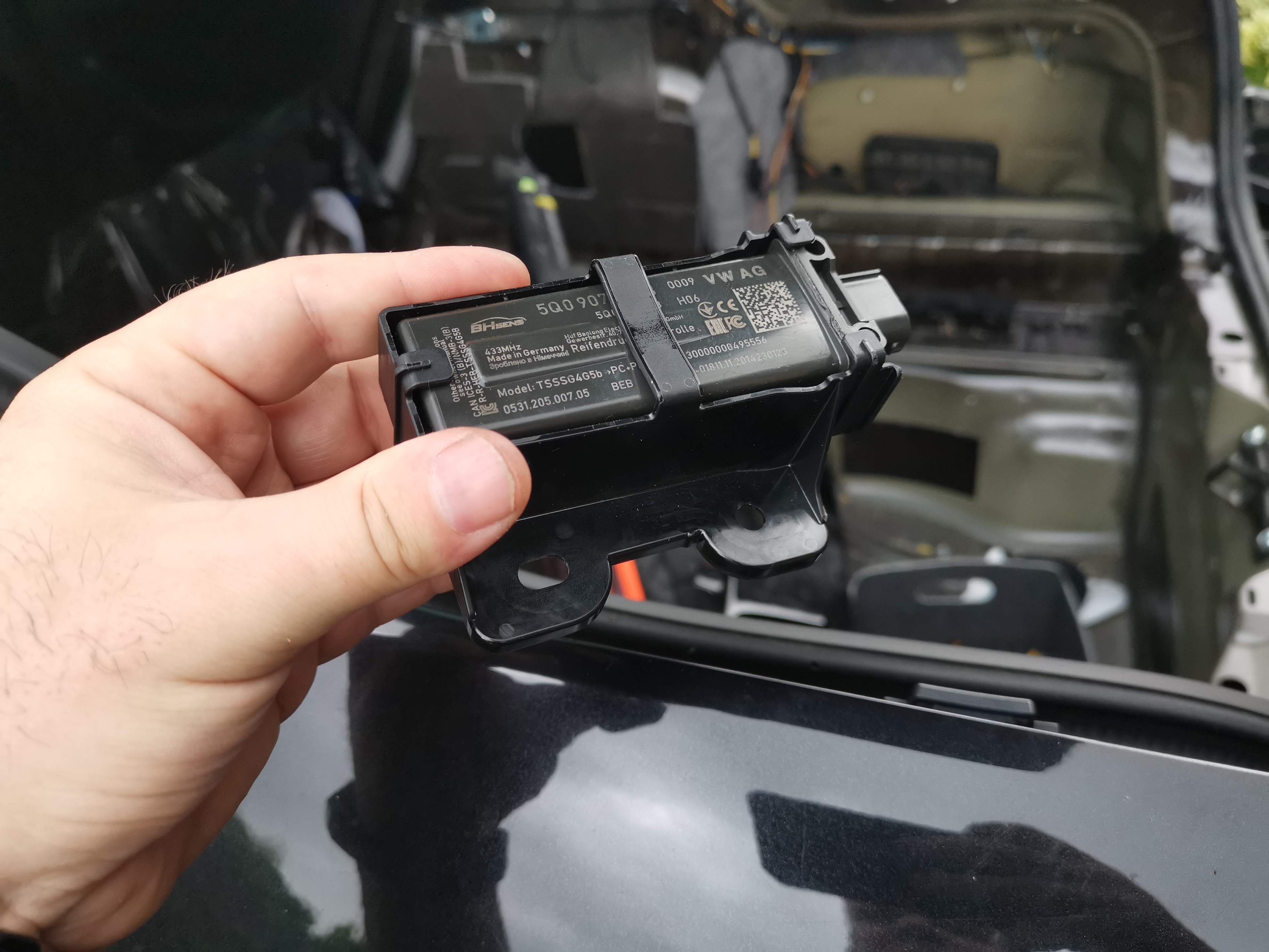

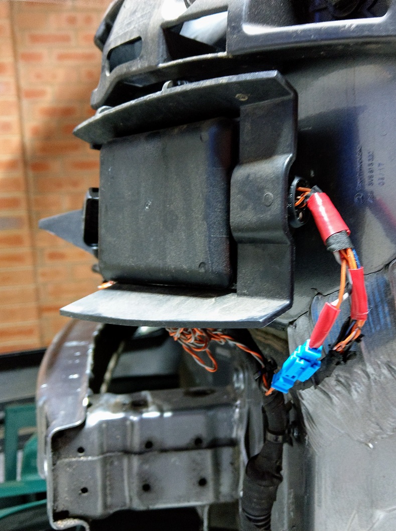

Part 1 - TPMS Installation. Mount module under rear bumper and tap (into the blind spot radar) CANBUS Extended.
Part 2 - TPMS Power.  Run power source through interior trim to fuse panel up front, for constant power supply..
Part 3 - VCDS Coding of CAN Gateway, Instruments and ABS modules.
Part 4 - VCP to load parameter file for TPMS module.
Part 5 - Install Tire internal sensor inside tire.
some pics below......
the unit is accessible from underneath the bumper - no need to remove the bumper to access it.  just incase.

So when fitted, it knows which sensor is where based on the distance of the sensors relative to it.
Hence why the receiver must b mounted right at the back.

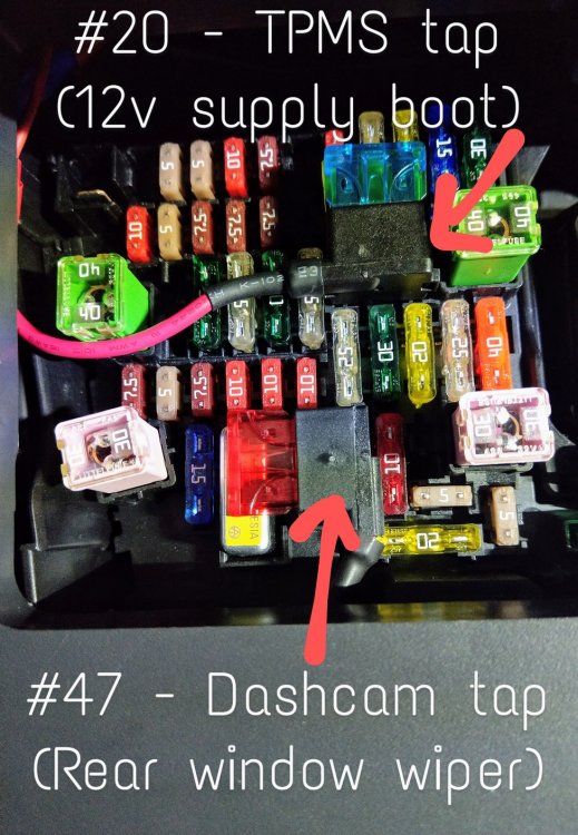

Hi JR,
why the need for constant power?
that is because of how the TPMS module is designed.
if u use switched power, it will cause CANBUS errors.
its the same for other models (Kodiaq) and in various VW and Audi models, where direct TPMS is used.
if u don't want to run the power wire to the fuse box up front, u can tap into the 12v boot power supply, in the boot, as it has constant power.
this was my initial plan, but i decided i to do it properly and leave my 12v boot power supply intact, and run the wire to a fuse tap up front.

The bracket part number I got from etka doesn't look like yours. Have you got a part number for yours by any chance? Yours looks correct, I don't think mine is good..
Part number of the bracket I got is 3G0907538.
AU $25.95 6%OFF | For VW Passat B8 TPMS Sensors Holders Support Bracket 3G0907538 3G0 907 538
https://a.aliexpress.com/_mOSKJQn

4x wheel sensors
1x antenna receiver
1x bracket
1x wiring loom/plug/terminals
then you need odis or vcp to parametrise it

Plus u need to run a power wire to a permanent 12v power source in the fuse box under the glovebox, hence u'll need sill panels off, boot trim panels off, so u can route the wire to the front.
