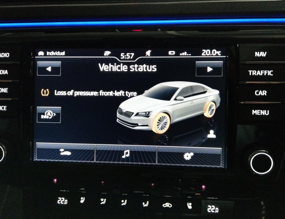

Yes, I had indirect TPMS before, which uses the ABS wheel sensors to detect rotational speed of each wheel, then compares it to detect any differences, which would indicate a loss in pressure.
My version of indirect TPMS would tell me which specific tyre is the issue. See image below.
With the generator, yes, u can setup different sets of tyre sizes and select in the infotainment screen the appropriate set, based on what u have on the car.
The generator creates a parameter file which can only b uploaded via VCP or ODIS.
VCDS or OBDEleven cannot do this.

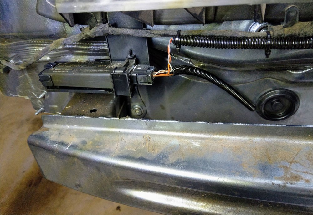

Just one question: does the control unit has to be put horizontal or vertical works the same? I ask You as it seems impossible to fit horizontal, without risking, in case of rain, that the wires near the plug can get water! Can You help me?
I have it mounted in the trunk of my car (non Skoda) and it works without any problems.
It shouldn't matter horizontal or vertical mounting.
I did horizontal as that is OEM for the likes of Golf, Passat, Kodiaq etc etc - so I followed that.
It's been 5 plus years now - no issues with rain or water getting in.

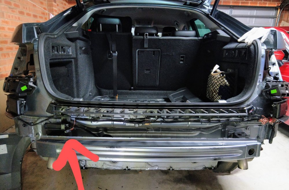

Hello, I opened the trunk liner where you place first aid box and placed it horizontally using double sized tape. I did not have tools to remove bumber instead i simply stuck it above rear wheel well by opening trunk lining. Its been few months and it simply works fine.Including picture of the exact location.
