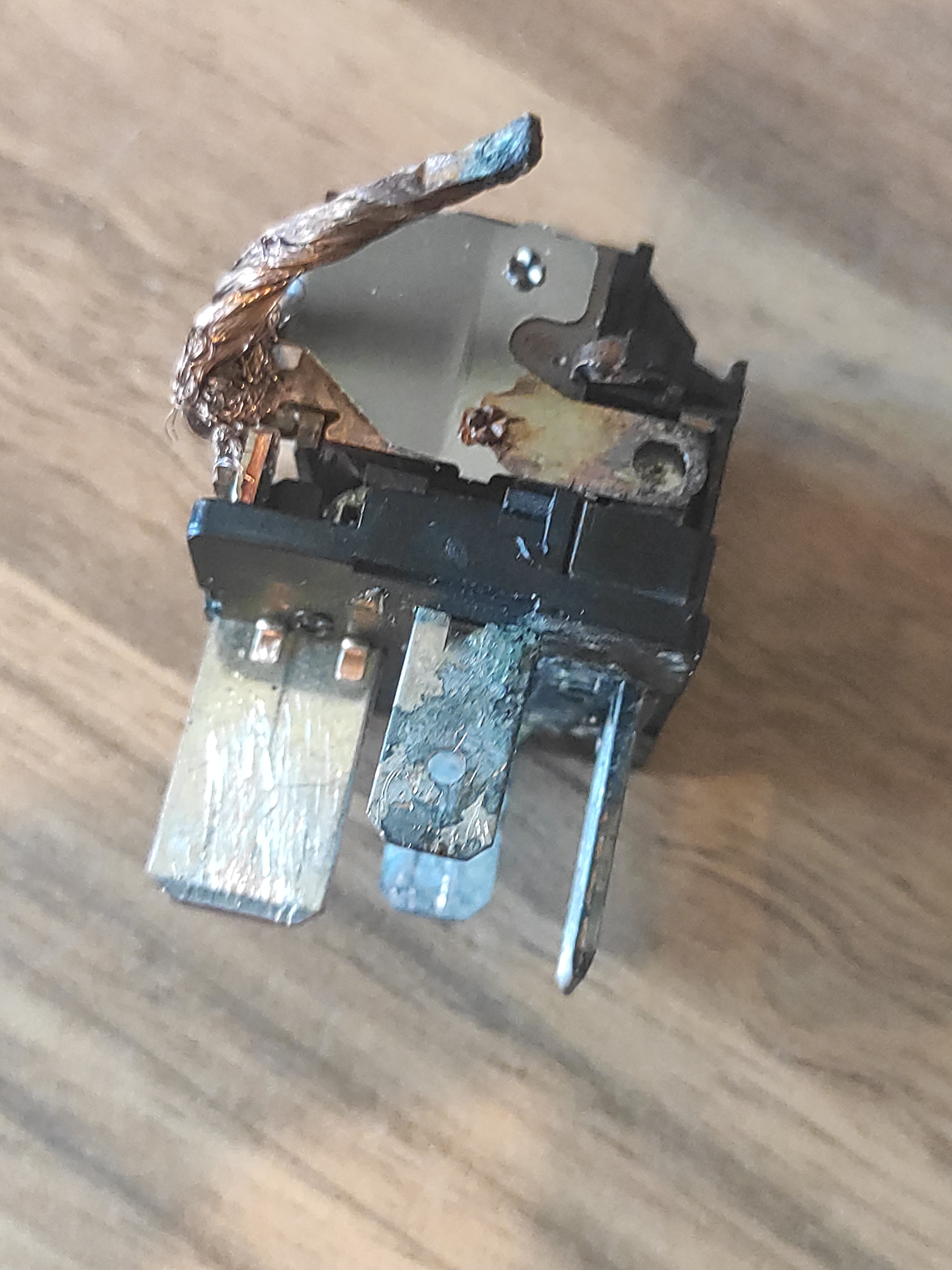

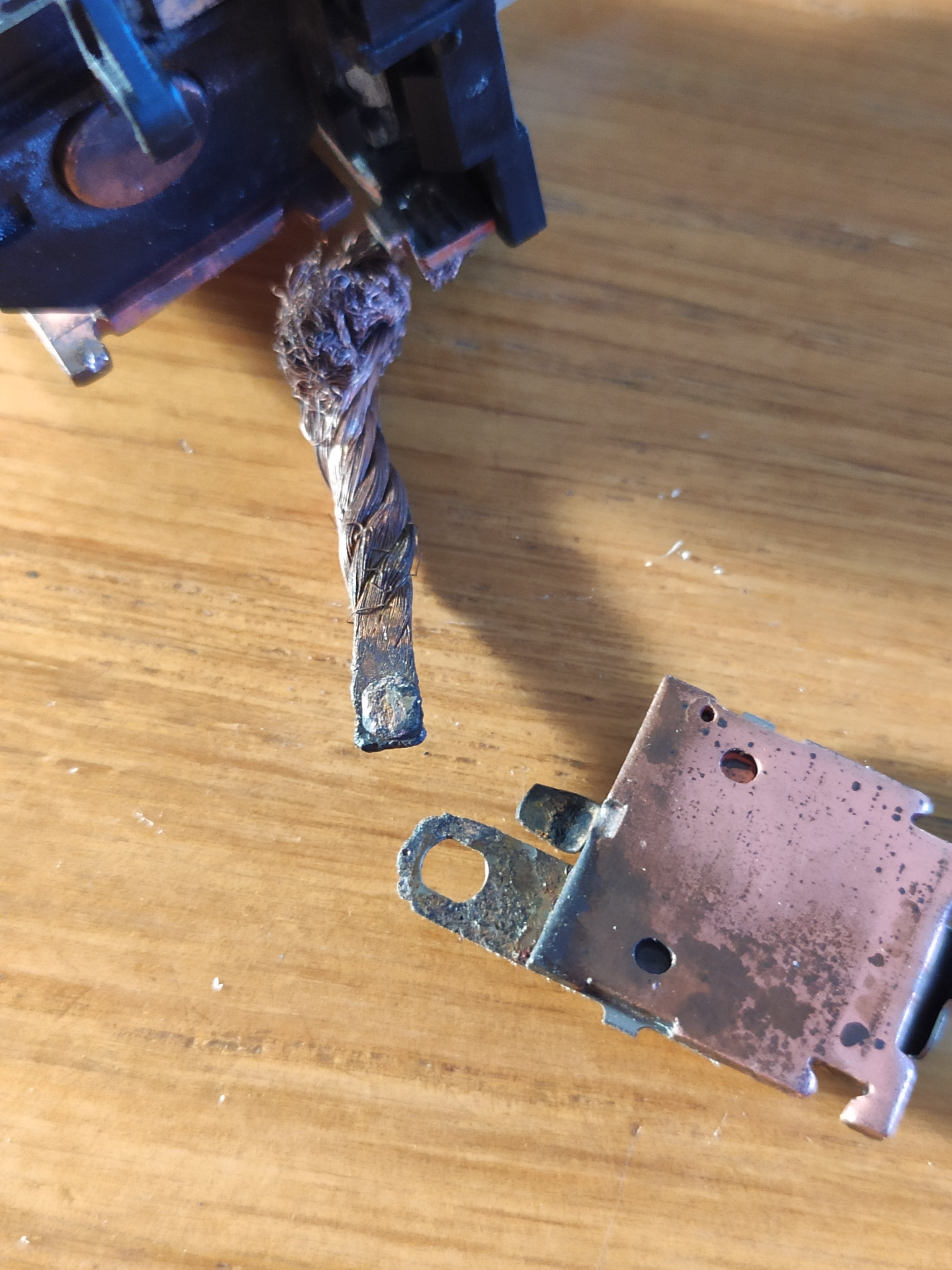

I opened it up and the cable connecting the moveable armature to the terminal separated from the armature with almost zero force, looks like it was a  dodgy spot weld to me
Probably manufacturing fault. I wonder if the heated windscreen has ever worked.
Did that connect to connection numbered 3 or the number 5 one?
3. Why do you ask?

I was just wondering if the corrosion evident on no.5 was the result of moisture that had also tracked inwards and damaged the flexible wire. Seems not though. :)

Having seen your picture of the inside, I'd say the spot weld probably failed as a result of corrosion rather than a manufacturing fault.
If you get moisture bridging two metals carrying different voltages, the corrosion is greatly accelerated.  It acts like an electroplating bath, with metal being eaten away from one side and deposited on the other.
I deal with electrics for motorhome owners from time to time.  They often have issues like this due to their vehicles being laid up for months at a time and getting condensation which lingers.  Similar vans used every day with plenty of engine heat and ventilation are much less affected.

If it is corrosion it's very localised to the spot weld. To be honest it looks more of a rivet maybe as it's through a piece of chromed spring steel and forms the contact. On closer examination I reckon it's just pressed to mushroom it maybe.
