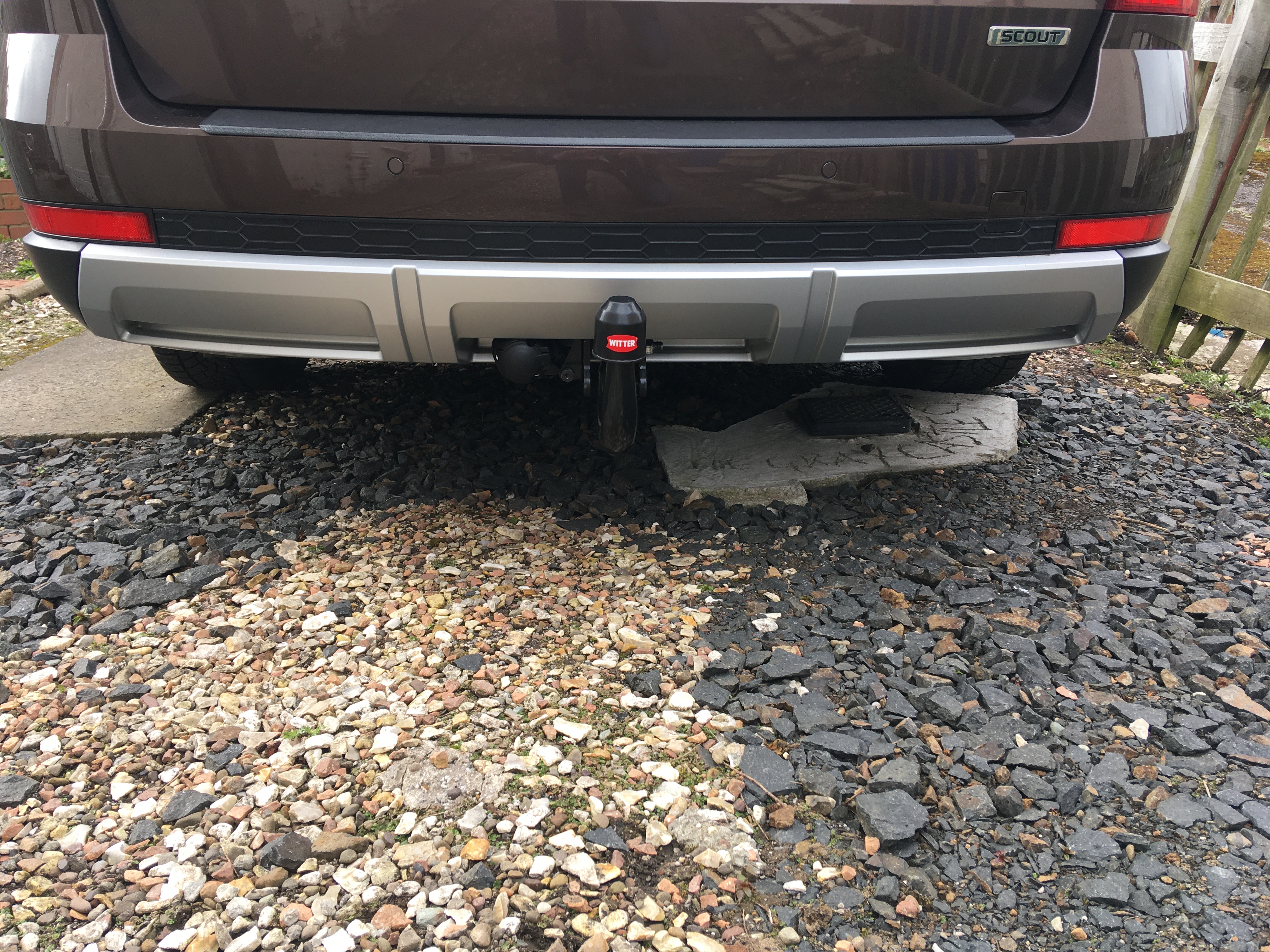

I fitted a Witter fixed swan neck to my 66 plate Scout yesterday afternoon.
I got a fantastic bargain from Buchans For Towbars (Glasgow)
The bar was “New-old stock” and I got it for the princely sum of £60
I fitted it in just over 2 hours and will go back to Buchans next week for the electrical work, which they’ve told me will be £90.
If in future I feel the need for a detachable tow ball, I can purchase it (and the housing) and it slots straight into the existing bar. That would cost £120.
gotta love a bargain!

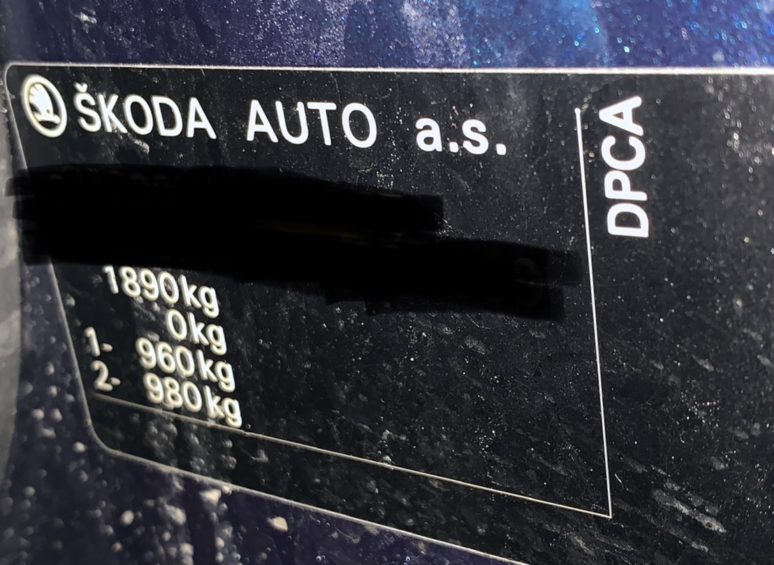

@Ajdude, I work for Skoda and have recently sold one of these cars. The customer took the car to a tow bar fitter yesterday who told him an aftermarket towbar couldn't be fitted due to the weight plate showing 0kg. Would you mind looking at your plate (on the b pillar, drivers side) and seeing if the GTW says 0?
Thank you

Hi @tobster911   .  I’ve checked my VIN plate and rather surprisingly it is identical to the plate shown in your picture (except the VIN number).  My towbar was fitted through DM Keith in Grimsby and  nothing was mentioned.  I had best have a conversation with them about the legality of fitting a towbar.
Not sure if it makes a difference or not but I use mine predominantly for a bike carrier rather than towing but on occasion use it to pull a small erde 120 trailer.

@Ajdude@tobster911may I ask which engine the 0kg towing was for?
My loaner is showing 0kg too (1.5L TSi). I am really hopeful that won't be the same with my 2.0 TDI when it is finally returned to me!
According to my fitter its the fact that its fitted is the problem. However I have no legal confirmation.  My wife works for a motor legal company so she will enquire on Monday.
Regards Chris
My issues are with a 1.5 Tsi 150 Bhp.
Same engine I had on my Karoq and no problems with power when towing whatsoever.
I just looked in the first brochure for MK4 (June-20) and it does say that 1.5TSi can't be retrofitted.
Looking at the current one, it does seem that it is not possible to retrofit a towbar to any of the petrol variants.

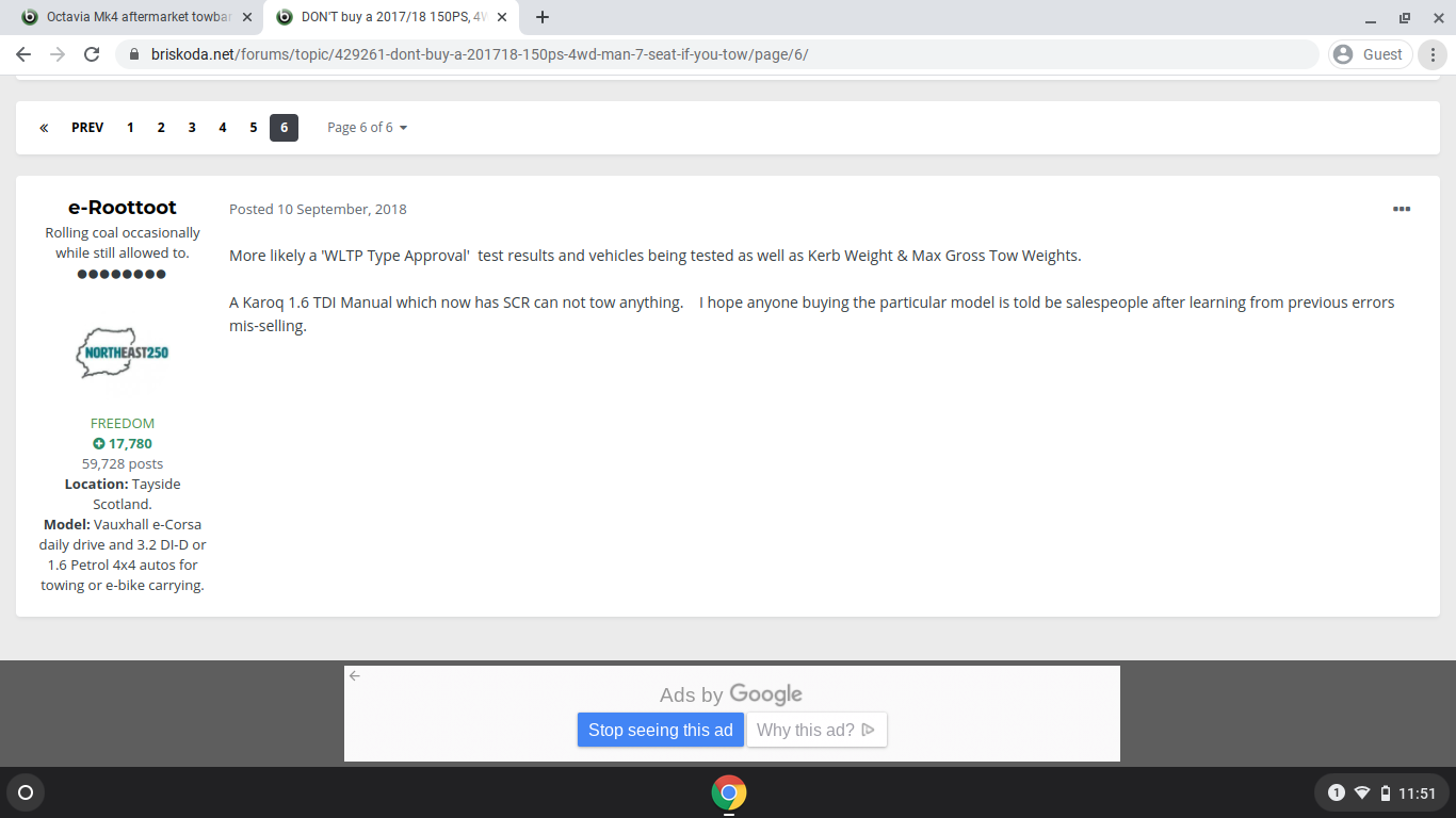

http://briskoda.net/forums/topic/429261-dont-buy-a-201718-150ps-4wd-7-seat-if-you-tow
This is the Kodiaq that can not legally tow on the Public Highway.
Just the same as Fabia vRS & Mk2 Fabia vRS.
Edited by e-Roottoot

A Bike Rack & carrier fitment is a very different thing from a Tow Bar used to tow when a car has no 'Manufacturers provided tow weights'.
The Grey area has always existed in C&U Regs and Type Approval.
Some for Tow Bars for recovery of vehicles.  (Not advised!)
This is about the Karoq that can not legally tow.
