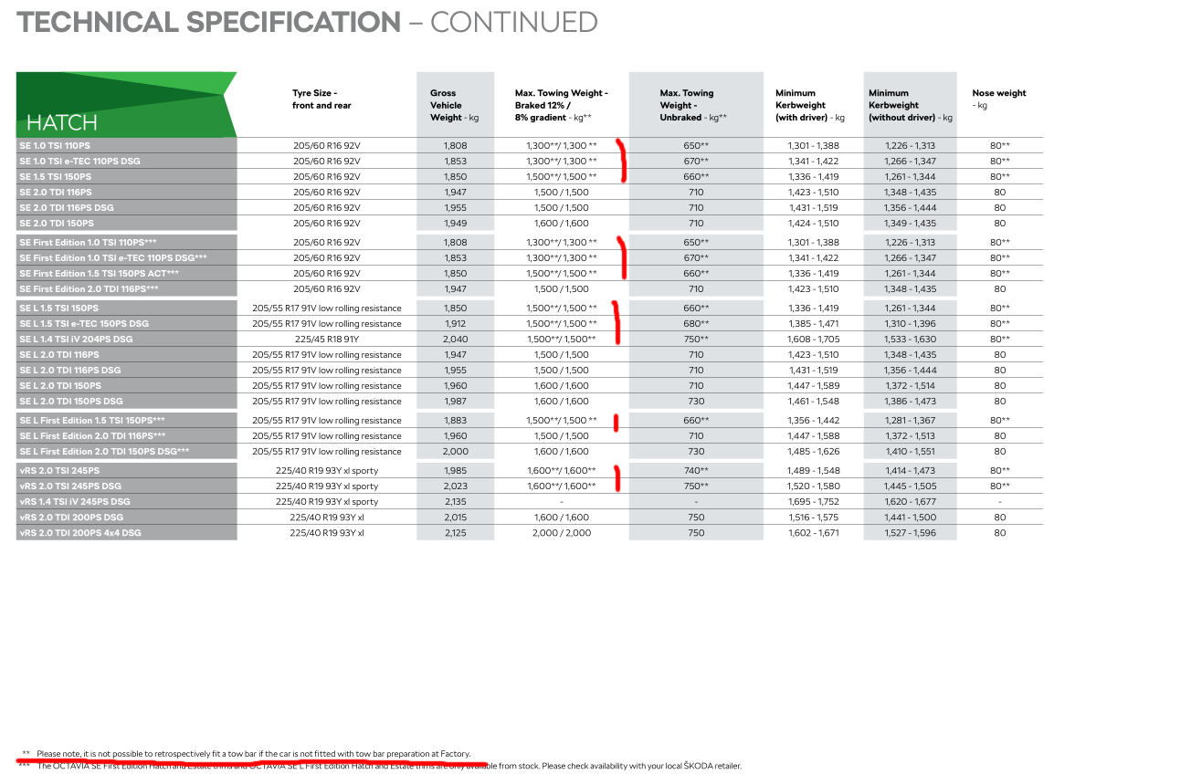

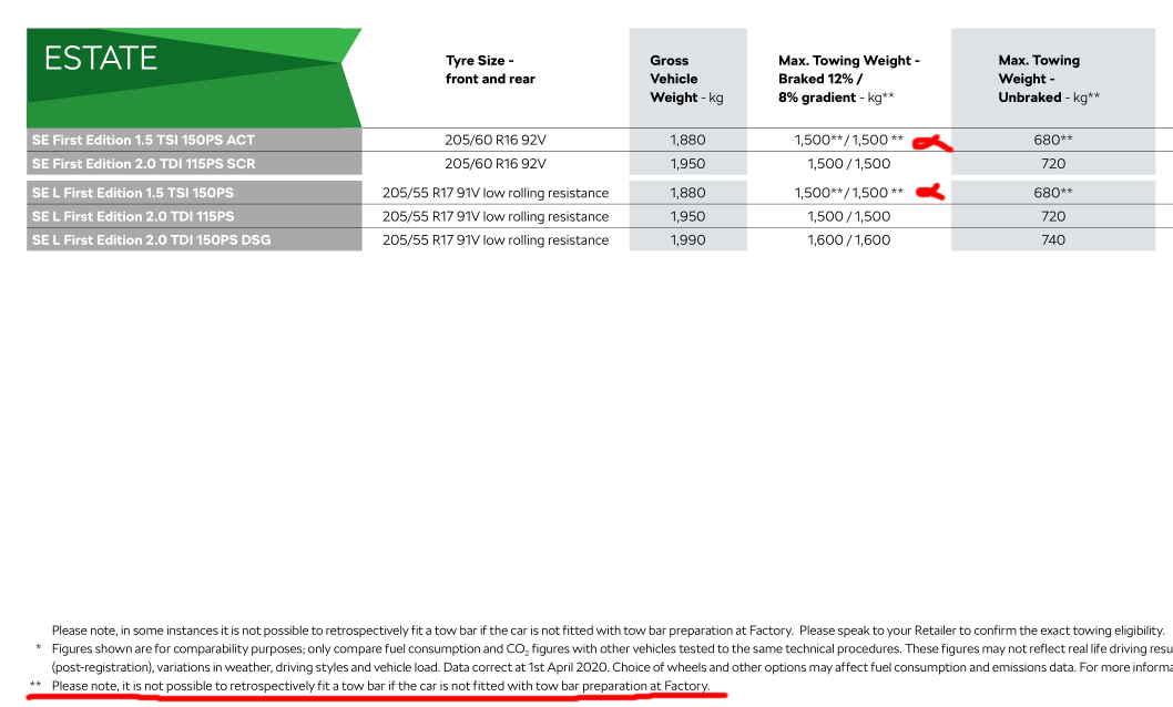

I just looked in the first brochure for MK4 (June-20) and it does say that 1.5TSi can't be retrofitted.
Looking at the current one, it does seem that it is not possible to retrofit a towbar to any of the petrol variants.
I've seen this before on some other models. The cooling system may not be sufficient as standard with some engine sizes as they will have been fitted with smaller radiators/fans etc for the smaller engines. The tow bar prep option could include changes in this specification as well as some electrical mods.

Could I just clarify, Skoda offer "tow bar preparation" for £200 in the configurator for the Mk 4.  But even Skoda's website doesn't help much.  This is from the Mk 4 towbar prep details:  Please note, in some instances it is not possible to retrospectively fit a tow bar if the car is not fitted with tow bar preparation at Factory. Please speak to your Retailer to confirm the exact towing eligibility.
I find the last statement in italics Hilarious.  The retailer has no clue about the towing issues.  My supplying dealer happily fitted an aftermarket tow bar to a car with a 0 kg GTW.  They are now in the process of taking the car back and finding a suitable replacement.  They weren't aware, or made the assumption that the restriction was based upon a time lag for parts to be become available for a new model and so wouldn't be an issue.....go figure.

Cannot be retrofitted on 1.5 TSI 110kW cars without preparation for towbar:
  • Combi produced from CW 05/2020 until the end of CW 43/2020 and from CW 48/2020 applies further
  • Limo produced from CW 10/2020 until the end of CW 43/2020 and from CW 48/2020 applied further...
