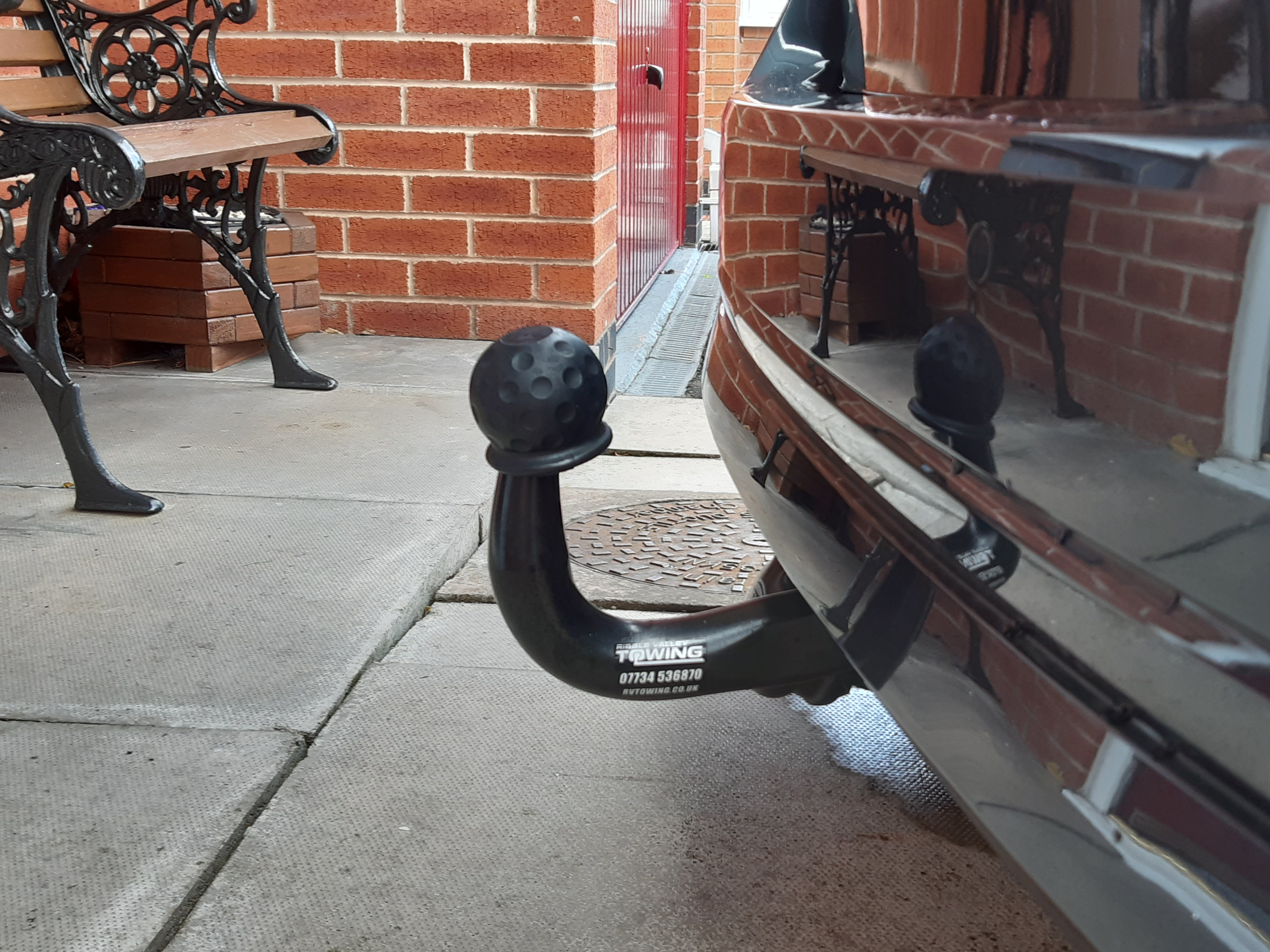

  • Ok So I've just now today had my towbar fitted by PF Jones (was supposed to be a couple of weeks ago but finally came now), and this appears to be successful.   As above, the towbar itself a

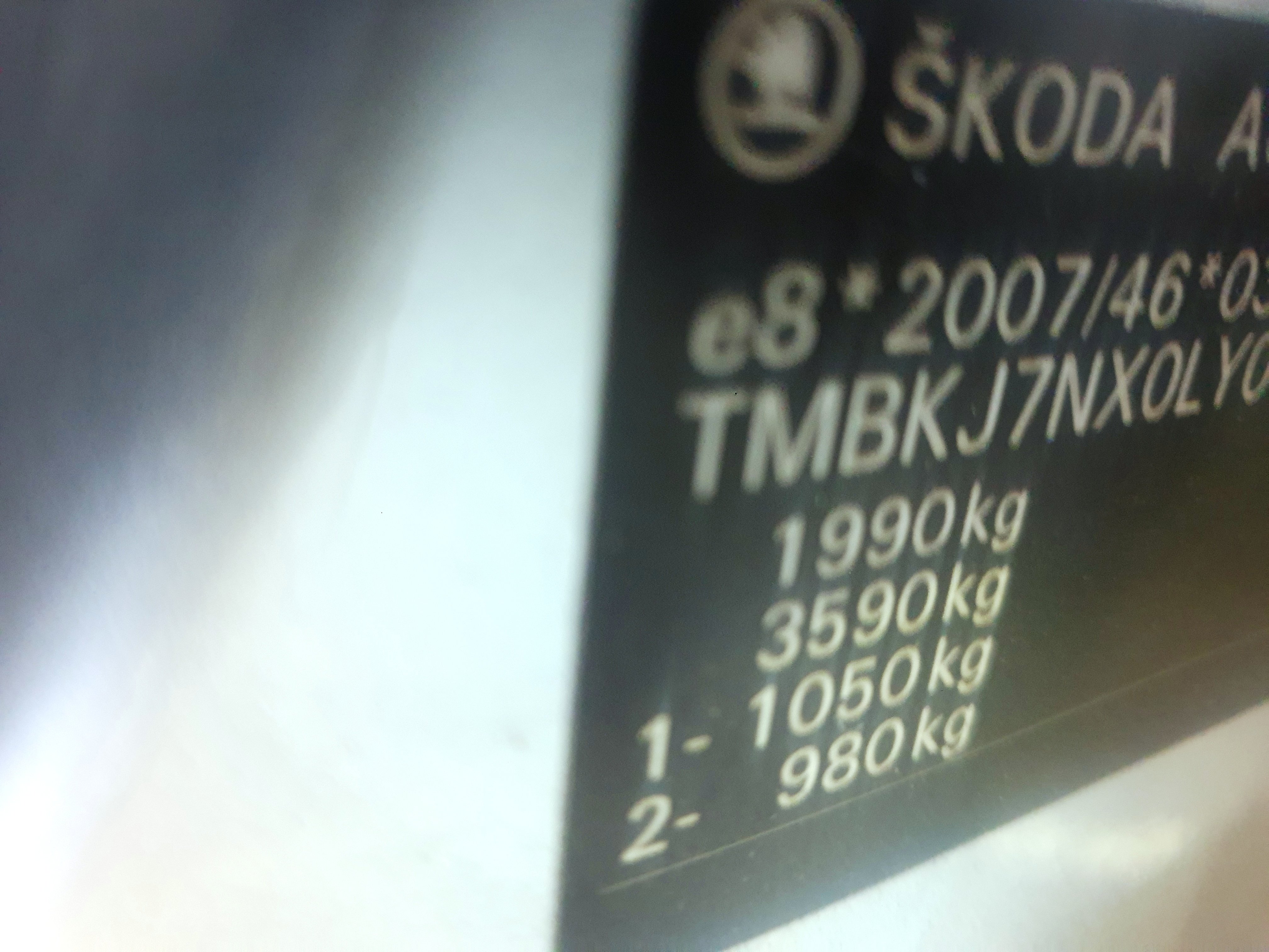

So I assume it is the 2nd value (3590kg) which states the towing weight? And if this says 0kg, like mine, then it doesn't have tow bar prep and, in theory, shouldn't have a tow bar fitted (even if only for fitting a bike carrier?)
Exactly that. It sounds incredulous but that's correct. In my own case I eventually bought the last of the previous series and managed a deal to include the towbar.
The 3590kg is your max combined mass. Car + towable.

That is what others have discovered, if the second line on the sticker on the door pillar is zero, it is not homologated for towing, and would be illegal in UK for anyone to fit a tow bar.
