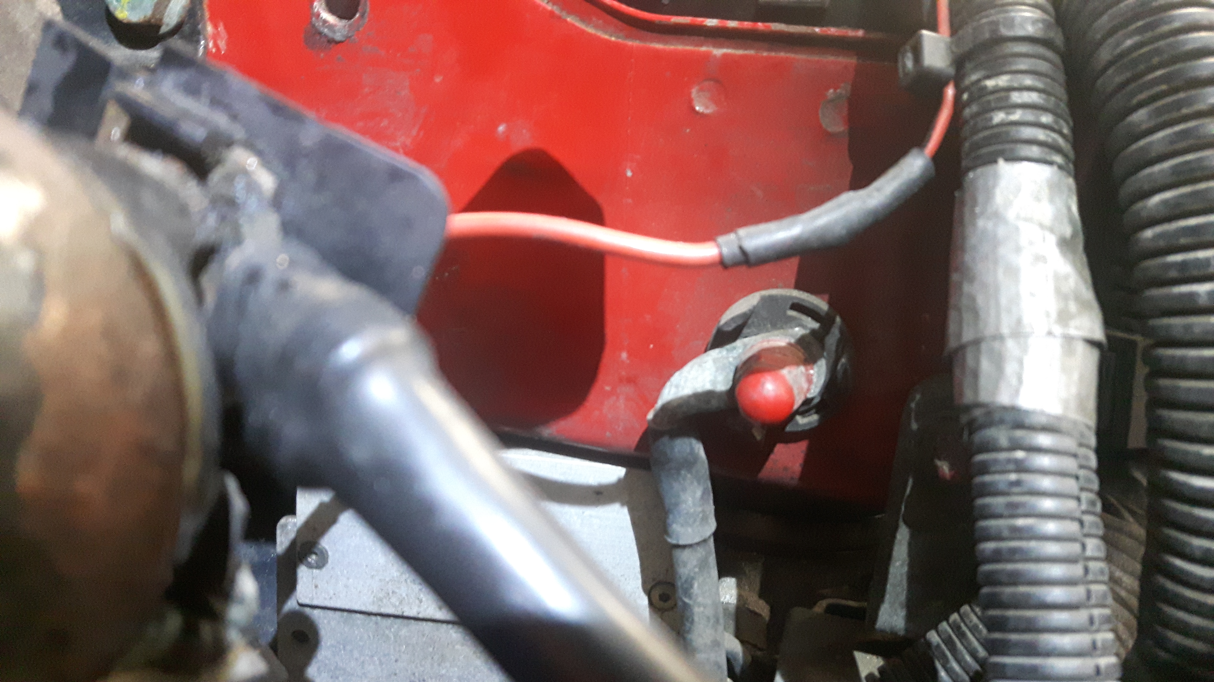

One thing that may be worth considering is upgrading/upsizing the cable between alternator and battery fusebox; that would minimise any resistive losses in that leg.  Not sure if the cars that had 120A alts from new had a bigger cable but I think the standard ones are only 16mm².
For the same reason I would suggest  removing, cleaning and refitting the main earth cable between engine and chassis.  Both ends of this are quite exposed, and the engine end gets thermally cycled too every time the car is used.  Good clean connections on this cable can give you much improved battery charging and general performance of the electrics. Goes to the inside face of the nearside chassis leg and to one of the starter motor fixing bolts at the other end.
Photo shows the chassis leg end, and the repaired starter solenoid wire just above it.
