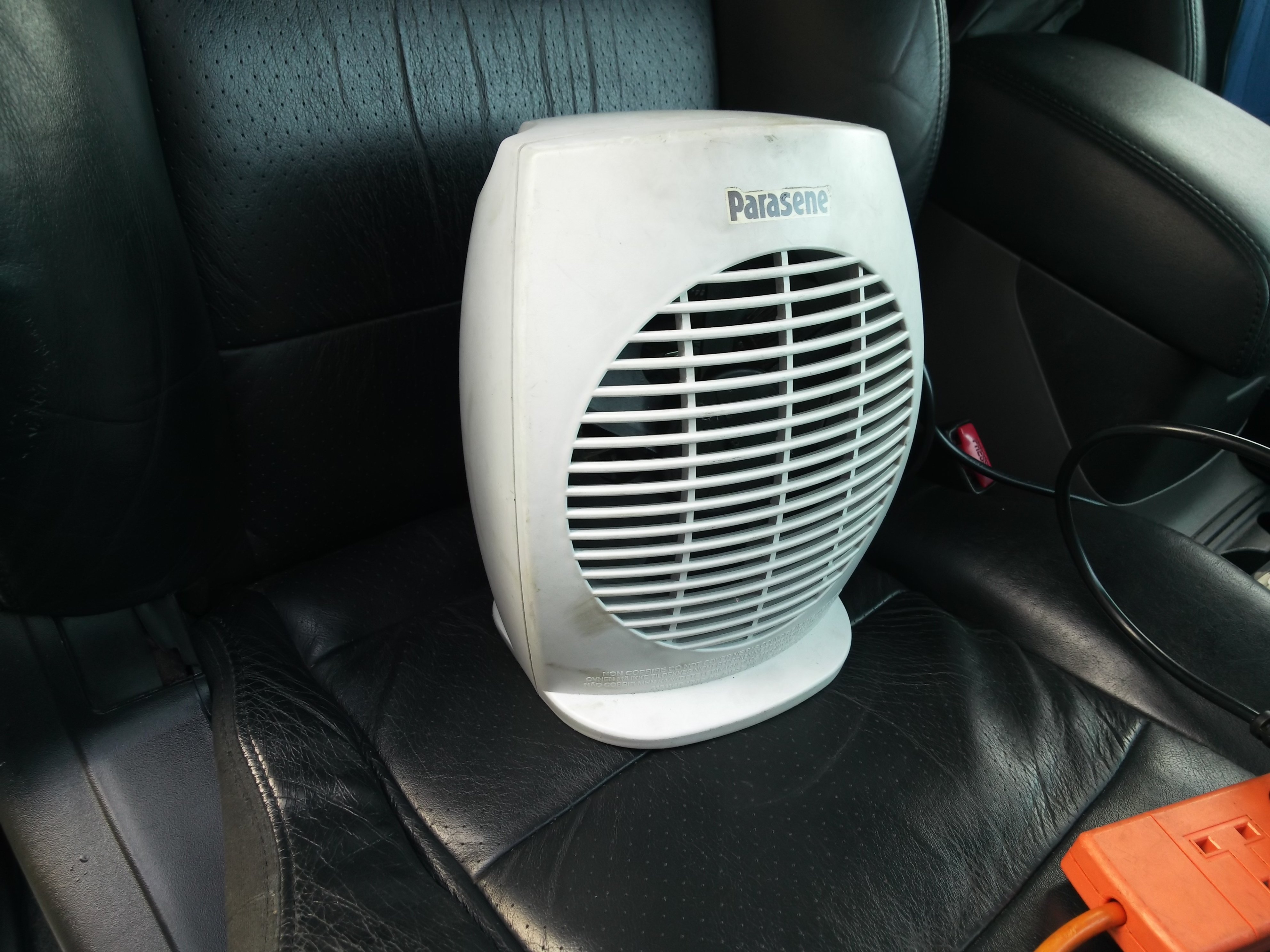

If an ICE vehicle is parked near where a safe extension lead can be used then a Greenhouse heater can keep the interior above freezing overnight / daytime and the glass free of ice inside and out and the locks all working.
Not that expensive in electric it costs me about 50 pence a day to have a heater in the car when parked.
Costs more than that running a heater in an EV to be pre warmed.
