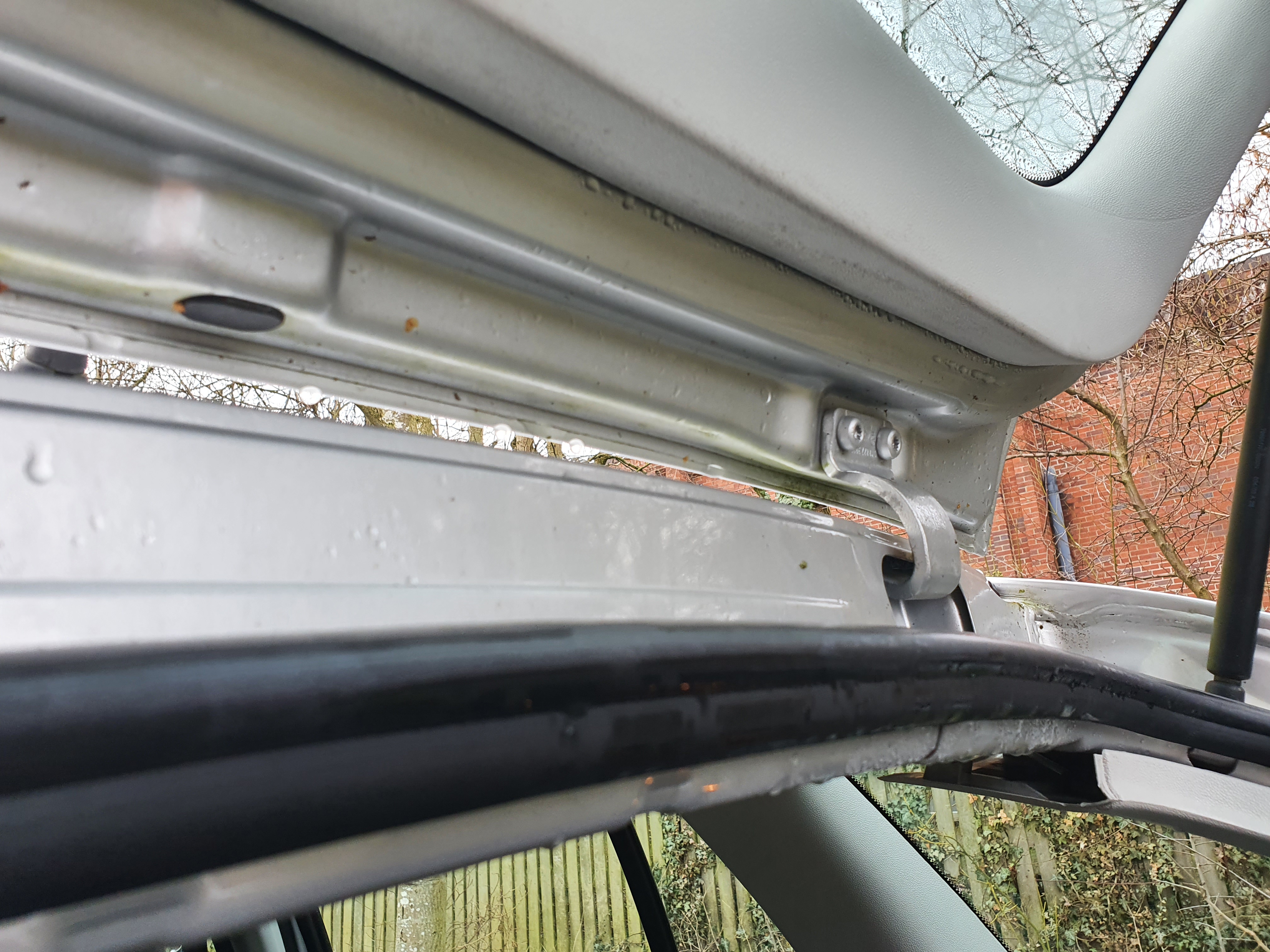

My fabia estate has loads of condensation. I have already sealed the rear doorcard up wich was leaking, but it is leaking elsewhere too.
I took the trim off from the top of the bootlid and it had loads of water droplets there and under the edge of headlining too. Is it likely to be leaking from the ariel or 3rd breaklight, or both? Are these also common leaking points? If so are they easy to seal up?

It gets in from the air then condenses out and runs down the windows overnight, it doesn't have to be raining, just cold.
