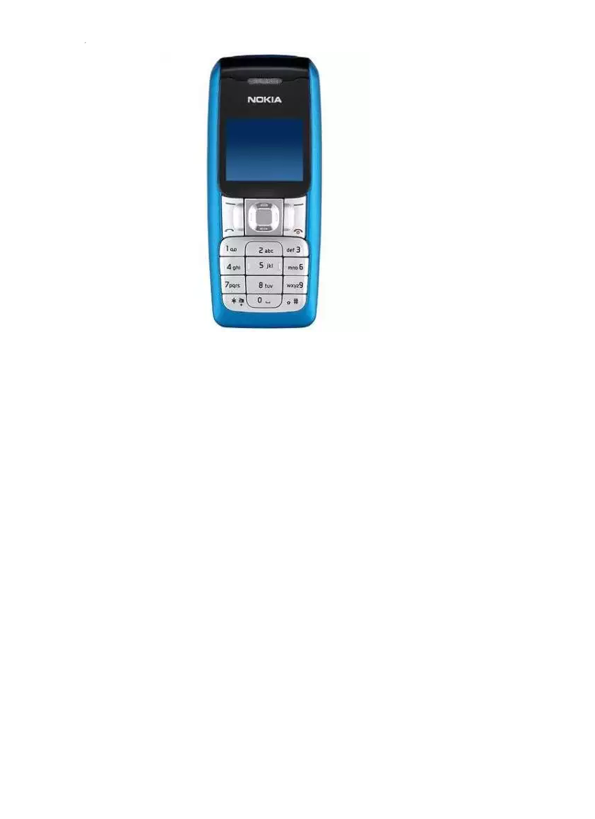

My answer is no and I have never upgraded bios on my computer either.
Yes I can see why that phone doesn't get updated regularly lol.
I think computer bioses normally get their main updates early on in their lifecycle so there may not even be another for @Robjon's computer for quite some time.
