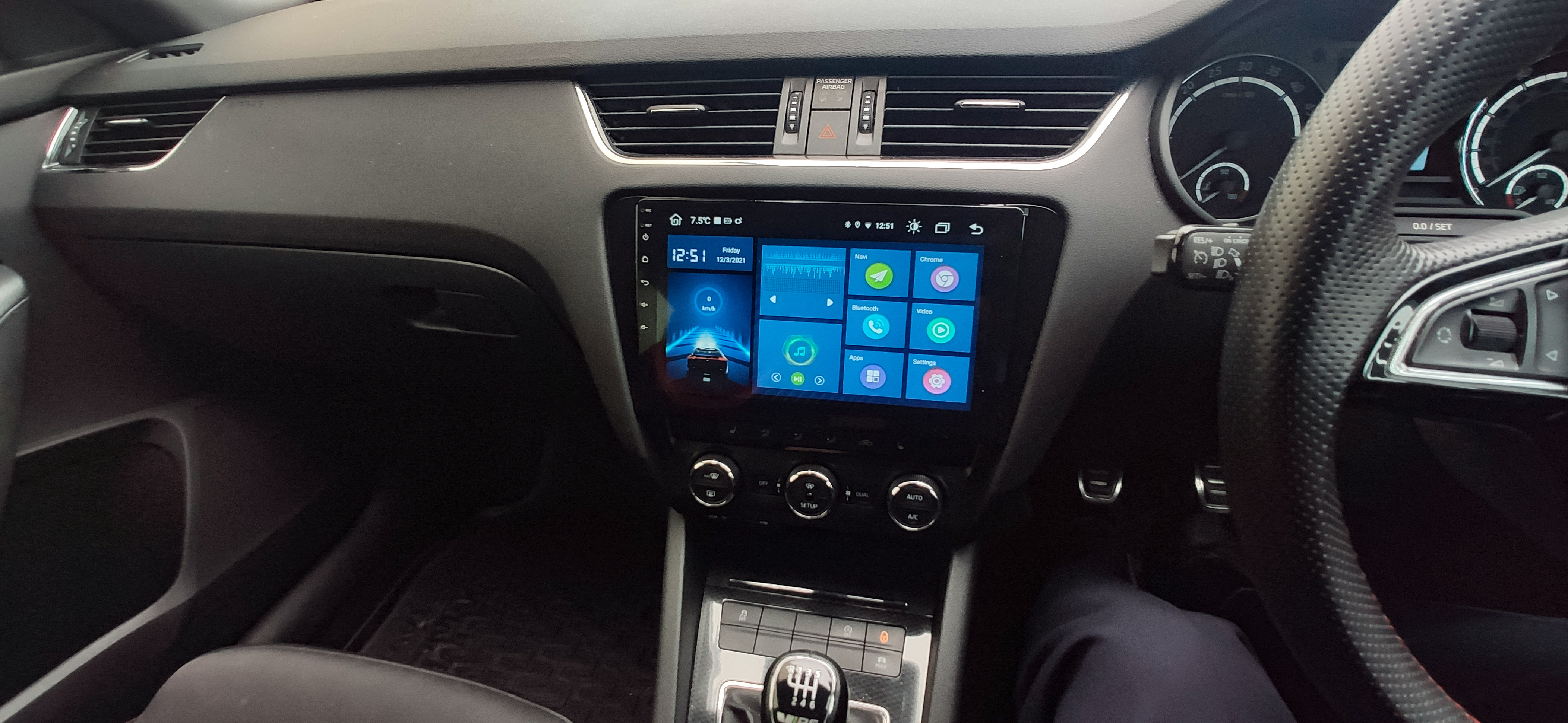

Just took the plunge and fitted an Android stereo.
It's a Junsun V1 (I think lol).
10" screen.
Was plug and play and supports all CAN bus features (door indicators, climate, turning on and off and other vehicle information).
Looks great. And sounds great too. Got my phone connected up. I'm using a microphone in the overhead interior light like the OEM but with a standard microphone jack (FISCON 36338-2).
Then got a reversing camera from China on the way. It can with one but it's ugly. And also the stereo shows up the dynamic steering lines when in reverse (they turn with the wheel just like the OEM system) so needed a camera without the inbuilt static lines.
Also got a couple of USB Adapters that slot into the buttons by the traction control buttons etc.
I also noticed this evening that it still also shows up in the Maxidot too which is a nice surprise.

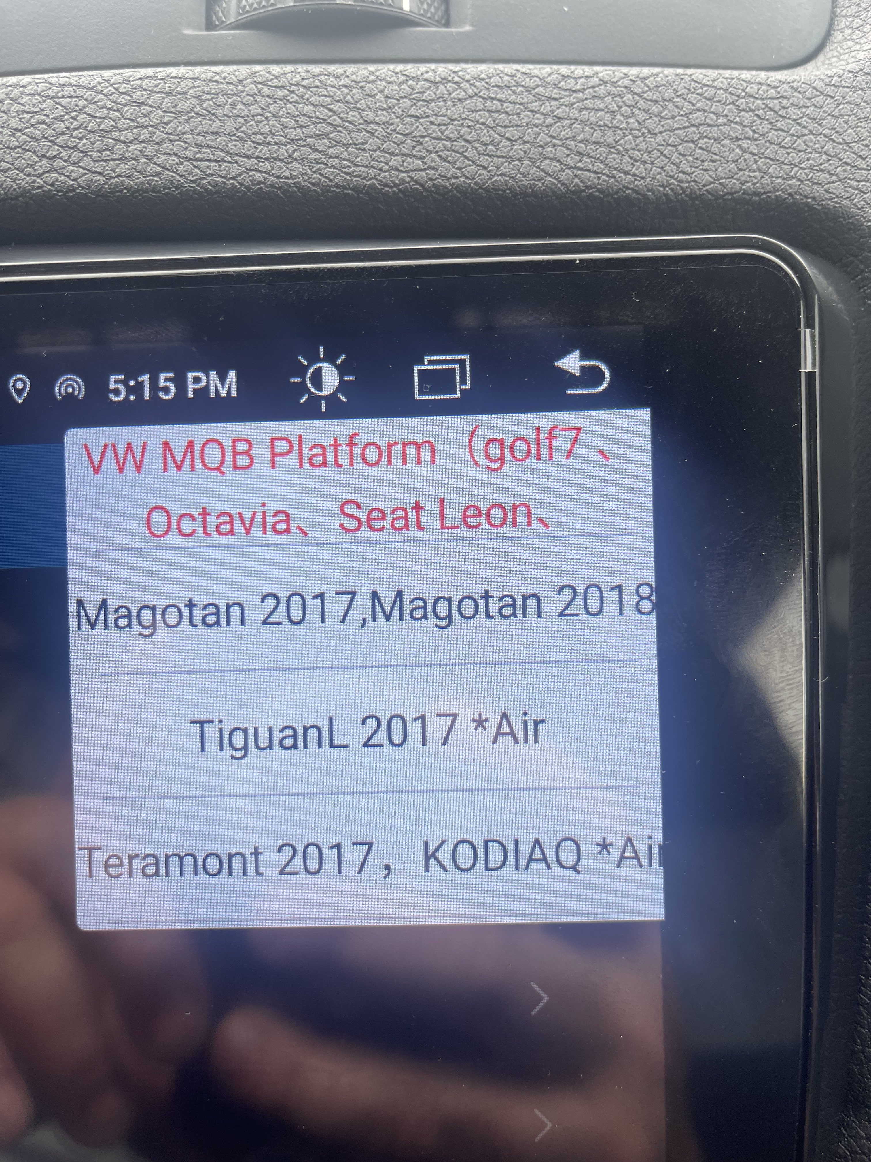

Hi, Phil-E. What is the can type for the unit? I don’t find it. This is what i got, but is the wrong one. Skoda Octavia A5 2009

I have the same problem skoda octavia mk2 same android i cant find the canbus type for my car please help....

Please tell me whats the type of canbus we have the same car and android...please help
