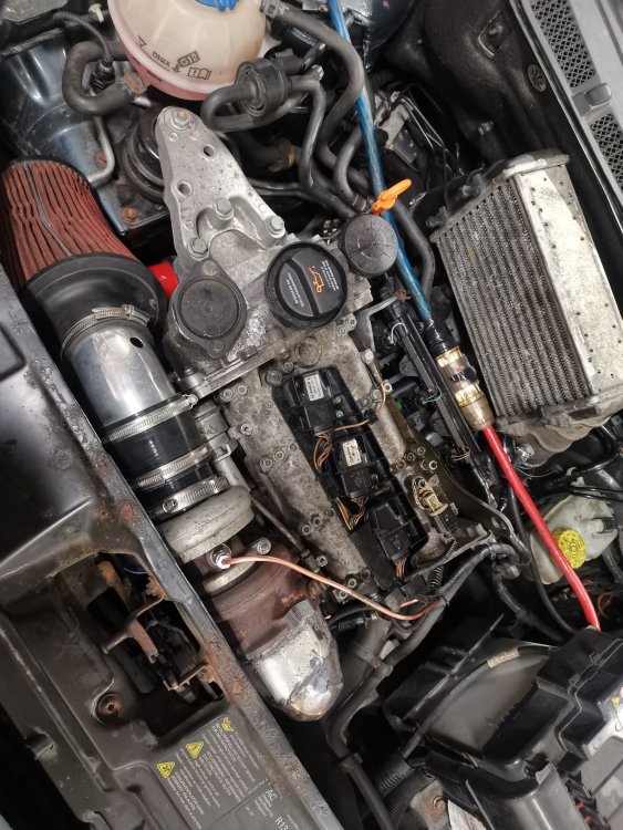

I build turbo and intercooler on my fabia 1.2htp..
Is it someone out there who have a ecu map or something that can work with this setup?
Runs about 0.5-0.7 bar turbo boost.
It goes in limp mode when its goes too high on rpm...

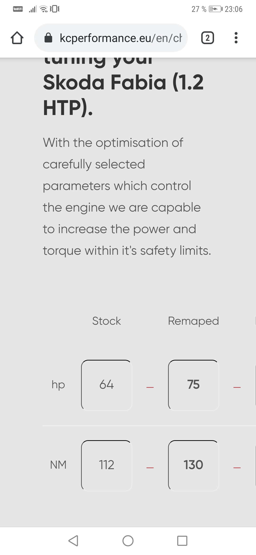

I don't think you can remap the ECU if it's a Siemens or a Marelli unit.
Yes you can tune it. Its No problem.
11 BHP, are you KIDDING me!
From 64 to 75 on a N/A 1.2, what the hell are they smoking? Whatever it is they're obviously rolling it up using gullible idiots money for the rolling papers.
I would definitely check which ECU you have before giving them any of your rolling papers!
Hahaha, i see what you mean.
But i use ecm titanium too tune, and i have given this car more fuel. So iknow i can map it but how much you can take out is not so much i think.

You need a 2 bar MAP sensor for boost measurement, standard MAP sensor will probably be 1 bar for a N/A engine.
Ok, thanks! Gonna try too find map sensor with 2 bar that fit.
I think the stupidity in this post is killing my brain cells off, you have nothing controlling boost, I doubt that a 1.2 HTP even has the capability to spool that turbo up to make it efficient you need a tiny turbo to generate any really gains , would be more fun supercharging it
If it makes choo choo noises it was worth it.
But yeh that turbo looks way to big for that engine. Do you know the make/size of the turbo?. What kind of wastegate setup do you have?. Boost control?, Injectors?, Wideband ?.
The turbo is coming from 1.6tdi Peugeot partner. Its no problem too spool it up with this turbo.
Its Just for fun.
On top it makes 0.7bar and it makes 0.2bar on 2.500rpm and over it Just goes up.
Everything is original on engine🙈
Im driving without the lambda now, have too buy a New because the old was broken.
Its No problem too take it too red limit in 1gear. 2gear too 5000 then it goes in epc mode. I will update when i gate new lambda in, think it will work much better.

I would expect the stock injectors are maxed out, and map/maf probably isn't suitable for boost. also driving with no o2 sensor isnt good.
Putting a turbo on any engine is always fun times.
Yeah i think so too. O2 sensor will be fitted soon.
Yeah its always funny
