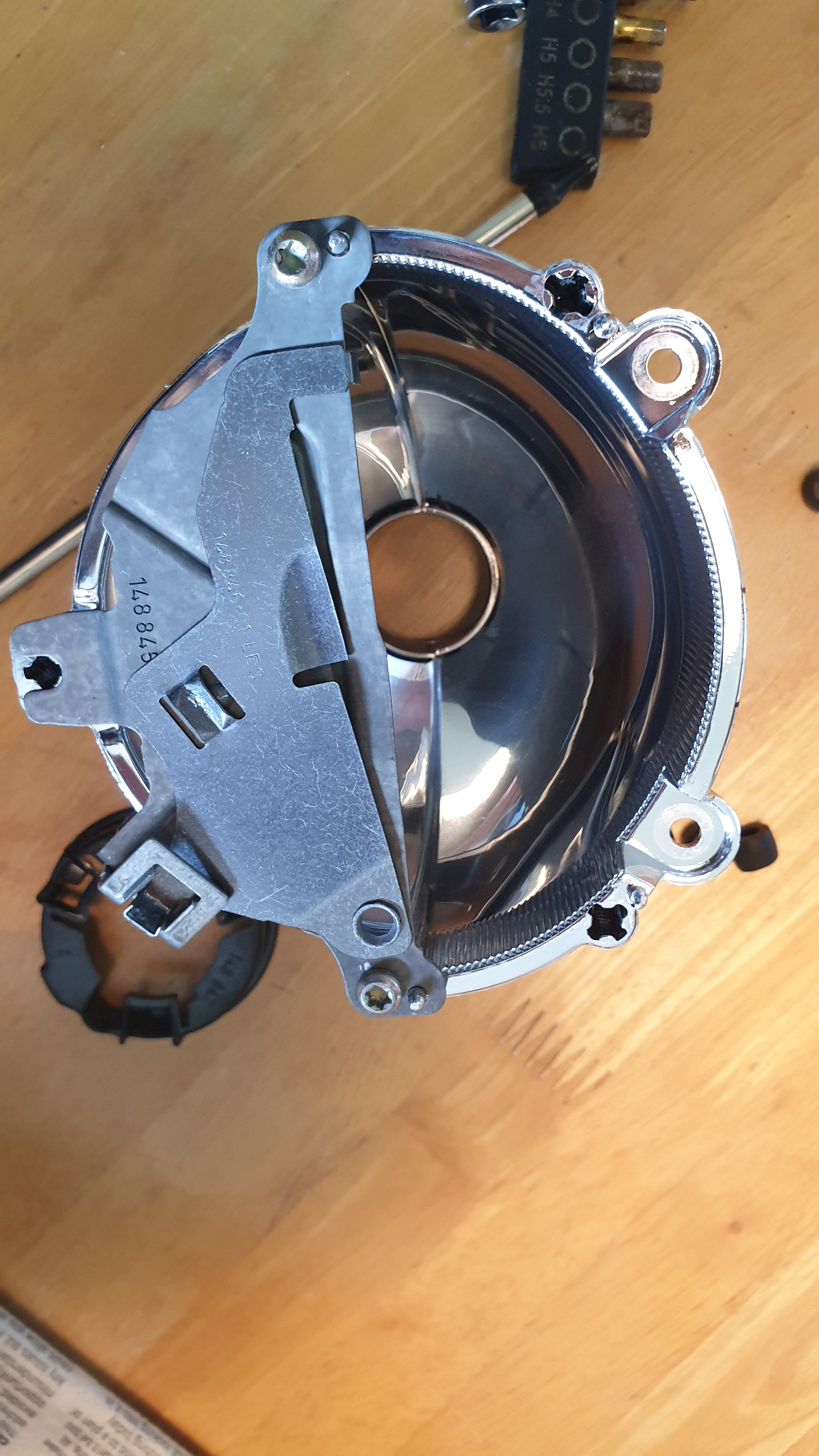

If they are anything like the OEM lights you might find an aluminium shield on the projector bowl as mentioned by J.R above.
Now, don't hold me to this, but simply swapping this around through 180 degrees might change the LHD to a RHD cut off.
This pic is from a genuine RHD OEM projector. Look closely & you'll see the stepped cut off towards to centre.
The holes line up to allow the plate to be flipped over.
Or, you may find they have a lever that you can flick to flatten the LHD "kick."
The lever is in the pic at the 8 o'clock. Moving it moves part of the aluminium plate to eliminate the stepped bit.
Hope that makes sense, but remember I'm NOT confirming either will definitely work to change to RHD.

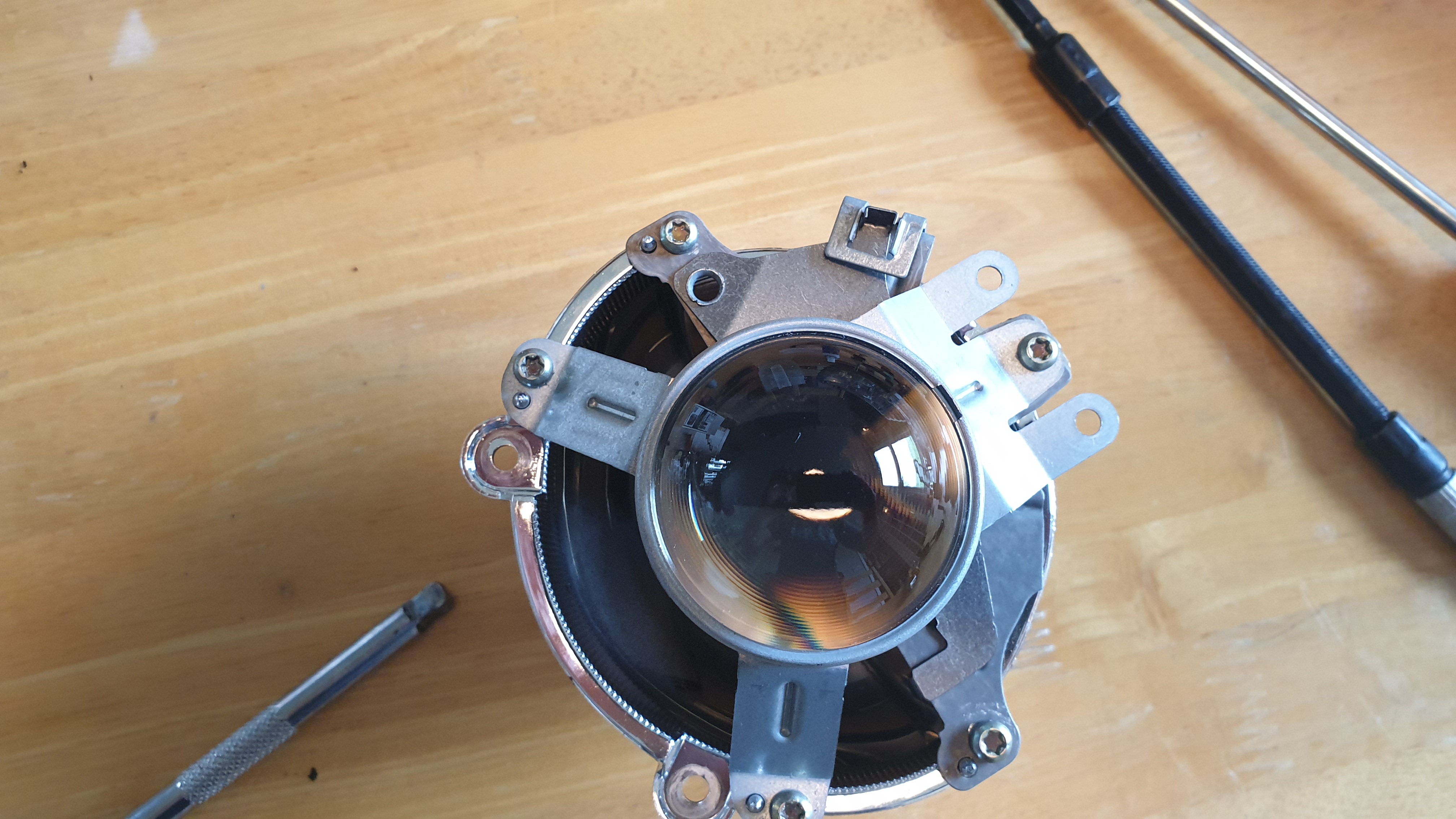

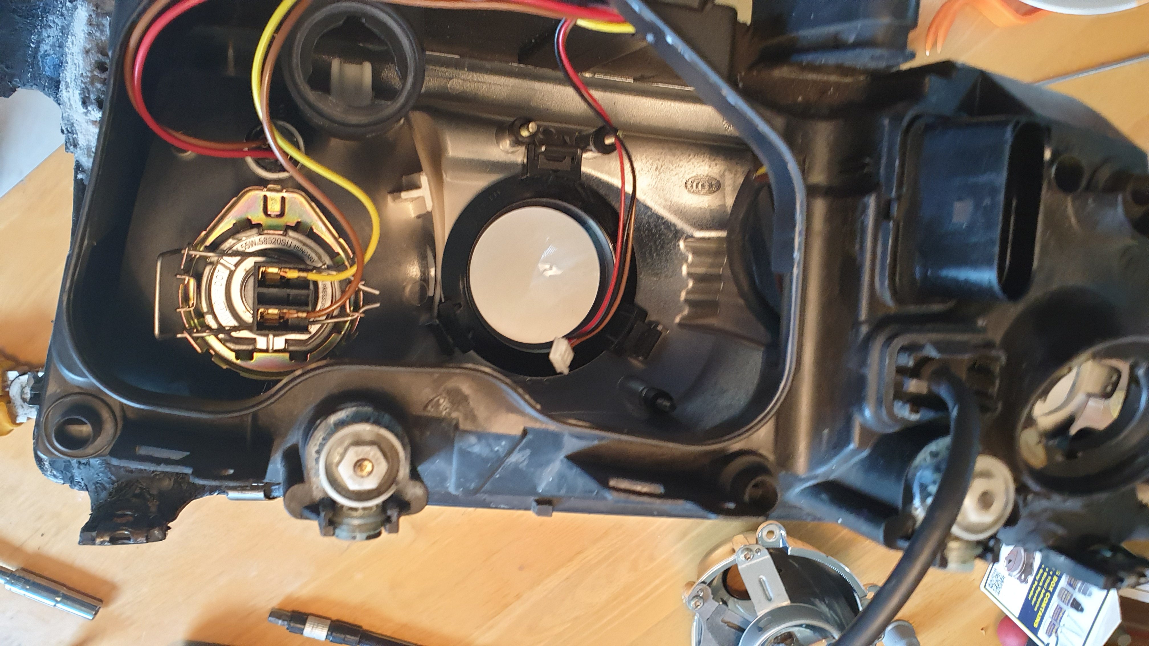

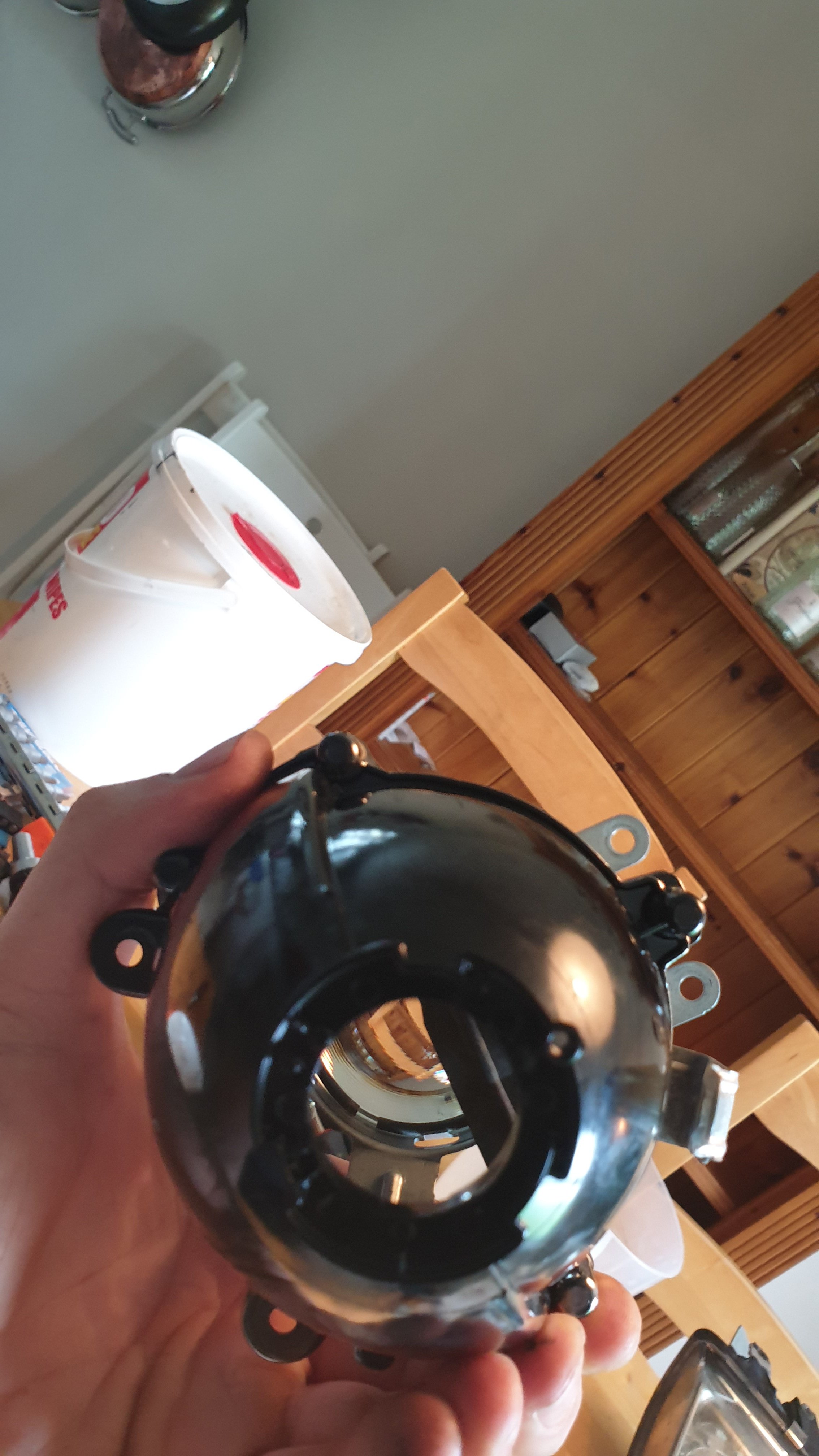

A few more photos which may help

The beam is flattened by moving the lever on the aluminium plate as mentioned in the earlier posts.
I suggested that by flipping the aluminium plate 180 degrees through it's centre axis, may change the kick to be the opposite way. I.e from RHD to LHD on UK Xenons & vice versa. (NB The lever that normally goes towards the rear of the haleadlight unit would then need to be bent back or removed as it would be pointing towards the lens. The holes of the plate align to allow this). The projector bowl itself would remain in it's normal orientation.
This is just a theory & may help the OP with his initial query about converting LHD projector units to RHD
